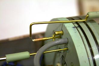

          At the back of the SD you should see two tubes coming out, one is intake and one is output. Which one? I did not know so I attached the pump to the battery and felt the ends (then mark your end cap so you can remember, I used In/Out).

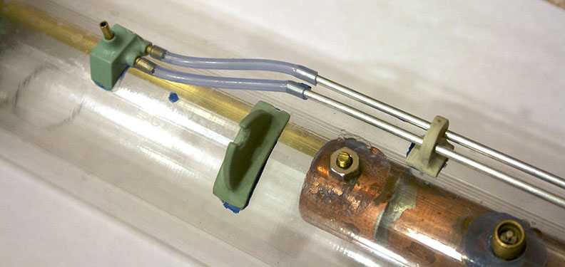

          In the kit is a blue rectangle like this (this is my Gato which uses SAS):

          There is a lot in the picture (I added aluminum tubes instead of long hoses), but I am looking specifically at the blueish/green rectangle with two connectors on one side and one on the top. Am I making sense so far? If not email me or post here. The top side with the one tube coming out, that goes to a high place in your sail. That high place will need to be out of the water to bring air in. So, getting an aluminum tube and putting that in for a periscope extended would put that air intake nice and high or hide it near the top of the sail (it is your creativity here). On the side of the rectangle were there are two tubes, one is the pass through to the tube going up. This is were you would attach the hose from the intake tube (marked IN) on the end cap. The other tube (not the pass through) on the rectangle has a 90 degree bend pointing down to your ballast tank. This tube is were you connect the hose from the output (Marked Out) of the end cap tube.

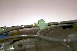

          It looks close to the Gato one, except you hook the pass through hose (single tube end on side) to a manifold over the battery. This manifold puts the air into the cylinder replenishing the air taken out while submerged.
