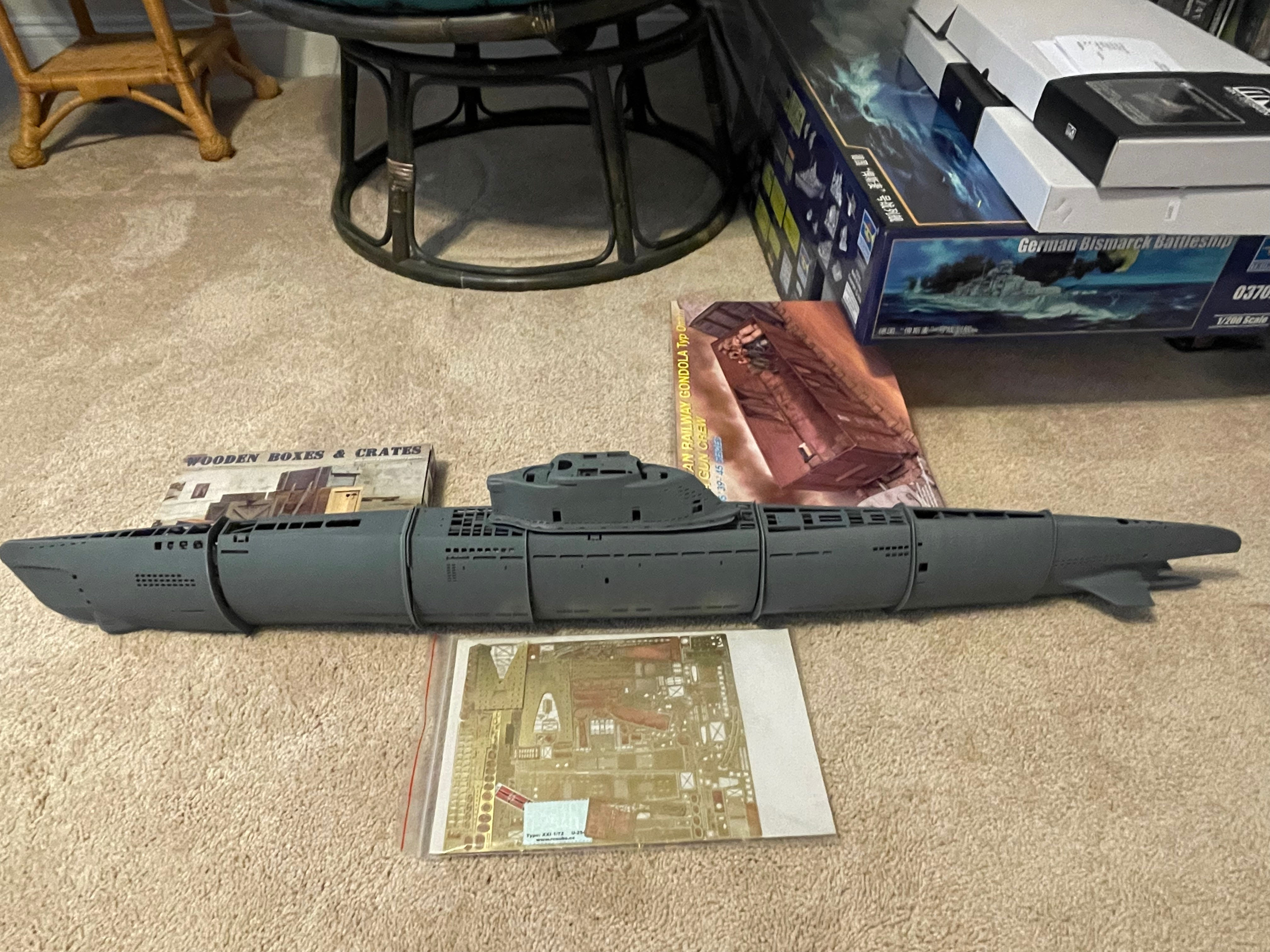

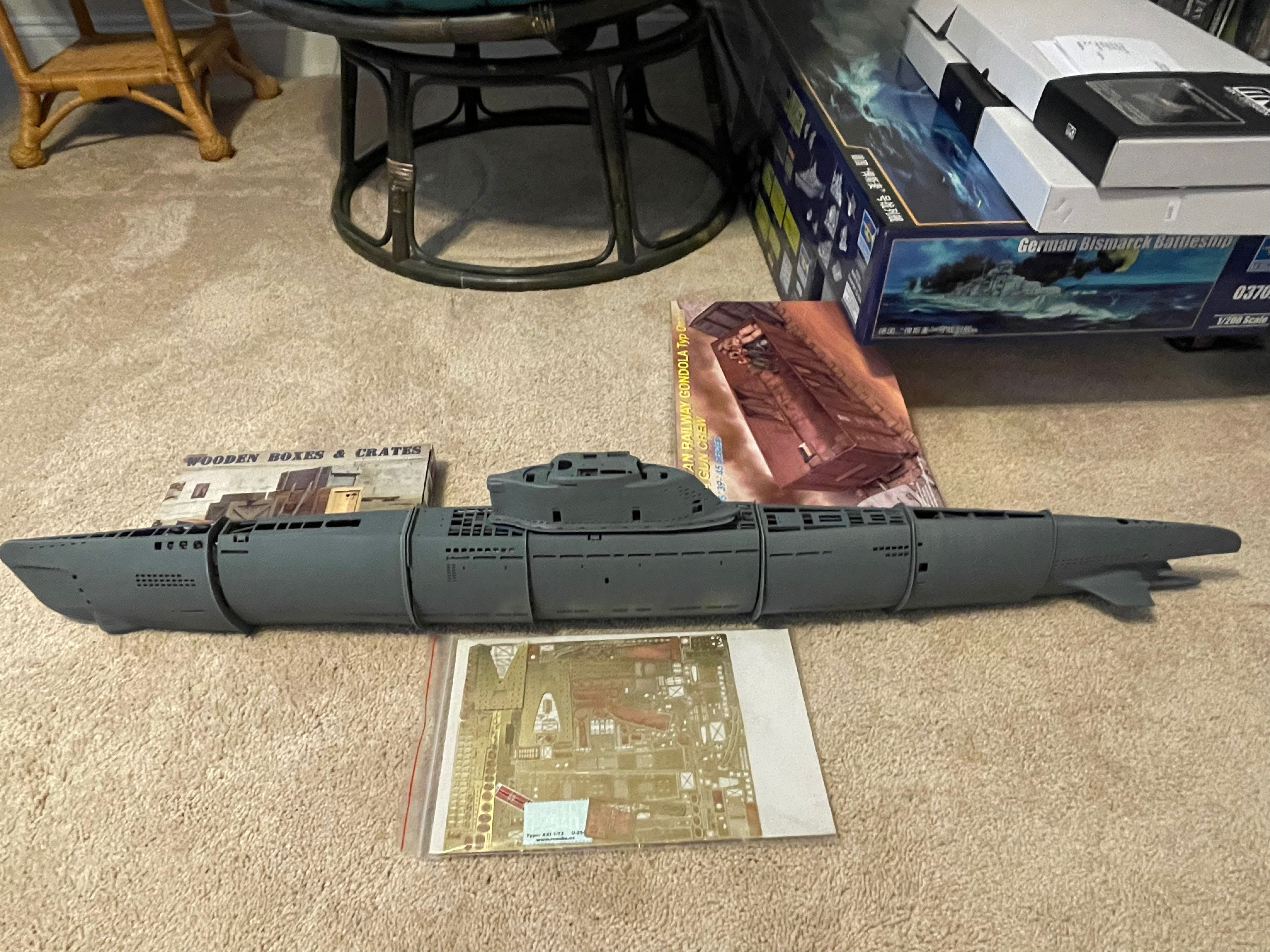

ID:	150334 here's the hull and tower just laid out.
