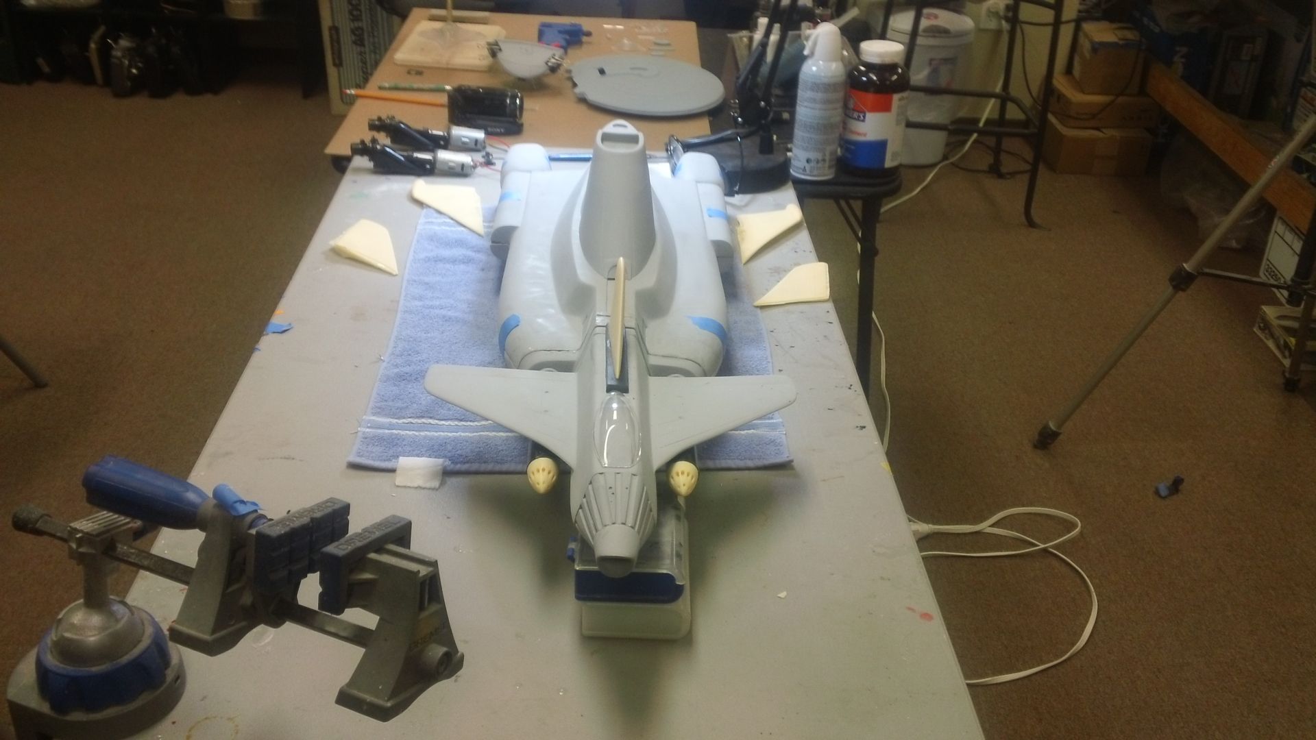

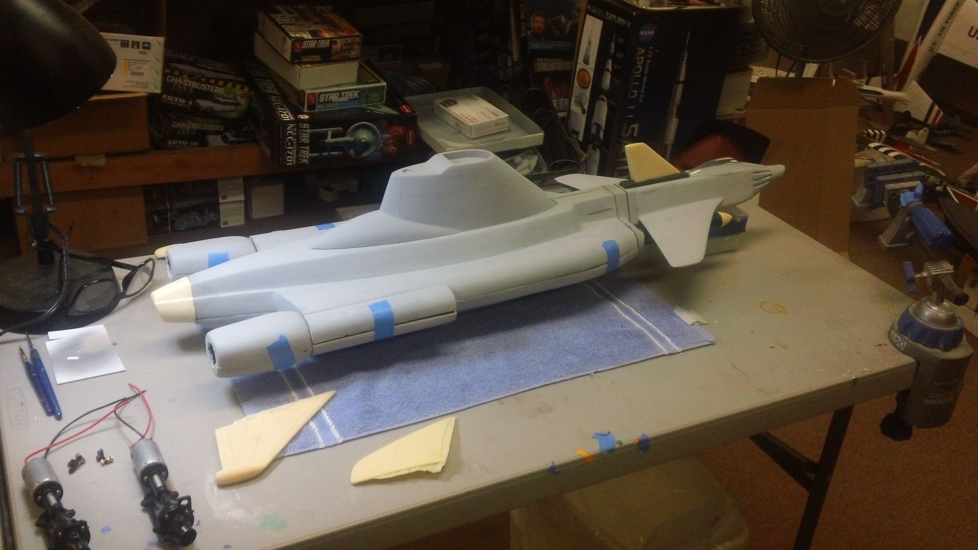

                        Got lots started on the Skydiver today along side the Enterprise D I'm also building. Video is uploading but I'm trying to take more pictures as I go for the SCR articles.
                        BD the space inside this hull isn't much. A 3 inch cylinder about 12 inches log will fit or longer if it's a 21/2 inch WTC. Bladders will be external one would think on the sides and two cylinders to seal in the PJ motors against the water. Those would need to be 21/2 inches long by 11/2. Endcaps and a prop shaft seal of course.
                        Maximum deep on the main hull is about 3 1/2 inches.
                        She's sating to some together.
                        Video later tonight.
                        Steve
                        PJs will fit the engine housings, just.
                        As you can see it just makes it on the output jet.
                        Well BD. What ya think? Doable??
                        Steve
                        www.steveneillsgarage.com
