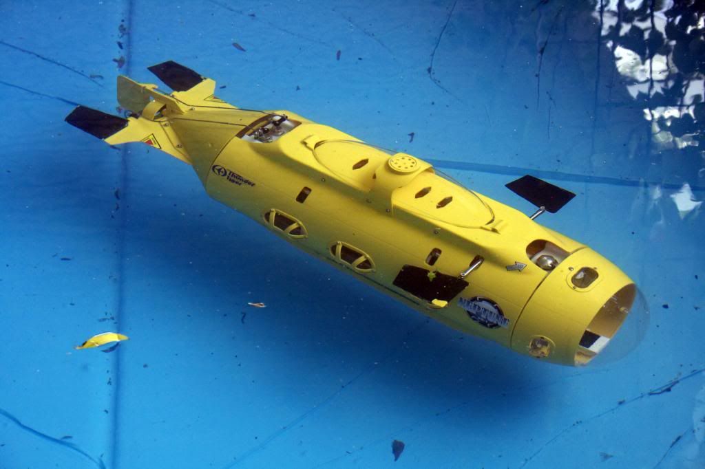

                    I recently fabricated some props for the yellow submarine, and used the highly technical process of TLAR (That Looks About Right) when deciding on their angle of attack.

                      The props look good Andy.

                            I love the planes, they look like frogman flippers.
                              #119
                              Re: Neptune mod, or late to the party.
                              Maybe I need several props to change out if the circumstance warrants it.......
                              Thank you for the complement, but all credit goes to Bob. He did the design work on those planes.
