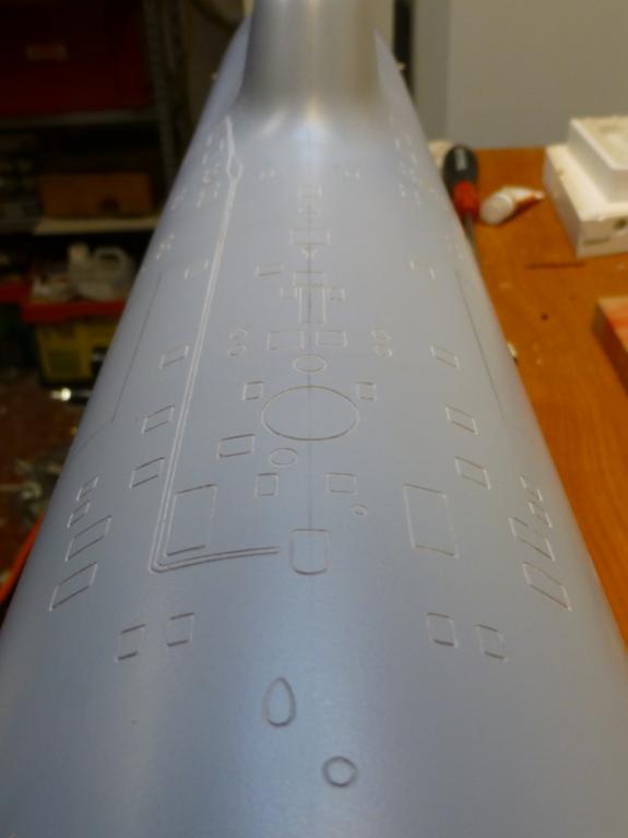

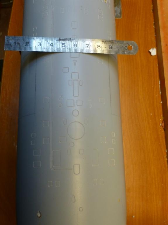

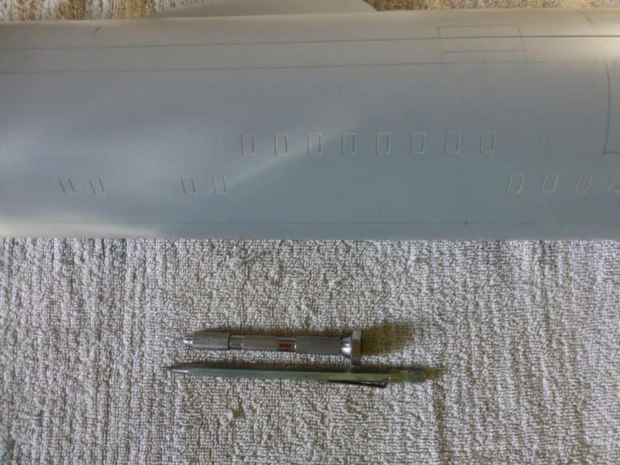

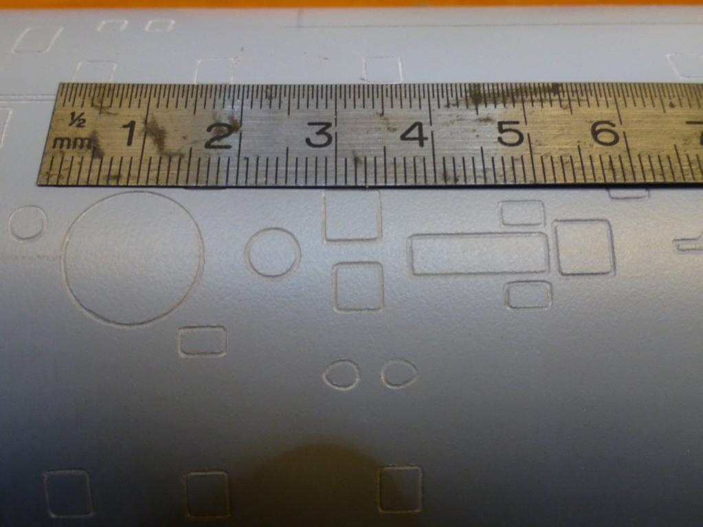

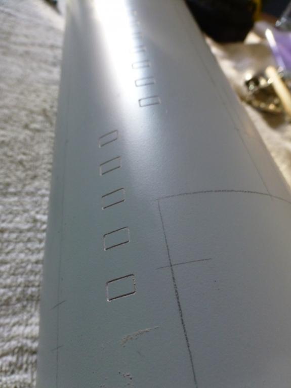

                #67
                Scribing, at last.
                Started with the bottom flood-drain holes.
                Nevertheless I have to open them up afterwards I scribe them first for practice purpose.
                All went well, and I’m pleased with the result, pictures showing scribed lines without cleaning or touchup.
Name:	Akula (474).jpg
Name:	Akula (473).jpg
                More progress the Fwd deck
Name:	Akula (485).jpg
Name:	Akula (484).jpg
Name:	Akula (475).jpg
Name:	Akula (480).jpg
                Grtz,
                Bart
                "Samuel Smiles"

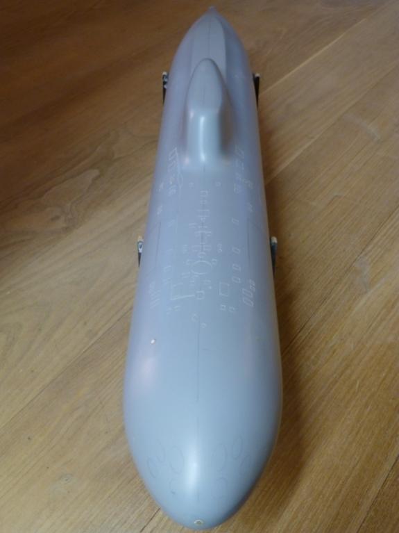

                      #70
                      She is coming to completion. Still some minor touch ups to do.
                      Grtz,
                      Bart
                      "Samuel Smiles"
