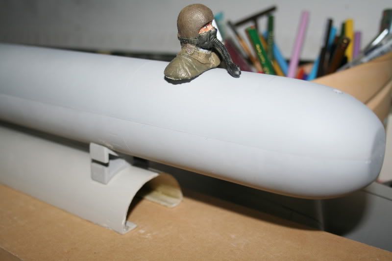

      Rigged up the prop shaft and bonded the upper cut hull. Hull cradles will be put in next and then the cuts to make the driver compartment. The entire upper torpedo needs to be extended so I will probably turn an entirely new front from Rennshape.

        Re: 1:9th scale marder midget "surface runner"
        Plan on using the rear prop only so I build a spacer to replace the forward one. Starting to fair it all in. Also, got all cradles, hatch pins and blind nuts installed. Time to break out the Bondo and sandpaper.

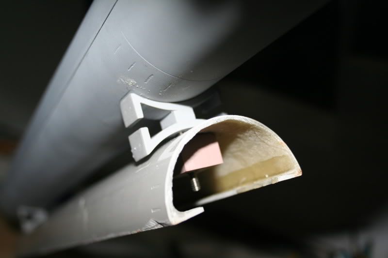

          Molded up a set of brackets to hold the two models together. Still needs the metal side plates with bolts to make it strong.
          Blind nuts in the weapon torpedo allow it to be removed for service.

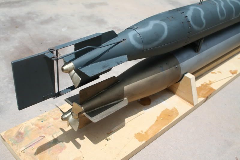

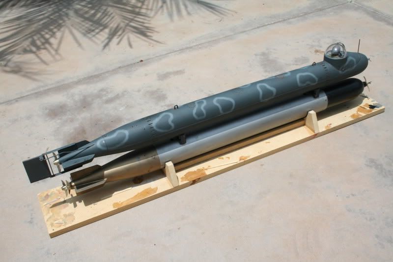

            Finally found some time to finish this thing up. All I really need to do is paint, trim and detail it out.
            Plan to do the torpedo in silver / brass and the sub in a dark gray with the possibility of a "non scale" splinter pattern on the topsides.....
              Camo similar to this Hecht......

                Final details and paint are done. Just needs a surface trim to be complete. Photos at the lake will be next....
                  Did a trim test and had the same problem as my Delfin. TAIL HEAVYYYYYYYYYYY. Starting to cram the foam into all possible corners. I hate doing this as the internals look less clean but it is necessary in this case.
                    Look great Darrin.
                    Were the welds done with thick cyano? Did you paint the camoflage shapes freehand or cut a stencil?
                    • dhffr
                      • Mar 2004
                      • 211
                      Thanks Andy,
                      Used a gel superglue for the welds and all paintwork is done by hand. I usually have to go back with the base color to adjust the pattern till it's right...
