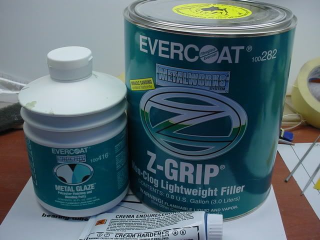

        I'm not really sure how to proceed next. Should I sand and then fill the weave with body filler, and then apply the lightweight glass and fill the weave on that too,
        or
        Should I sand and just apply the lightweight glass now, then there will be less weave to fill after that?
        Any suggestions?

          Scotch bright pad to rough
          Scotch bright pad to rough up your glass skin, and clean the surface, then prime the poop out of it!
          The old Lacquer Dupont 131 (FILL & SAND) works great, or get a Urathane primer with a Hardner in it, for a rock solid assured speedy cure!
          Either will allow you to Skip the Plastic coat, except for pinholes, and some weave you will miss, Trust me on this one Pete!
          So much more easier to sand this way, and hey when your done sanding it is allready primed! Then a smooth coat or two of finish primer.
          They do make a product that is refered to as Spray On Primer for Body Work, this has a Tube of catalyst for the hardner, it is polyester based and works well, heck you can get a quarter inch thickness & more when applyed in stages!
          But I save time duing it this way (priming), a Plastic skim coat is very hard to maintain an even thickness!!
          (Plastic) = Bondo/Glaze
          Brian

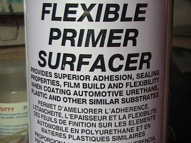

            Thanks Brian. Almost anything to
            Thanks Brian. Almost anything to save time.
            What do you think of the Dupli-color brand filler auto primer? Any good?
            I'm planning on using the chart tape method of adding detail lines. You know, apply tape, coat with filling primer to build the level, then peel away the tape to reveal the recessed details.
            If I use the filling primer to fill the glass weave, should I put a final coat of finish primer on top once I get the surface where I want it? Then apply the tape and filler primer again to create the details?
            What I'm concerned about is having a surface hard enough, or sealed enough, to make sure the chart tape doesn't pull up any of the under surface, making the detail lines uneven in depth, or worse, pulling big chunks up.
            Pete

              I never herd of that
              I never herd of that Bondo Pete, and they are all different to one real point and that is how the sand, next to that they are all just fillers. Me I like and been using this stuff for about a decade for Auto Body Repair and Model making, it ain’t never let me down!
              For priming, and you want it Hard, this is the stuff I use for a base coat/sealer for my work at the shop, and for model plugs, I have found it to be God send! The Hardener insures it stays put!!!
              There are many brands to choose from for this primer, the 2K is the term in the field round here, but find a body shop and asks them or a supplier to that body shop and they should be able to hook you up! I get Flyers all the time from witch anybody can mail order the stuff, next one I get I will put up a 1 800 # so you can get on the mailing list.
              I have used Tape to add detail to my models before, I secured it with CA, it stays put then! For recessed panel lines I scribe and that works for me, this 2K primer you will find makes a good substrate to scribe in, and so does the 131primer ask Merriman, but we all do things different and I plan to try your way if it yields a crisp line in the work, it may be faster for me too!
              And I got say Very Nice Work Pete, damn glad you took this on!
