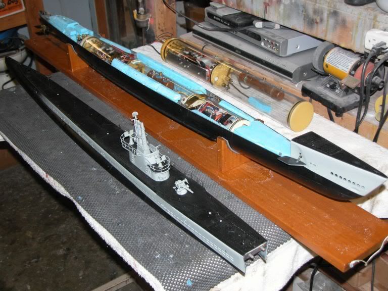

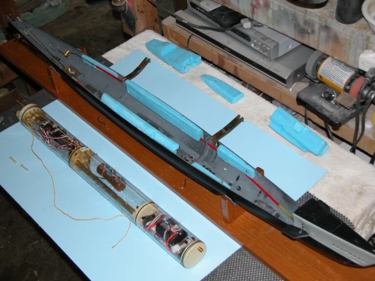

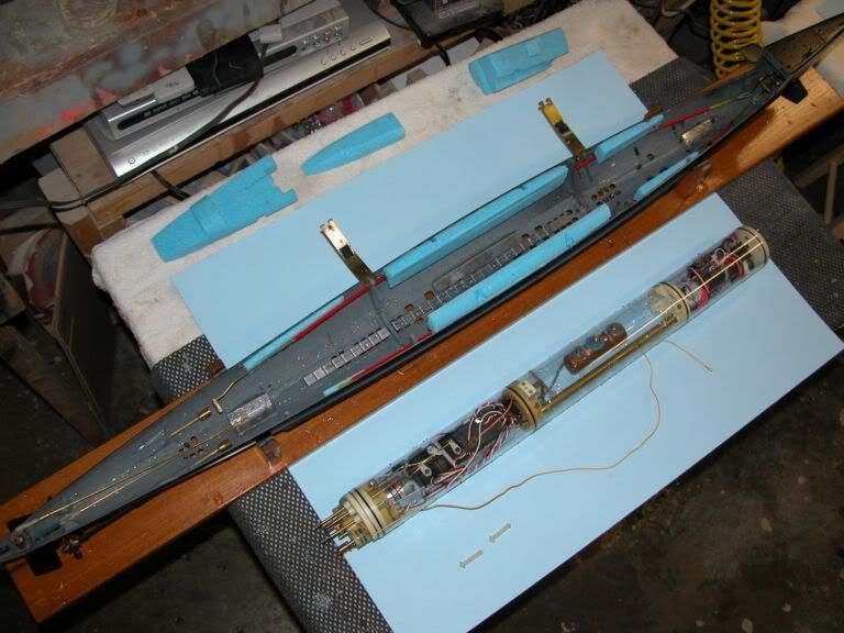

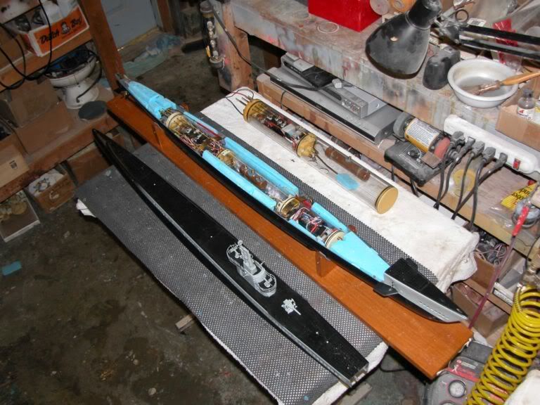

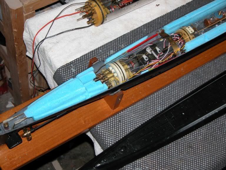

            Been there, done that, got the T-shirt]http://i94.photobucket.com/albums/l114/U-812/ygpA26D.jpg[/img]
            The Scale Shipyard 1/72 GATO model outfitted with our WTC-2.5/GATO. If I can trim out this heavy GRP hull to work with this unit then it will be a cake walk to trim out the much lighter in weight (and thinner walled), soon to appear, Revell kit scale.
            The model was built and owned by Karl Poschner. I was hired to integrate the new WTC into his model and to get things operational. The original WTC-3 mod 2 just did not provide enough annular space within the hull to permit proper trimming of the heavy fiberglass hull.
            The WTC-2.5/GATO has enough reserve buoyancy to get even the heavy Scale Shipyards hull height enough into the air to give it a scale like surface trim waterline.
            Karl's 1/72 GATO opened up revealing the WTC-2.5/GATO. Above the model is the WTC-3 mod 2 initially installed. Gobs of room in there with the smaller cylinder!
            The Revell kit will require only a small fraction of the displacing foam you see here installed to counter the weight of the lead needed to raise the metacentric height of the heavy Scale Shipyard hull.
            Plenty of room within the WTC-2.5/GATO to mount servos and other gadgets -- you don't have to be a brain surgeon to outfit this moderately sized WTC (sorry, Adam).
            I invented the WTC concept (as practiced in America) nearly two decades ago. The WTC-2.5/GATO is simply a development of my ongoing work to produce WTC's suited for specific model submarine kits.
            The WTC-2.5/GATO uses a single Graupner 400 motor linked to a gear-splitter unit to provide the needed two counter-rotating shaft outputs. WTC installation/removal takes about thirty-seconds! Battery change takes about the same amount of time. Endurance with a 1800mAh battery is over an hour! The tank has more than enough floodable volume to get the model up to designed waterline.
