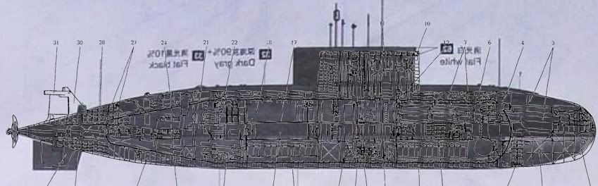

This is a lineart of the Lada on the Trumpeter Kilo (from Trumpeter's instrucctions)
The fit is not perfect but you can figure out how to do it (or not do it!)
Thanks Gerwalk. From your photo overlays it shows that other than the Lada's much lower deck, and smaller sail compared to the Kilo, their hull outlines are generally the same. I could probably live with the deck height discrepancy. It would just be a matter of making the sail smaller, transferring the bow planes to the sail and fabricating a smaller upper and lower rudder.
