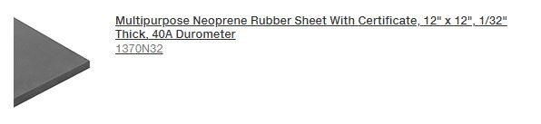

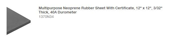

      I have used the following from MMC with success.
      Although I changed to using rubberized cork with a little bit of sealant which I like better.
      Both are available from sendcutsend and can be cut to complex shapes with holes for fasteners etc. ... although a little expensive unless you are having multiple made.
