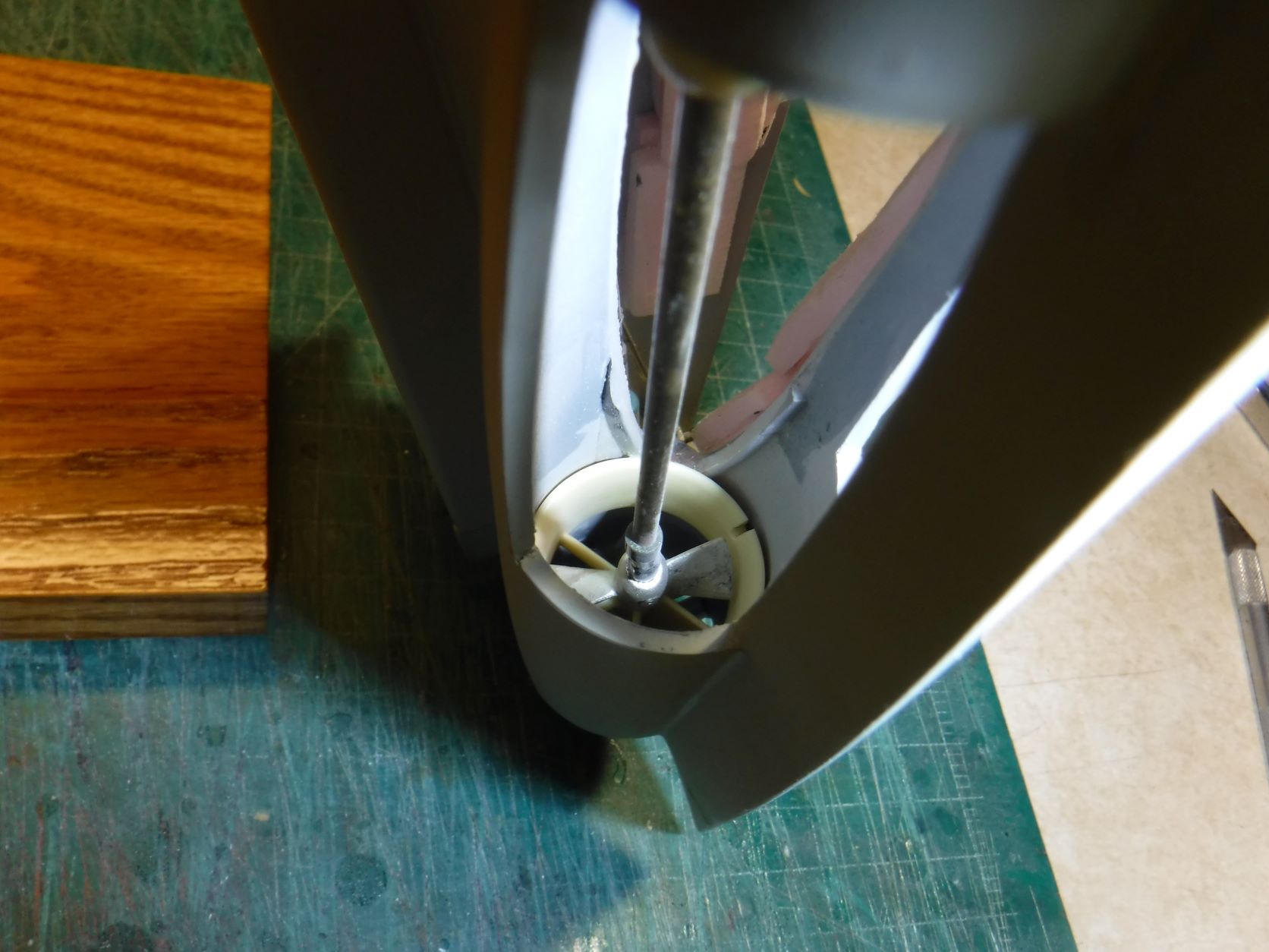

      I used one of the Merriman conversion kits and cylinder. I may have the Merriman conversion CD's in my shop, I'll check for them after the sun comes up. Merriman's conversion kit used two stator units that are a friction fit in the nacelles. I broke one of the Merriam dog bone ends for the stator and haven't made a repair. Merriman linked the bow planes and stern planes with long pushrods for pitch control. The sail planes are on a separate servo to control depth.

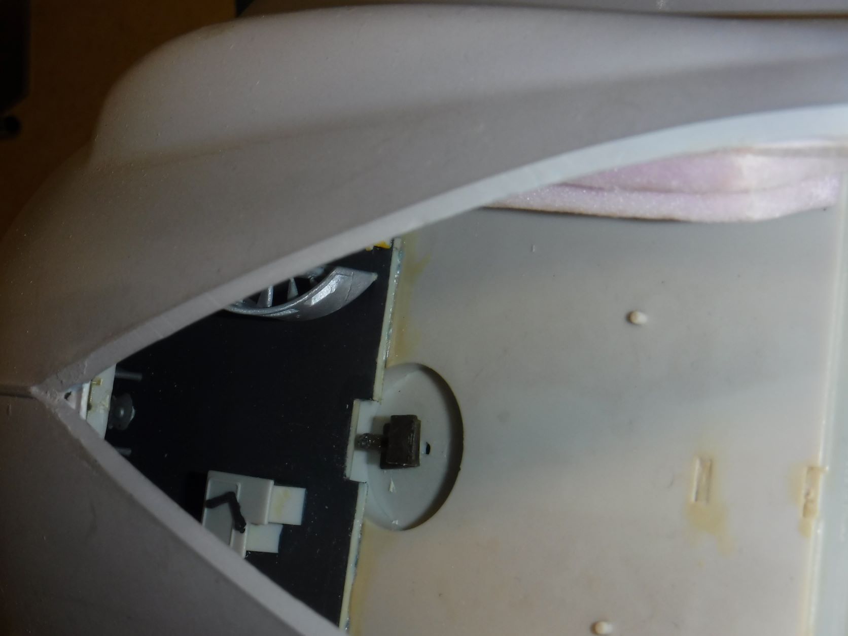

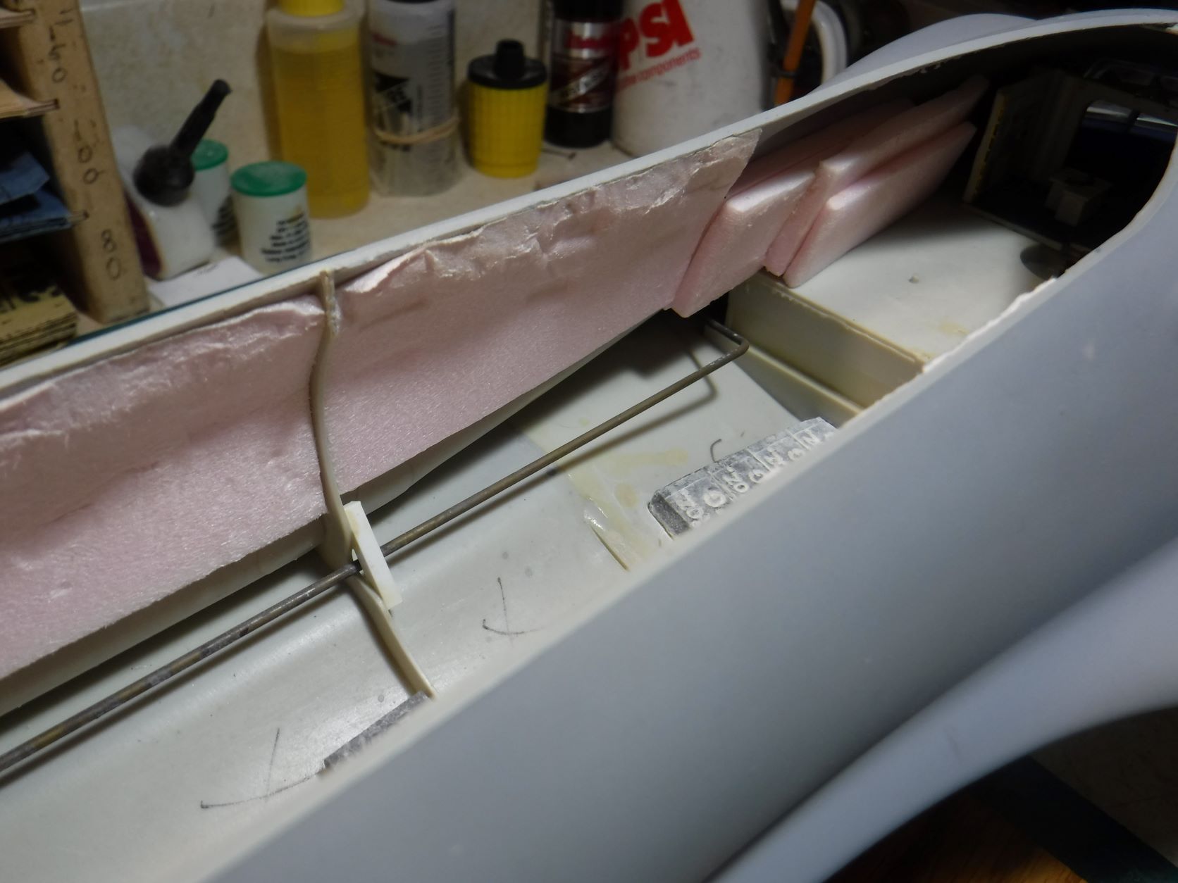

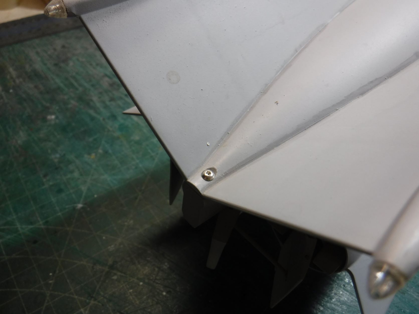

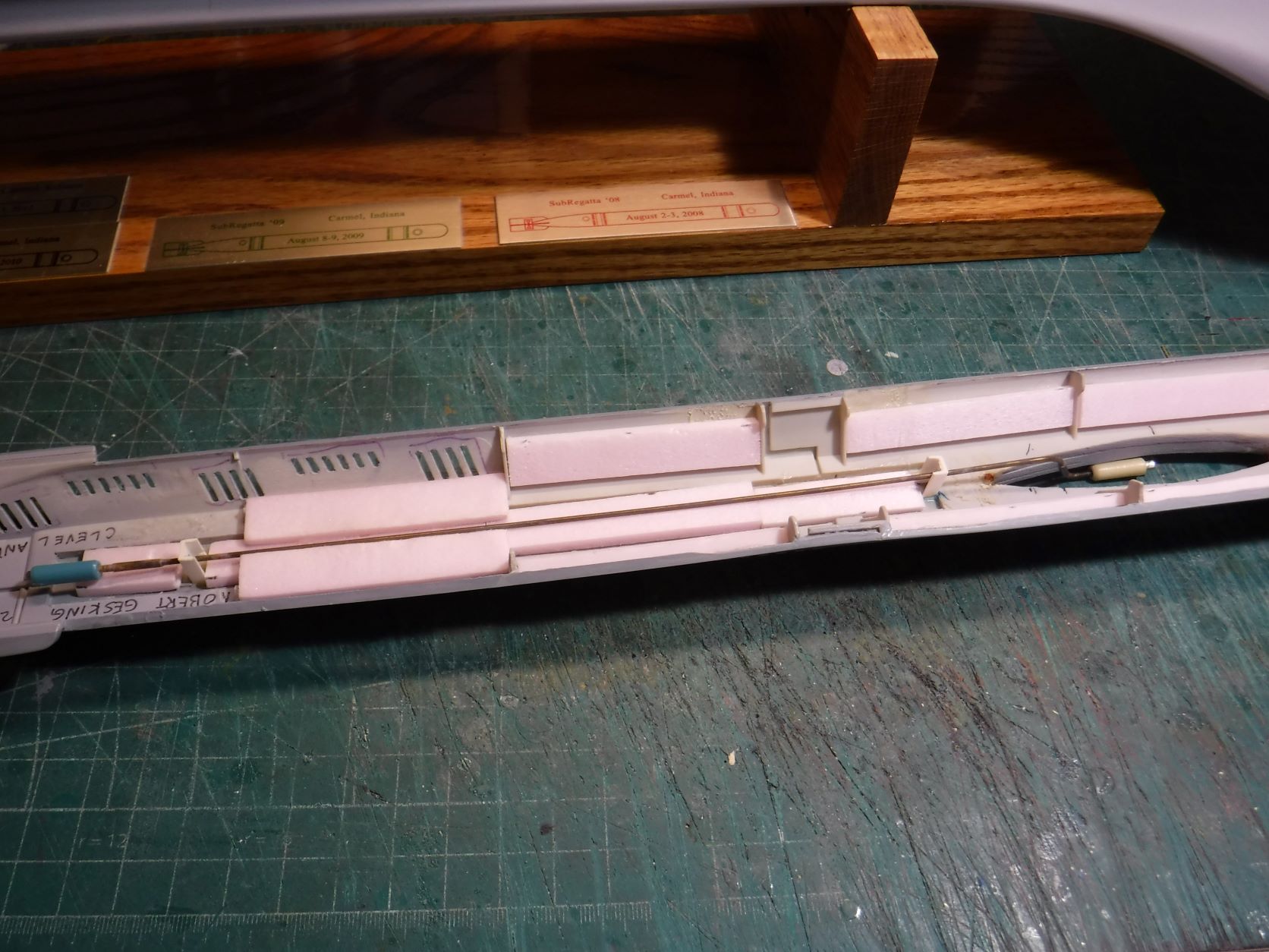

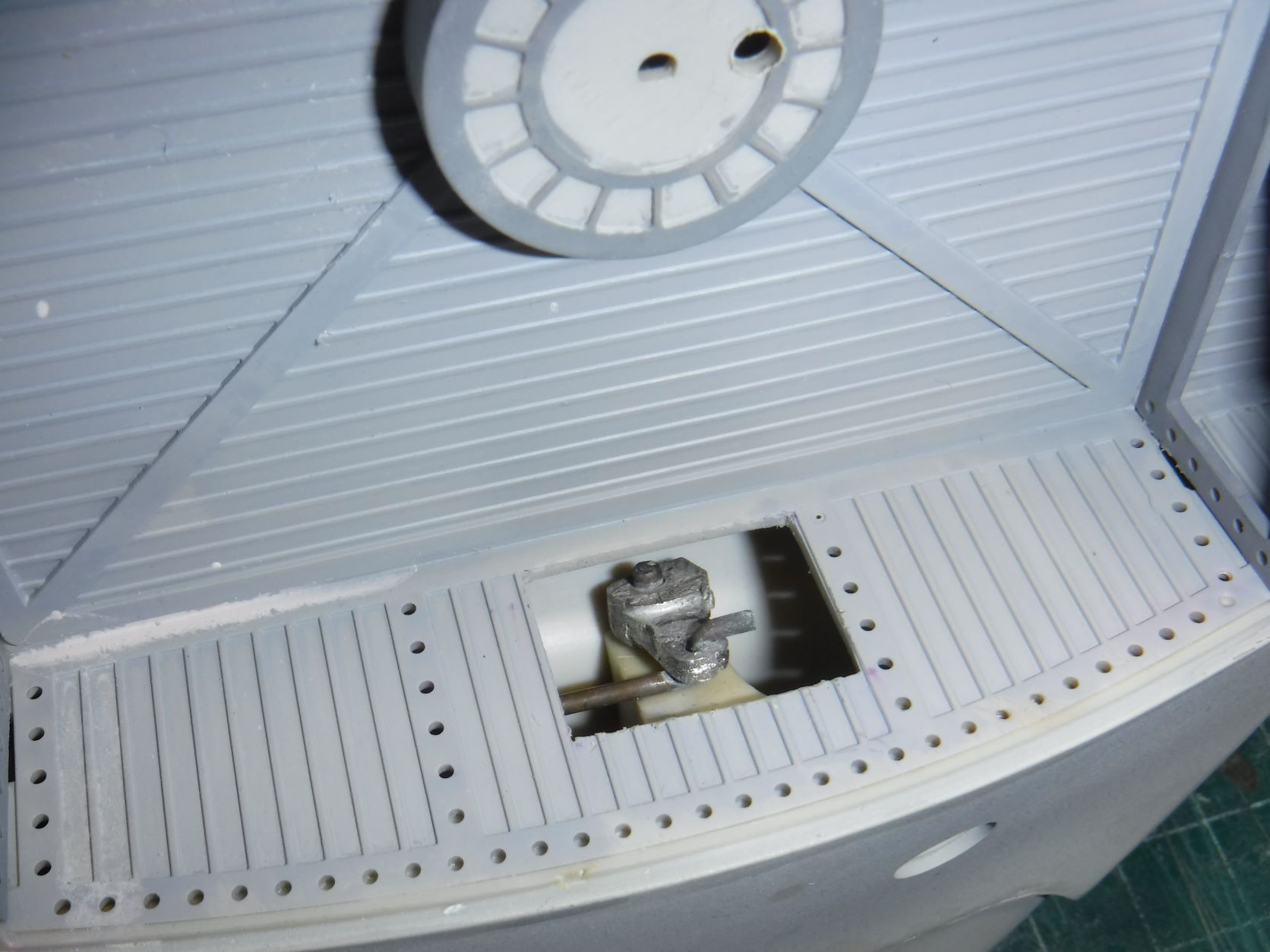

          I found the SEAVIEW CD's. I use a 2-56 x1/4" stainless steel screw to hold the stern deck down. The forward hook was one of the Merriman conversion kit pieces. The sail planes have a magnetic control arm. The sail planes pushrod runs under the missile deck. The bow plane pushrods run under the observation deck.

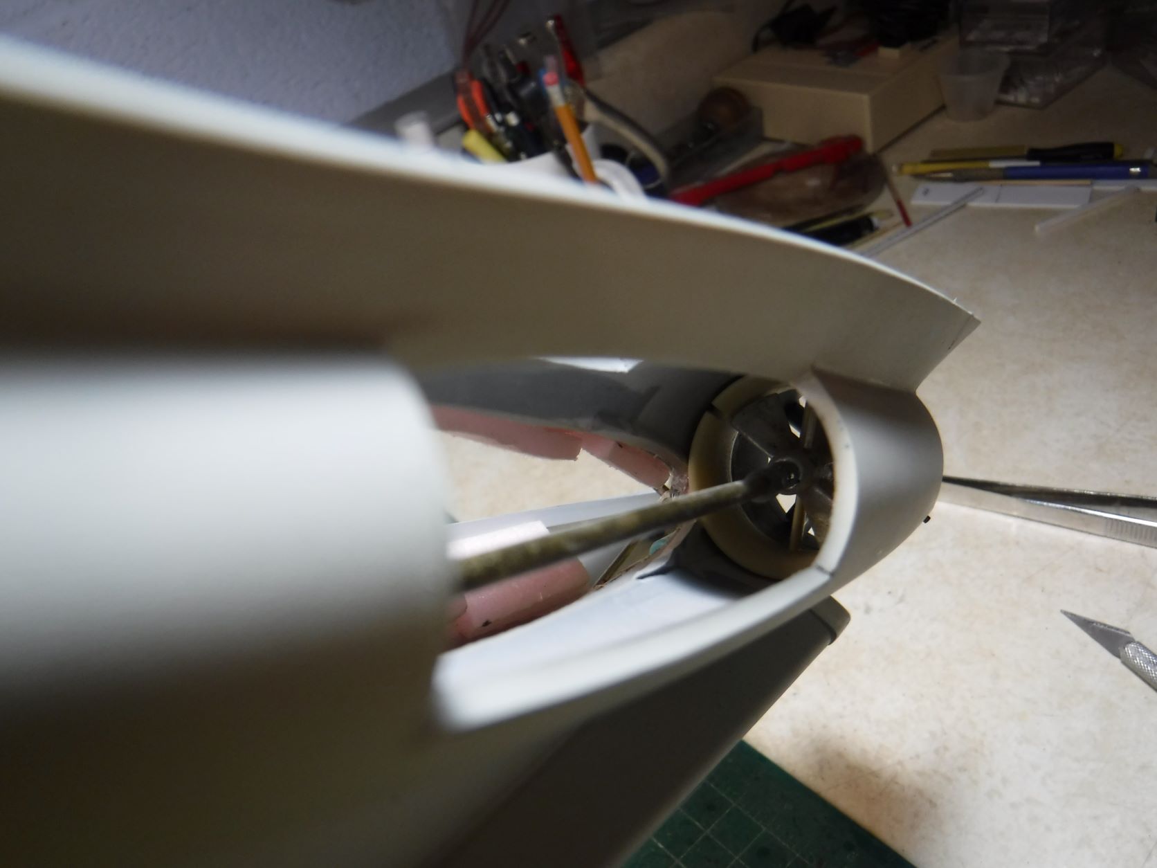

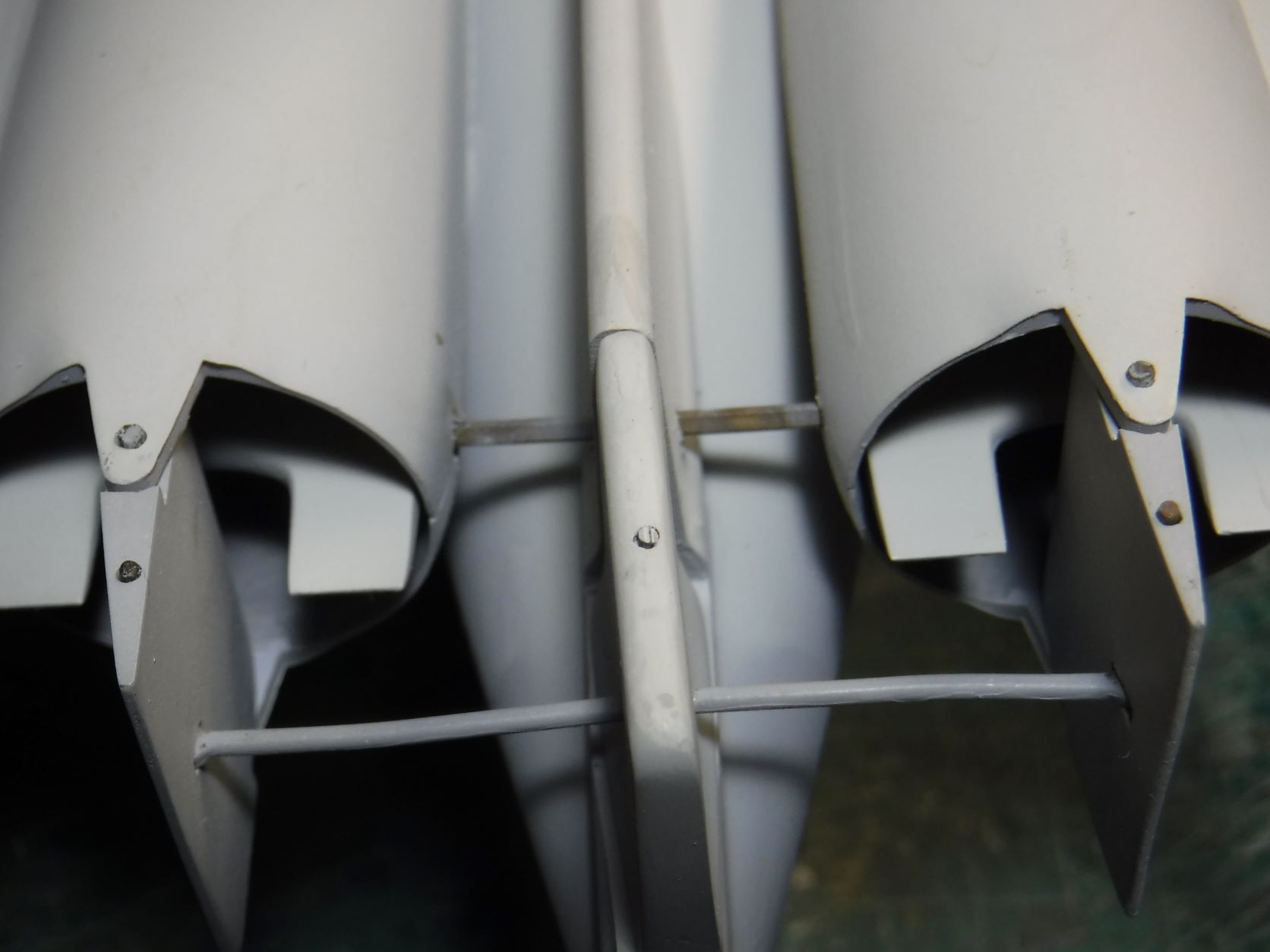

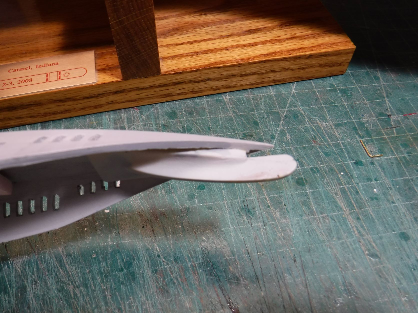

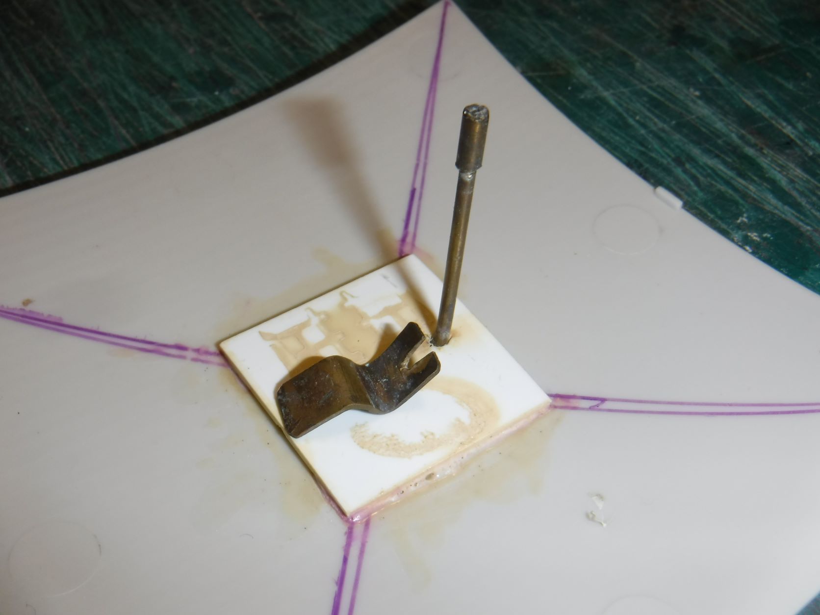

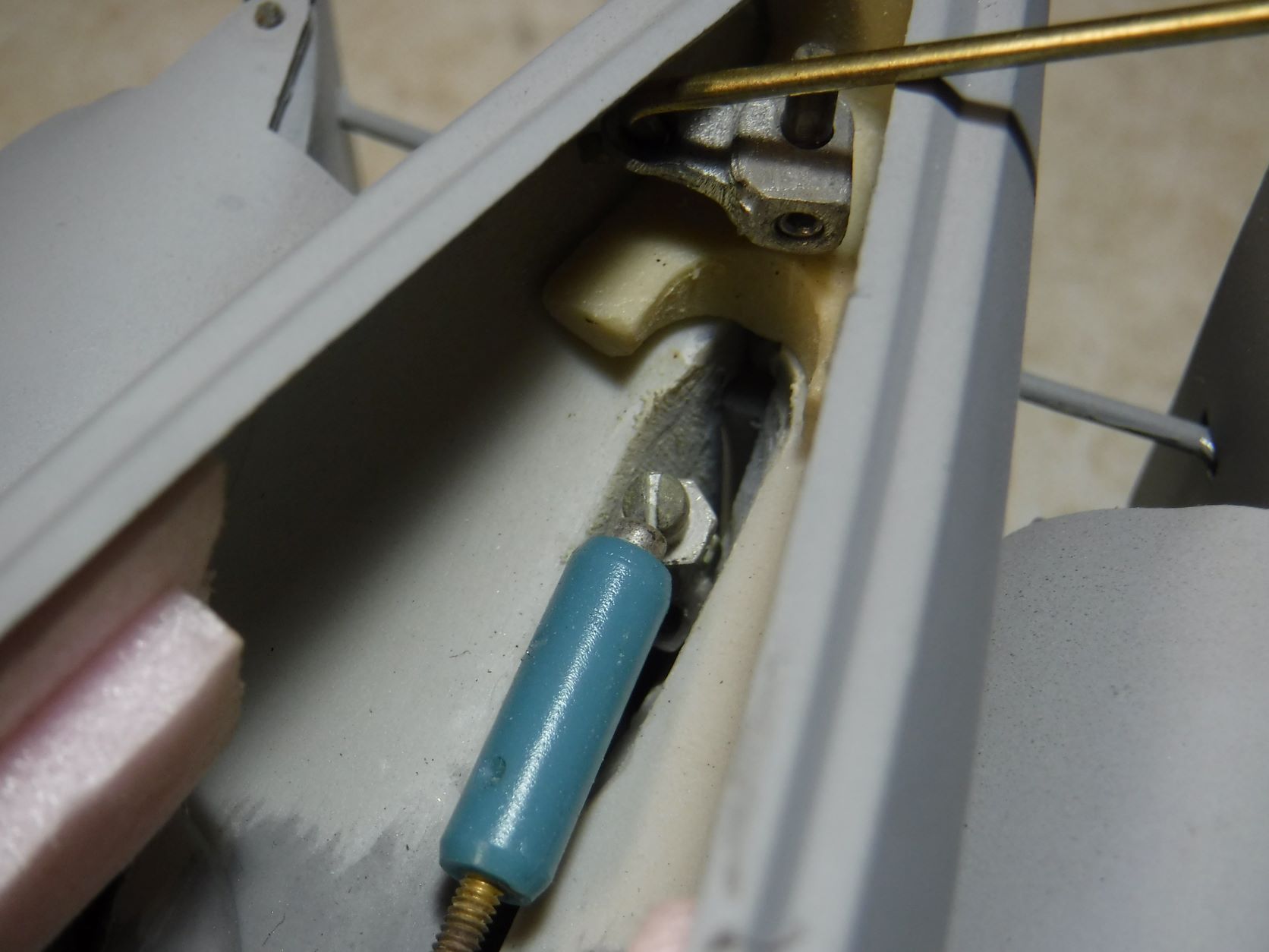

            Some more photos. A piece of notched brass holds the FLYING SUB bottom door on. The bow plane arms are accessed from the open bay. A brass rod is glued to the FLYING SUB bay door to hold it in place. The stern planes are linked to the bow planes. The rudder arm is connected to the center rudder; and a tie rod connects all three rudders.

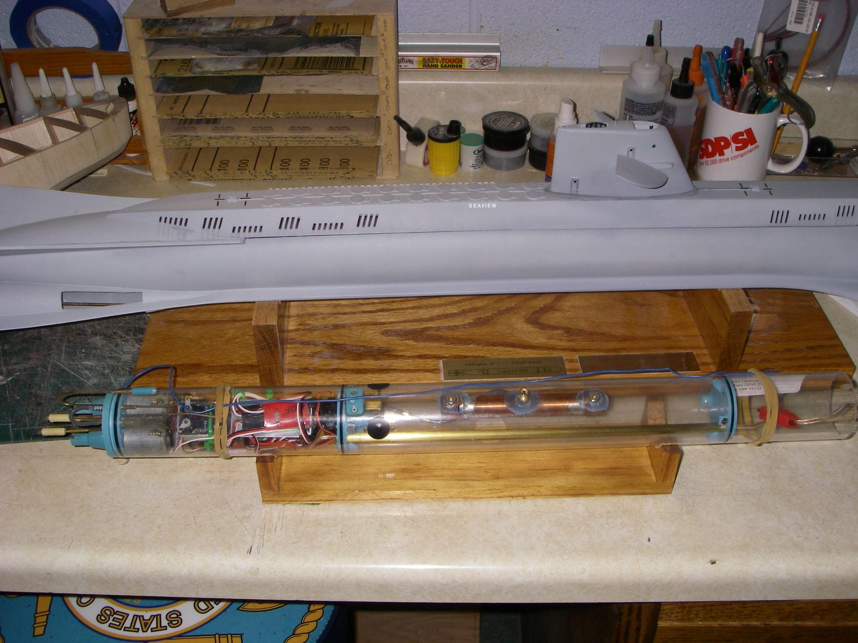

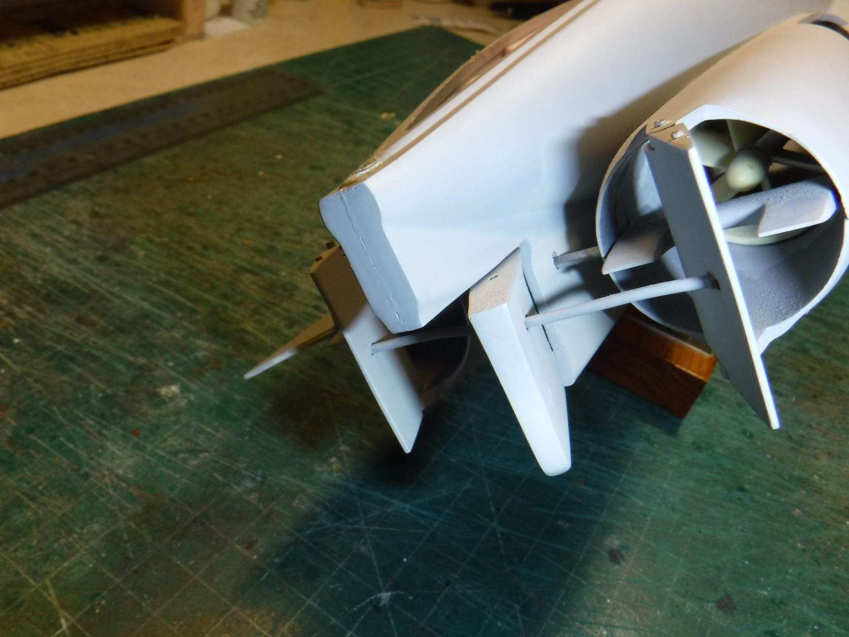

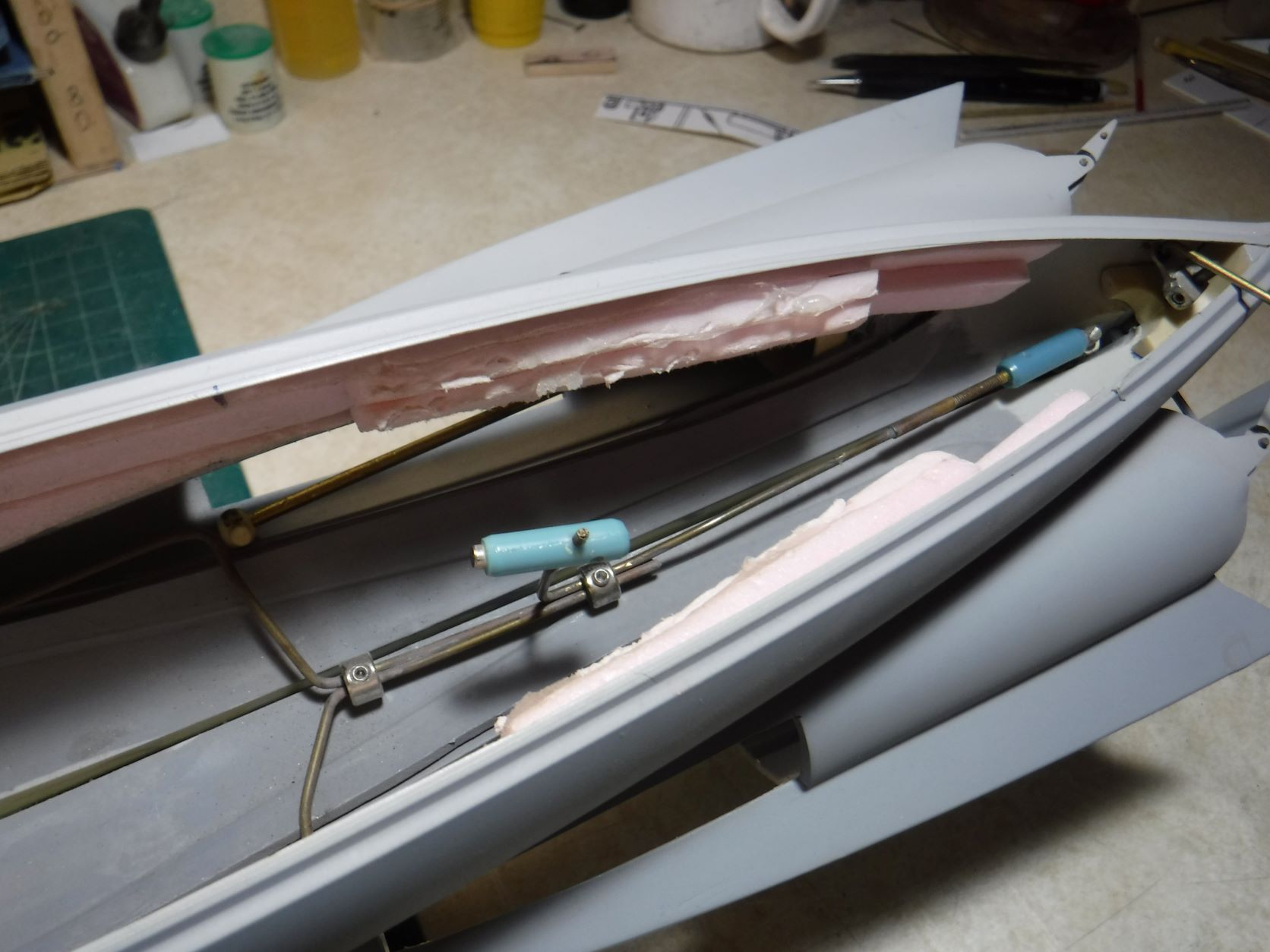

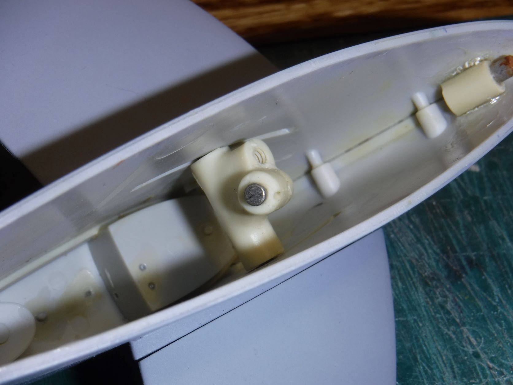

              Here's the last couple of photos. The stern planes are connected with a piece of square brass tubing. The two blade props are fitted into cast resin stators. The hull is split along the lower edge of the missile deck; it springs open to slip the WTC into place.
