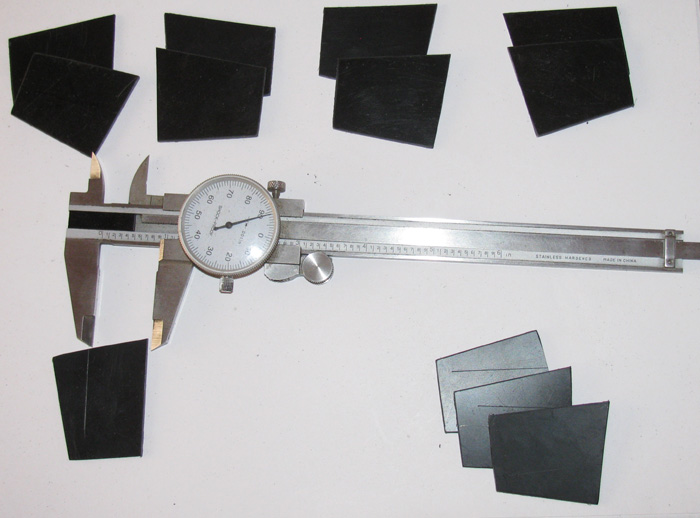

    When I make parts, I start with pieces of 1/16" sheet cut from a large piece. (it was 4'x8' when I started on it several years ago)

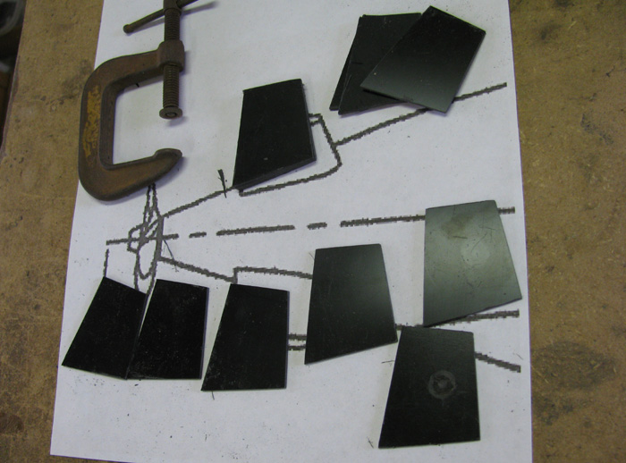

    Okay let's say were need rear planes.
    I would take the original and lay it on the plastic sheet and draw a pattern making it a little large than the finish part.
    How thick in next?
    This tells me how many layers of plastic I need.
    I cut from the big plastic sheet the number I need to make the part.
    Twice as many if I am making 2 parts.
    All this cutting of the plastic is done with scissors.

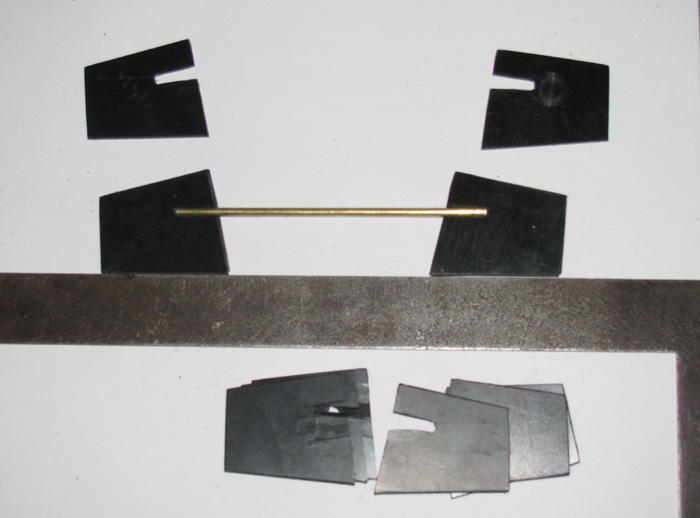

    You need a shaft in the control surface.
    Using one piece of the cut plastic, draw the shape on to it that you will shape to finish size.
    Locate where the shaft will be and mark it on the plastic.
    I would now cut a couple of pieces in shaft on the shaft line.
    I would build up on both sides of the shaft until I had a groove to accept the shaft.
    A little smaller is okay because I can drill it out using the groove as a guide.
    Once you have your shaft in place, you can cover it with full plastic pieces.
    Make sure that you have even numbers of pieces on both sides of shaft.
    Apply bonding cement to all parts and clamp in vise to compress the pieces.
    Makes for a very good bond.
    Let sit over night.

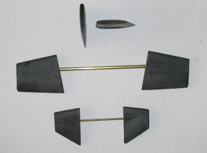

    After curing, it takes me a few minutes to shape the plastic part.
    I start by shaping the over all shape.
    Then I start shaping he air foil to and bottom.
    I use Dremel sanding drum, small files and sand paper to finish the surfaces.
    The time I think it would take to make molds I can build up and shape rudders, rear planes and sail planes/bow planes.
    They are solid and strong.
