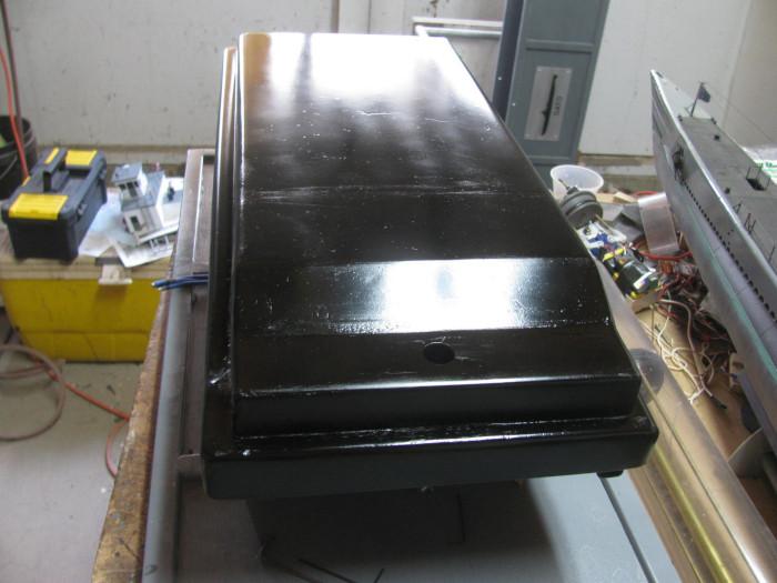

      Sanding of the second coat of glaze is done.
      I have 3 little spots to glaze and sand.
      Glazing done.
      I will let cure abut an hour and then sand again.
      Maybe a first tack coat of black hull paint today.
      As always, after sanding and wiping clean, there are more small spots to glaze.
      Sanded some more and see the small spots are gone.
      Cleaned off the hull.
      Washed the hull with wet rag.
      I got the tack coat of black paint on the hull.
      The brown on the right side of hull is a reflection of the bench top.
      I went out to the shop and looked.
      Tomorrow, I should be able to get 2 more finish coats of black on the hull.

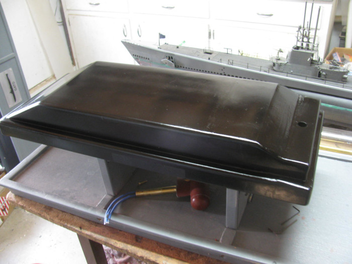

        Light sanding and a coat of black.
        Light sanding an hour later and another coat of black.
        Will look at it later today and see if I need to do more sanding.
        If not, then I can reinstall the rudder/pod.
        Put the deck on and I will be finished.
        Yea, we will see.

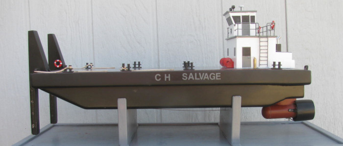

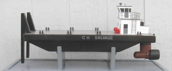

          This is the before photo.
          And this is the after photo.

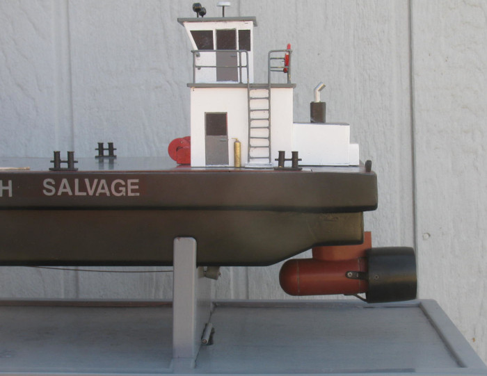

          A full inch plus removed from the rudder above the pod.
          The stern addition sides are 1" high.
          This modification is COMPLETE. . . . .
