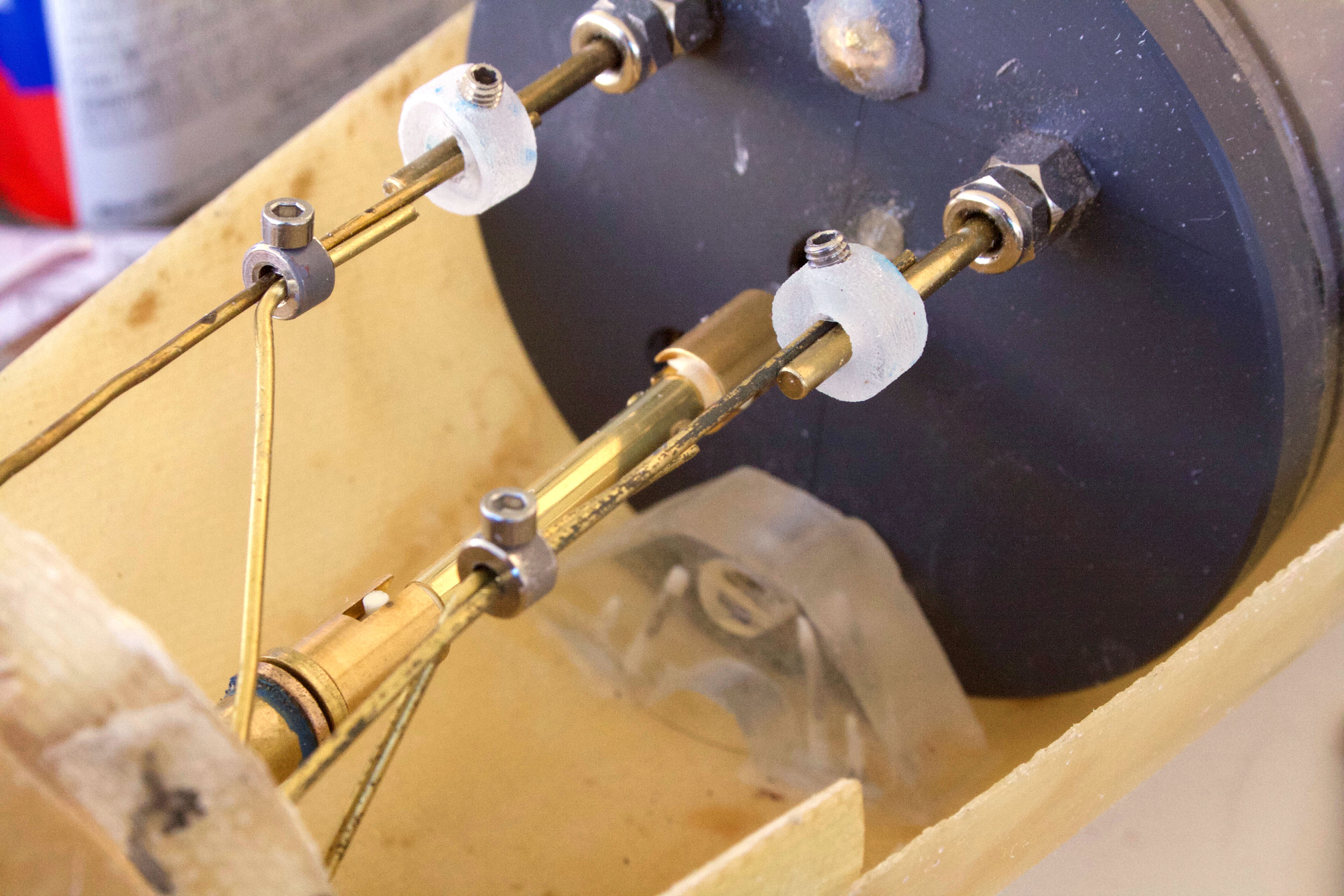

            Ralph, may I drop a photo in?
            Here is what I used in the Walrus.
            It is similar to what Ralph uses.
              Tom, your photo shows 1/16" to 1/16" and it shows 1/16" to 1/8".
              I like your plastic collars.

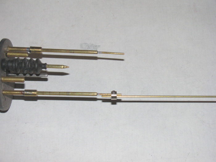

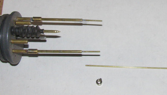

              This is how I do it now.
              I come through the end cap with 1/8" tubing. and solder a 1/16" short length of rod in the end.
              Then I use 1/16" to the control surfaces.
                Photos of my Gato rear end cap showing how control rods are connected.
                The 1/8' tube through the end cap with 1/16" rod soldered in the end for control connections.
                This allows cylinder separation and it allows adjustment with a simple Allen wrench.
