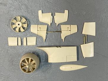

    I am beginning a new build of the newly retooled 1/96 scale Submarineworks Seawolf kit as the USS Connecticut. I’ll post images of the new kit shortly so all can see how it has been improved. The main thing is it now has the Mold-in-place anicoic coating that ended up on the boats after sea trials when it was commissioned into active duty.
  • pirate
    • 849

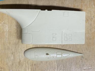

    Two-piece epoxy fiberglass hull.

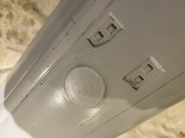

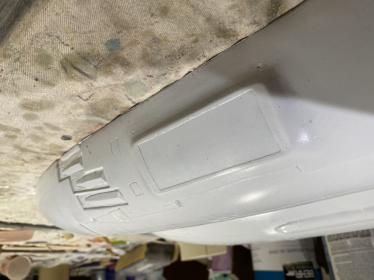

      This shows the edge of the MIP coating on the bottom.

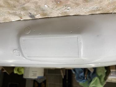

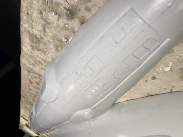

        Ballast vents

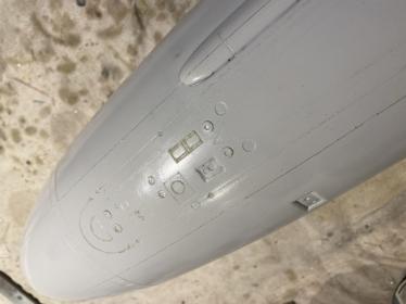

                With the super tedious process of cutting out all the ballast vents on the bottom of the hull.

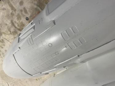

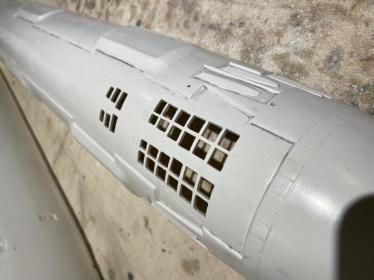

                        Making progress. Forward ballast tank vents opened up.
                        On the the stern vents.

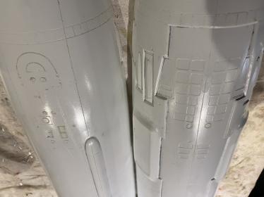

                            I’ll show a little bit about my process for removing the material and cutting out the ballast vents.
                            I start with a small drill bit and drill out each corner of each vent.
                            Then I use a larger bit inside the edges of each vent to take out a little more.
                            Next I use a grinding bit in a Dremel to grind away from the center of each vent to get very close to the edges, careful not to get too close. You can easily file more material away, but if you go too far, that’s a whole different thing—not good.
                            Finally, I use some different size files to fit the hole and file away the last bits up to the edges creating a clean vent opening.
                            In this first photo you can see the small holes in the corners, two vents with the larger bit, one ground out to the edges, and the last step of filing to the final opening.
