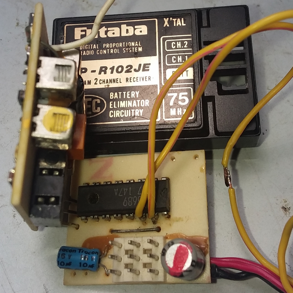

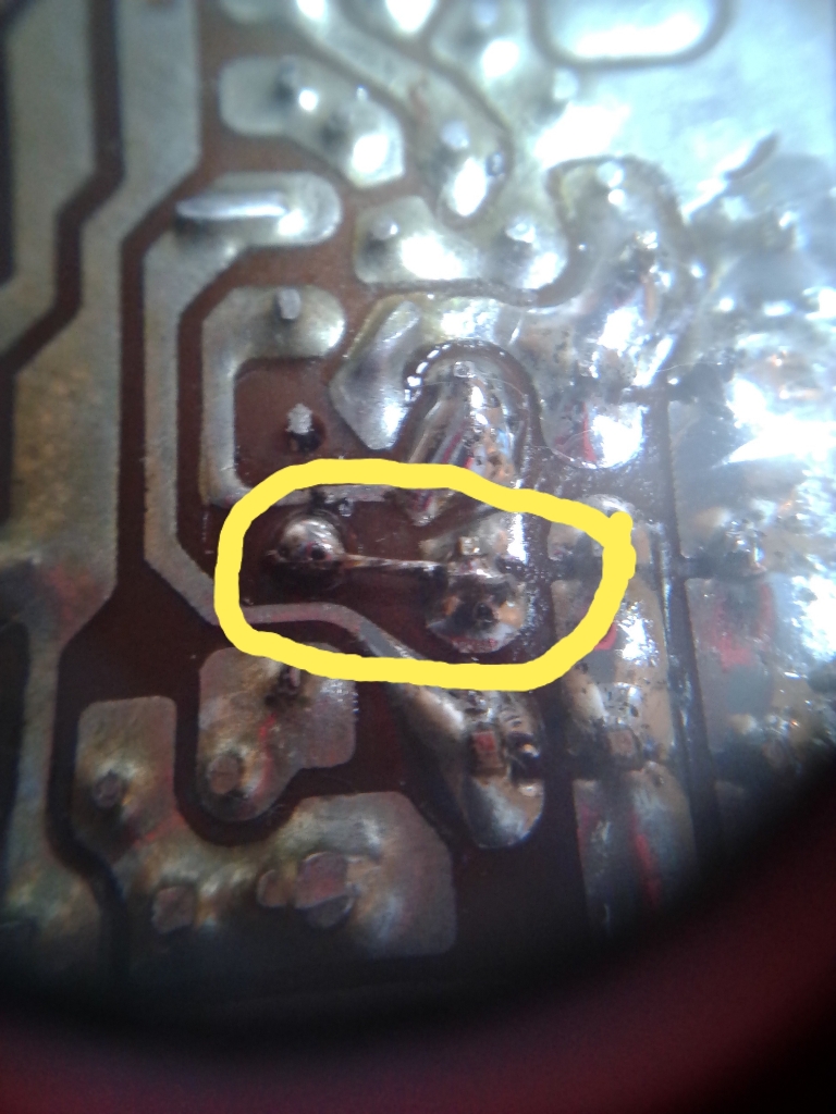

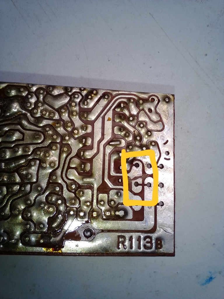

              Warning this is for your entertainment Only, if you fall off your chair it's not my fault.
              Please don't try this at home, l needed to kill time and some brain cells.

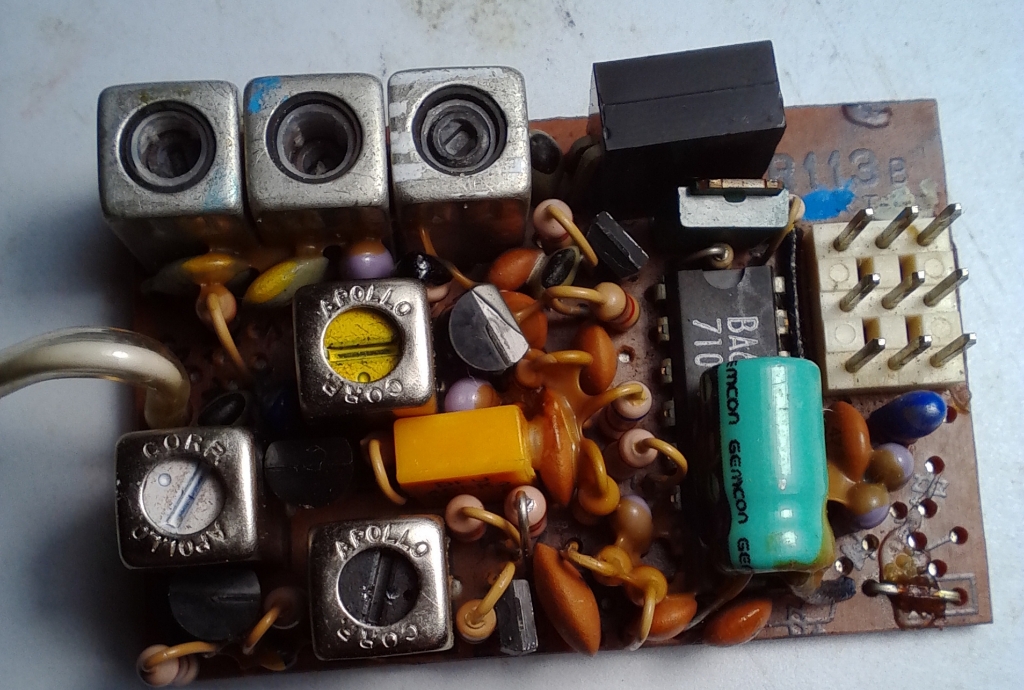

              Before

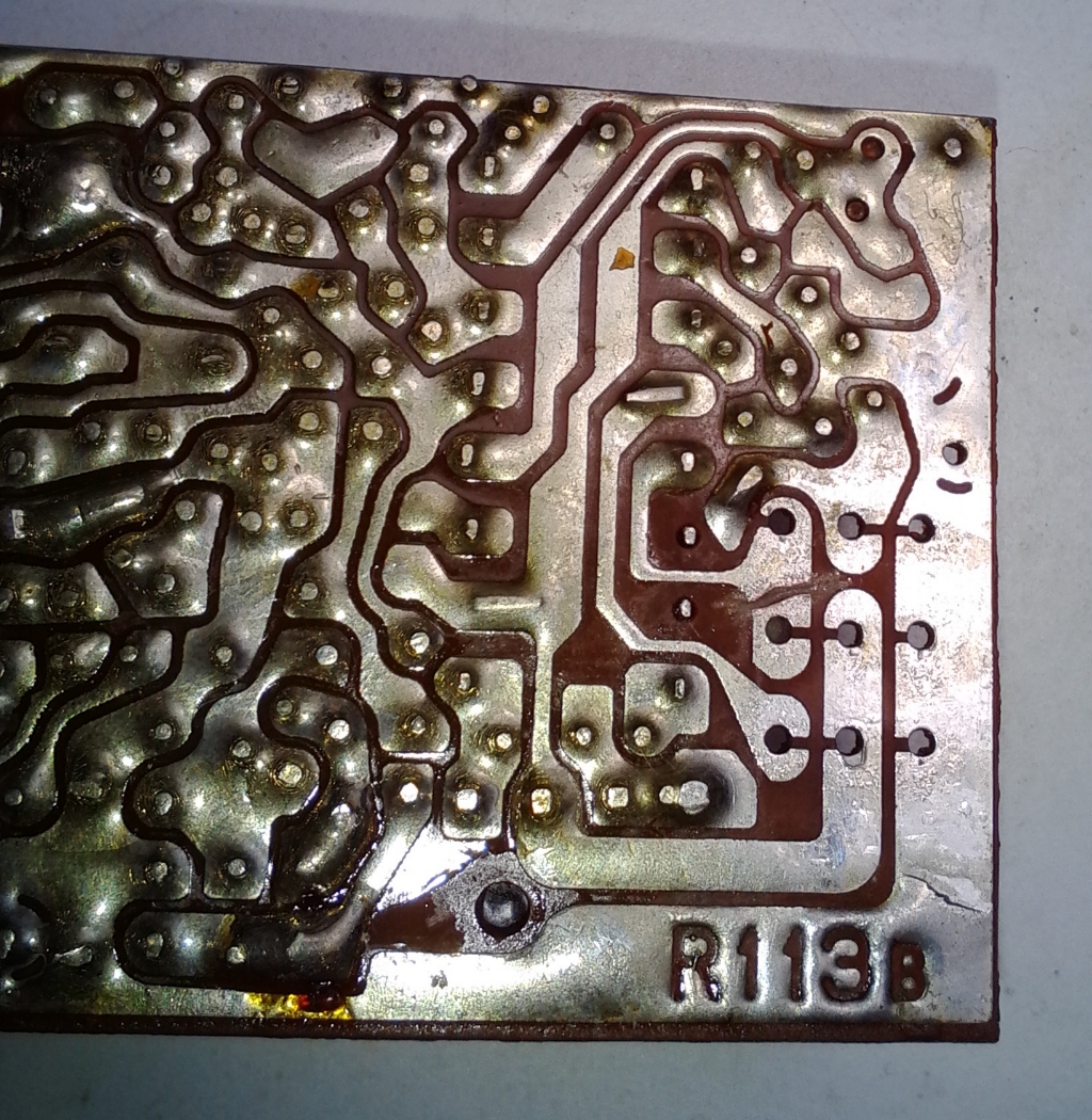

              Removed pins

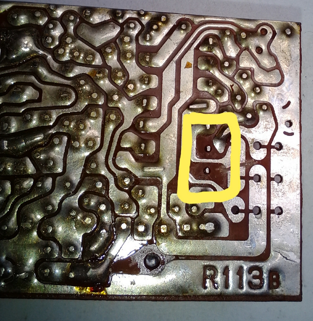

              Cut trace

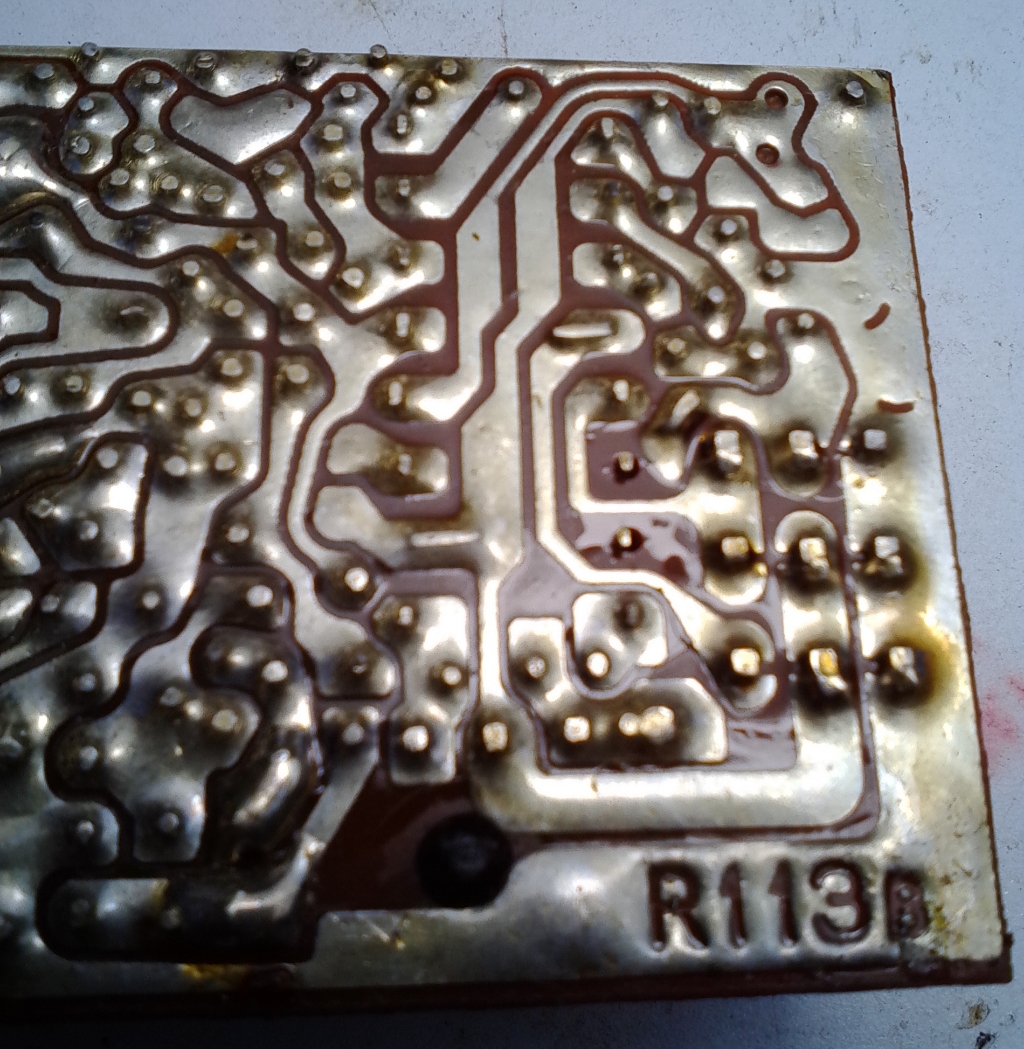

              The 2 PWM pins need to reconnected

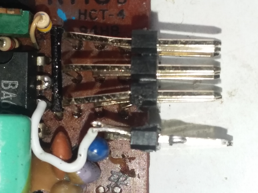

              Jumper
              Top jumper wire.

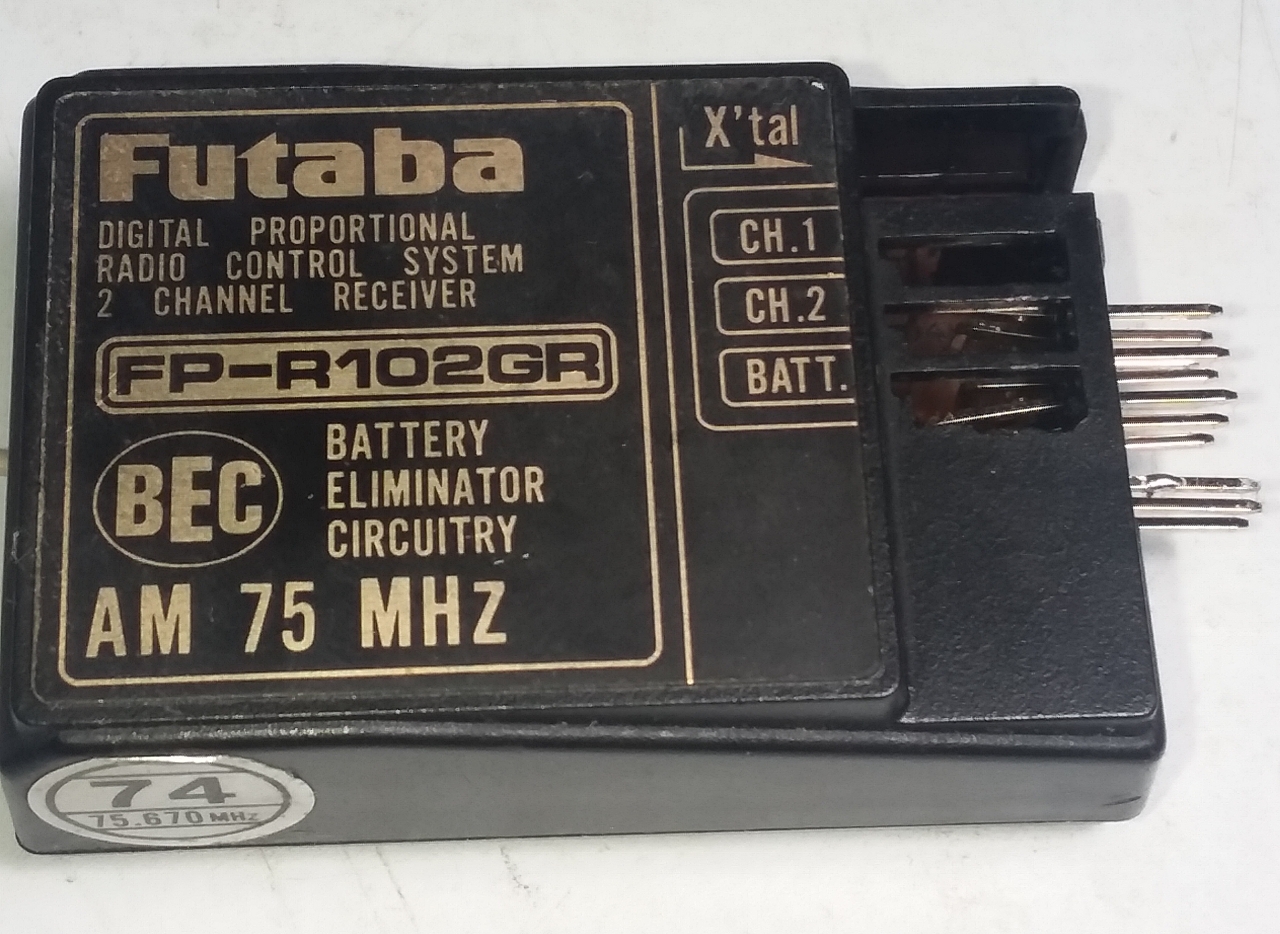

              Another Frankenstein receiver. Done!
              Another receiver
              Instead of 4 channel I may make it to a 8 channel receiver.
              But have to make a 8 channel transmitter.
