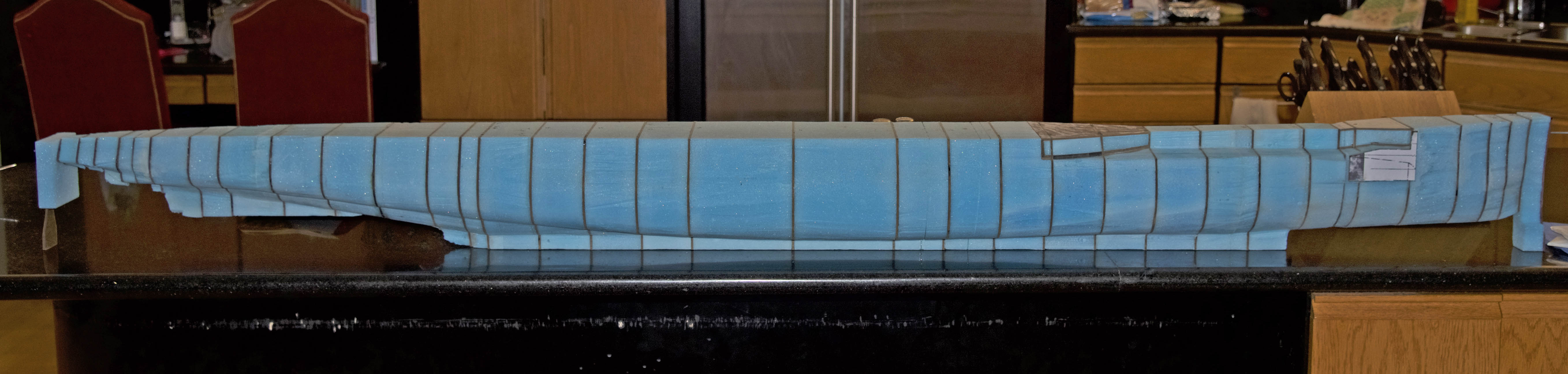

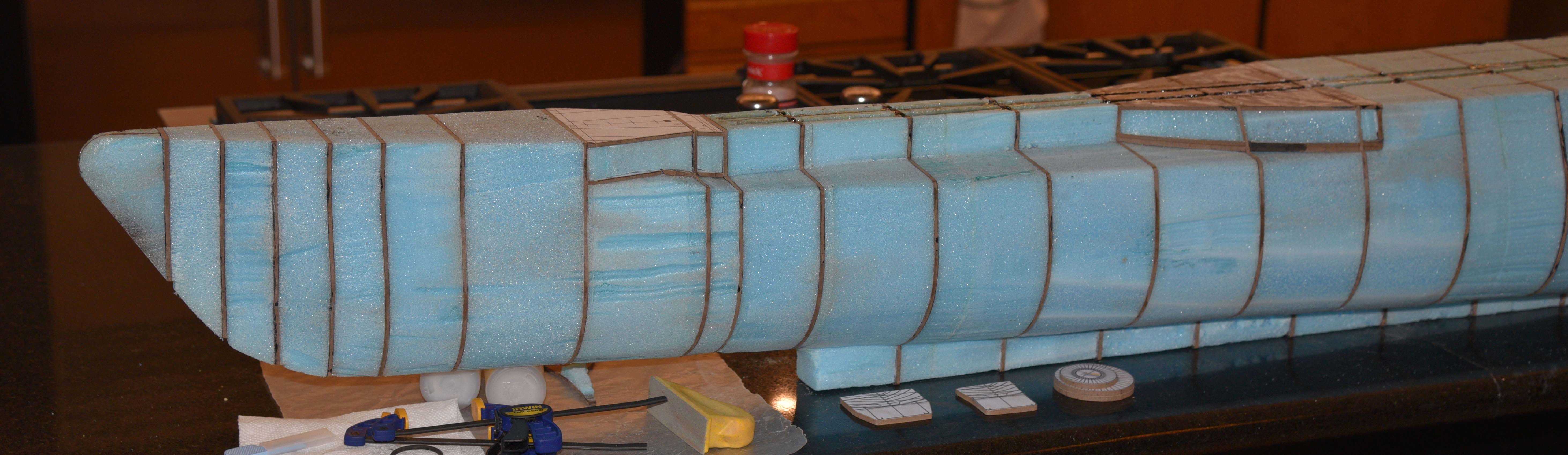

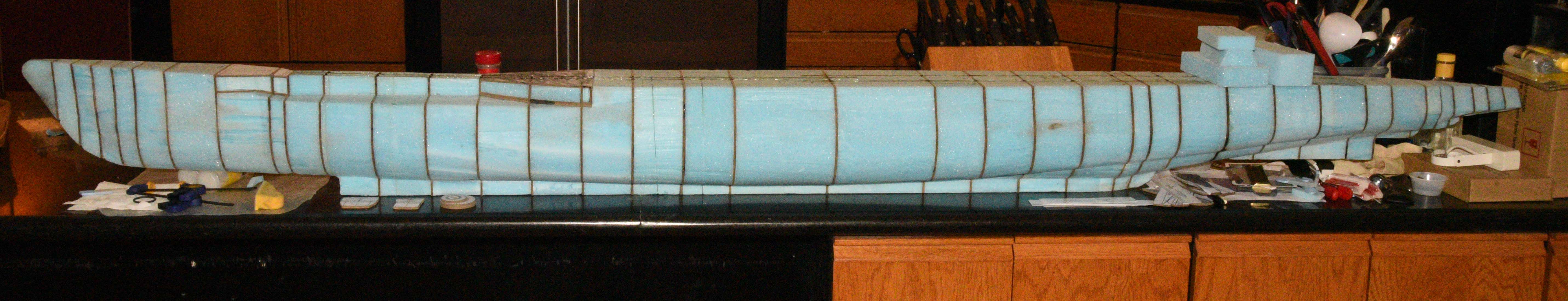

      Slow progress has been made on my U-190. Work still needs to be done on the bow, balkongerät, aft end of the keel, the skeg, and the area at and aft of the stern torpedo tubes.

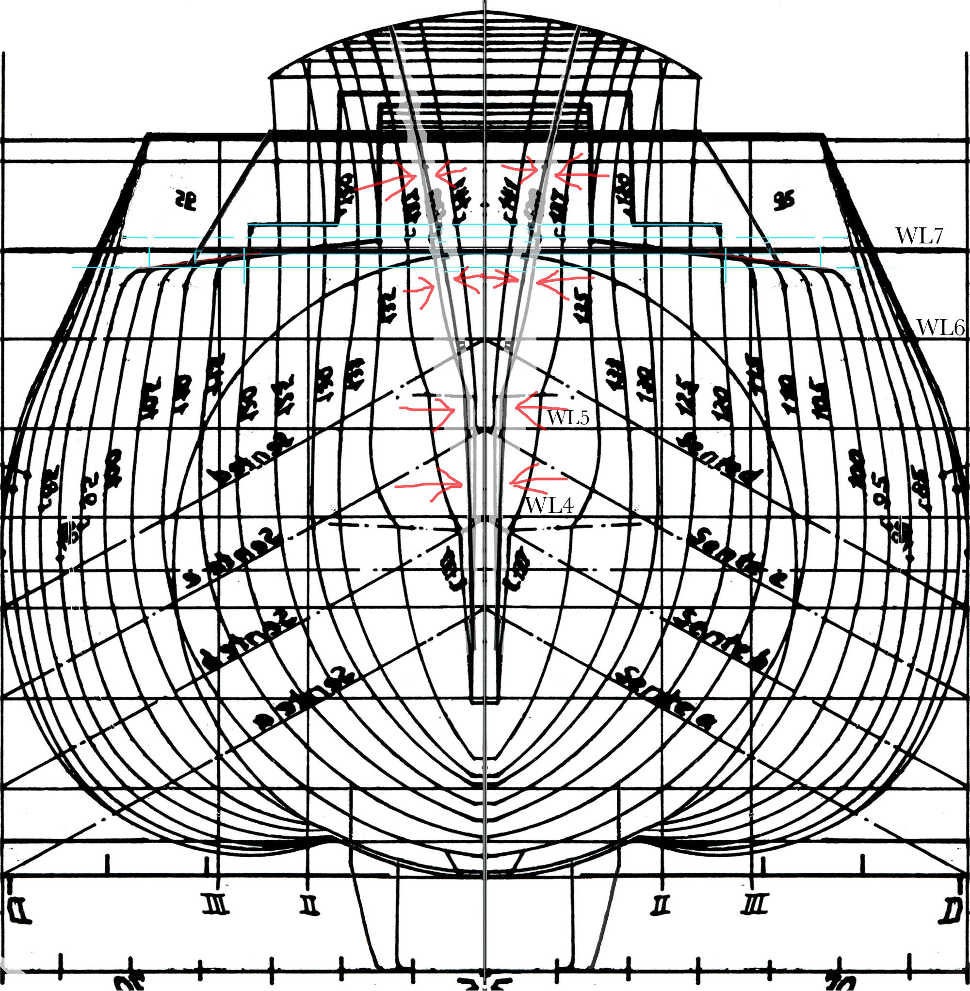

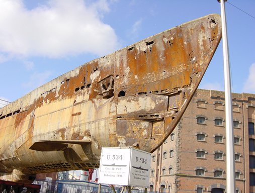

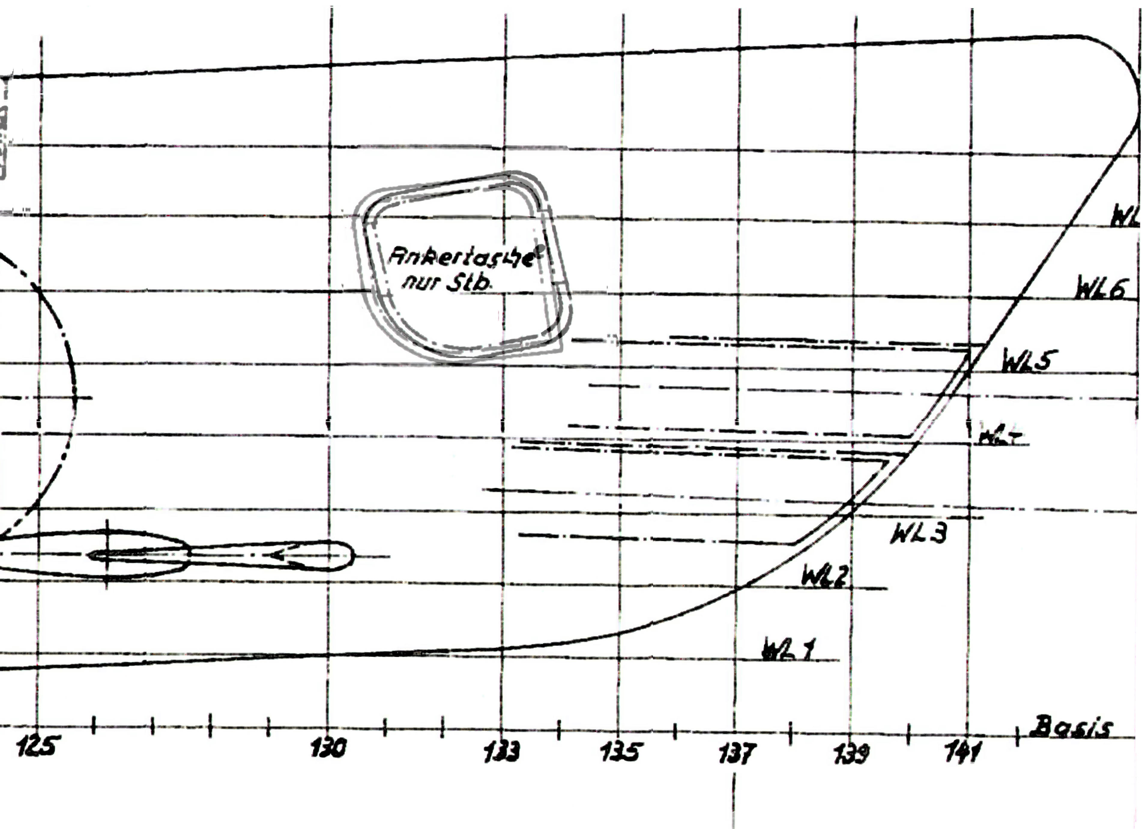

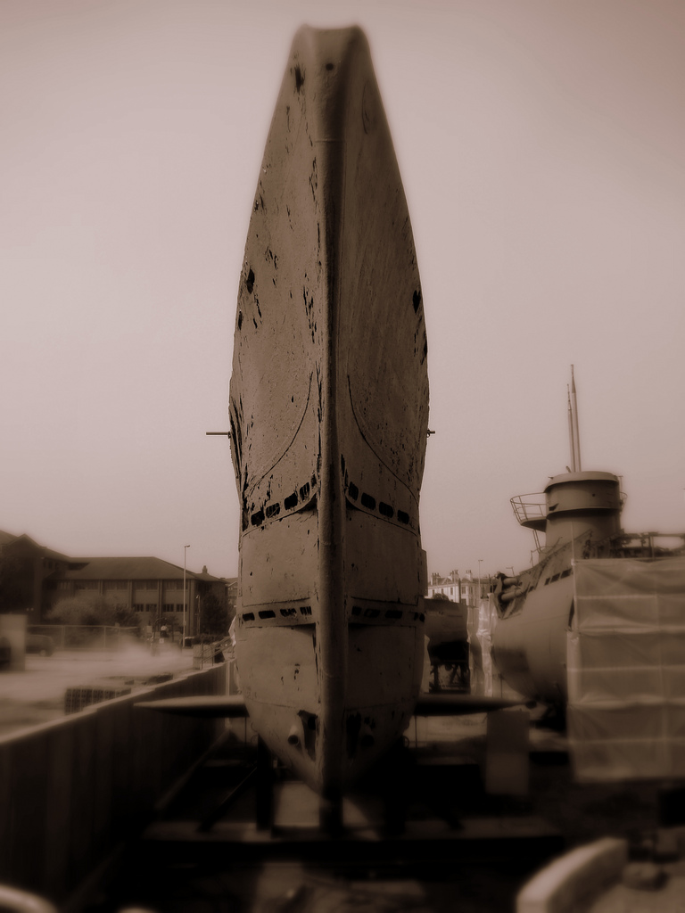

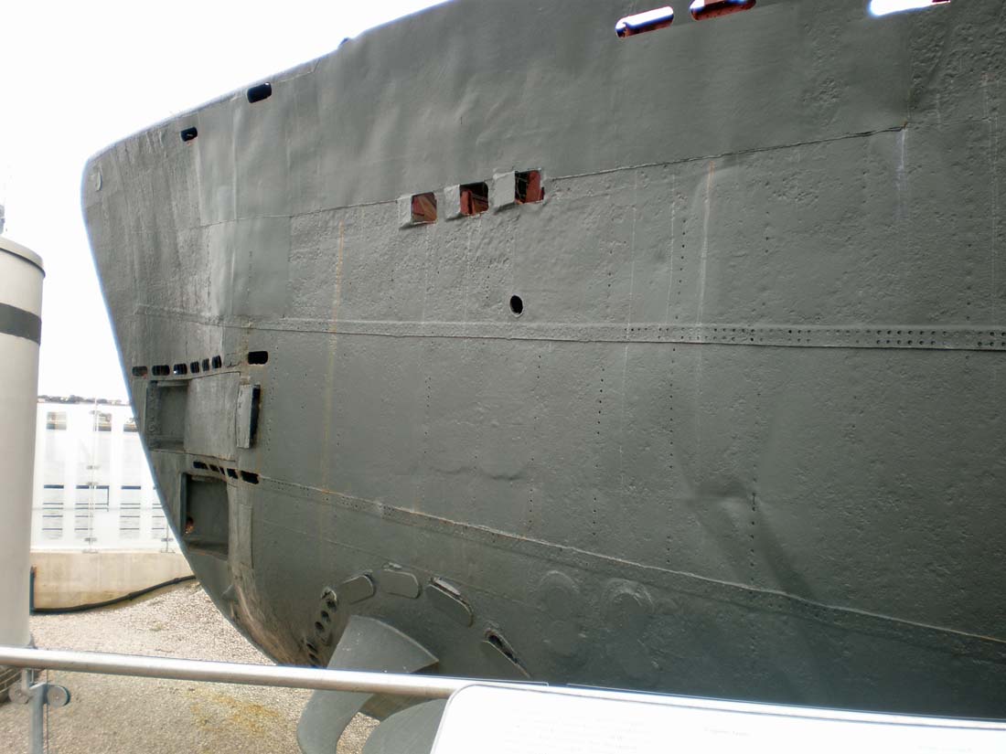

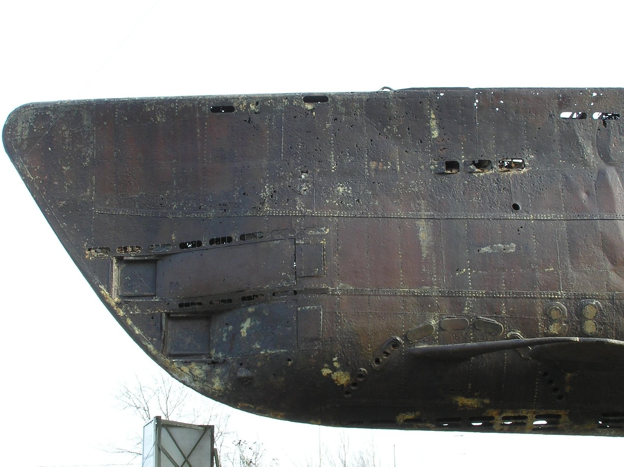

      As I continue I’m still debating the accuracy of the plans. Perhaps I’m being unnecessarily compulsive, but I would appreciate opinions.
      For frame 139 the light grey line is the original line on the plans.* The black line for frame 139 is the one I got by superimposing another set of Type IX cross sections. Looking at old pictures it appears to me that the superimposed cross section looks more correct than the original plan cross sections.* At the position of frame 139 I don't believe I see the bulge in the hull contour on real U-boats at WL6 and WL7 levels.* Does anyone have an opinion about which is correct or am I being ridiculous? Getting this far has been a fair amount of work.* I don’t want to make a mistake now.

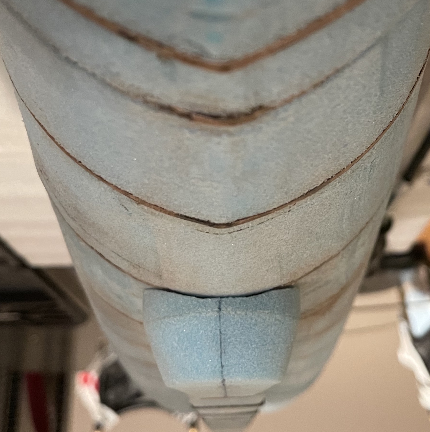

                        After several failed attempts, I've made a balcony that I think doesn't look too bad. The shape still needs some refinement. I have looked in every book on U-boats I have been able to get and searched the internet more times than I can count trying to find the correct dimensions of a balkongerät on a Type IXC without success. I ended up looking at every picture of a Type IX showing the balkongerät that I could find and I guessed. My estimate was a maximum 1:1 width might be 180 cm giving me a maximum width of 60 mm at the scale I'm using. I haven't glued the part on yet so it could still be changed. If anyone has an opinion about whether or not I should make any changes please post your thoughts and suggestions or if I got it (maybe about right).
