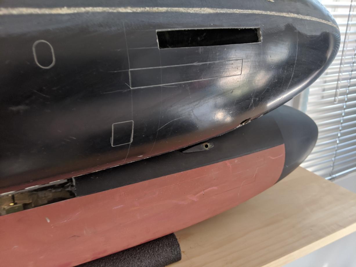

      The hull did not include a scribed demarkation line at the forward sonar array area. To add one, I printed the tool in the pictures below. The LA class is only curved at the bow and stern. The central portion is straight. So I extended those lines on the plans towards the bow. Then, I centered the tool over the plans, adjusting for where a marker would mark the correct line on the hull. After everything was drawn on, I "scribed" it with a razor saw. Did this to both hull halves.

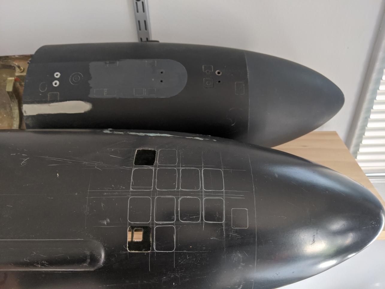

          Before I cut out the bottom flood holes, I need the hull to be in one piece so I can lay down some indexing strips. Here's a quick-and-dirty version of what I did. It may seem a little strange, but I've always done it this way, and it's always worked just fine.
          Inside the bottom half of the hull, I marked where the hull would be cut bow and stern. The cuts will actually be done on the upper hull (yes, both of them... I'll explain at a later date), but I need to know where these positions are so I can properly cut the indexing strips to length later. I sprayed in several layers of this mold release, which is really intended for rubber molds, but it helps here too. After that - and yes, you can laugh - I spread a very light coating of Vasoline down. Two reasons: 1) it acts as a release agent, and 2) it helps the fiber glass tape stay in place while you wet it with resin. When the strips have cured and are removed, scrub the gasoline side with a dishwashing scrubber, and voila... it's gone. I cut and saturated three layers of one inch fiberglass tape from bow to stern. I'll let this cure for 24 hours, and repeat for the second one.
