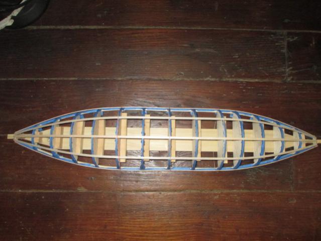

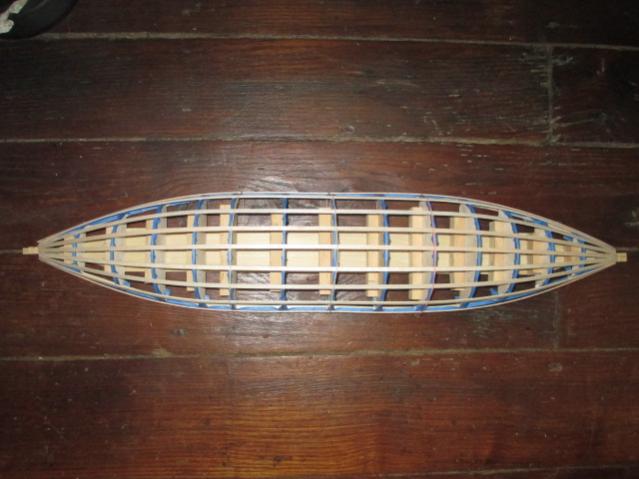

    Here is the strongback with frames.
Name:	RCG strongback with frames.jpg

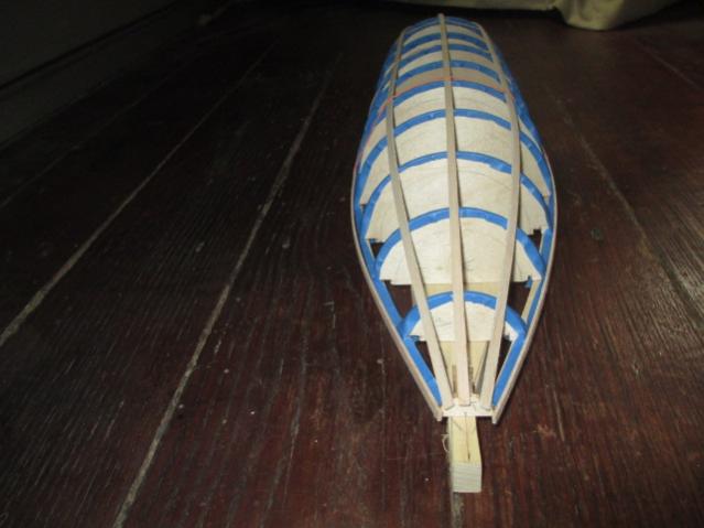

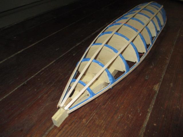

      Here is the strongback with outer banding/sheer plank.
Name:	RCG stongback with outer banding.jpg

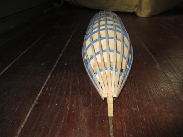

      And with frames taped so any glue with not stick. I only want plank-to-plank gluing.
Name:	RCG stongback with fames taped.jpg

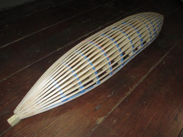

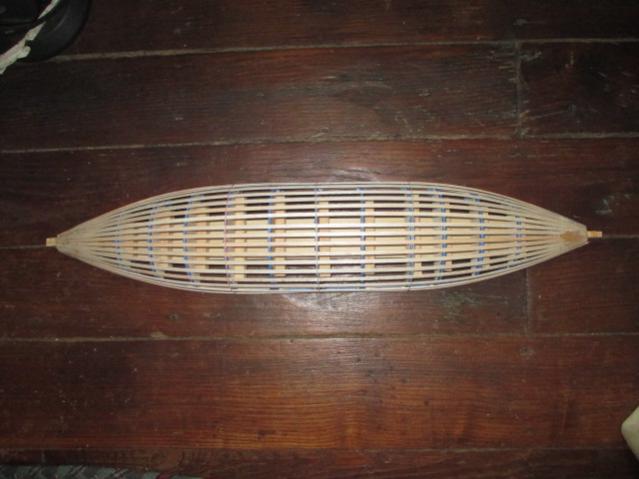

        I set a separate camera at the lower picture quality setting for this forum. Have begun planking...Click image for larger version
ID:	134491 Click image for larger version
ID:	134492 Click image for larger version

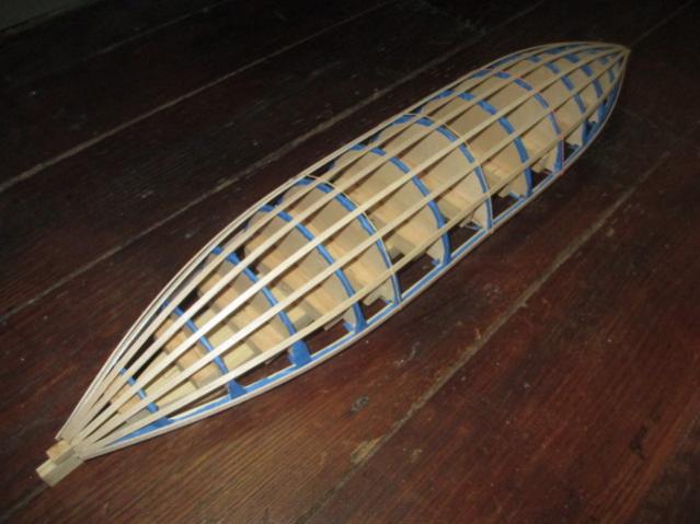

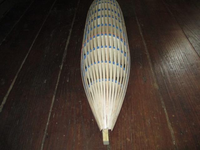

          More planking...Click image for larger version
ID:	134495 Click image for larger version
ID:	134496 Click image for larger version
ID:	134497 Click image for larger version
ID:	134498 Click image for larger version
ID:	134499 Click image for larger version
