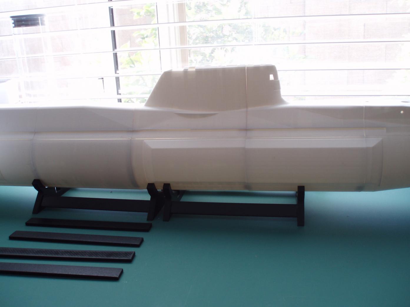

          I've been racking my brain on how to best sand away the striation lines and get rid of the curves that are created by various sizes of triangles and to make them smooth. They are even more apparent since I've scaled up the original files to 1/72 scale.
          But part of me, a very small part, is saying "f*ck it, just leave the printed parts exactly as they are, glue them together, don't even worry about filling the seams between each section, and let the whole boat just be what it is, a printed object". I could even print it in black so there wouldn't even be any need for painting.
          thoughts?
          my OCD is in overdrive here lol
          erich
            Erich,
            If I were building that hull, my modeler's OCD would overwhelm any thoughts on leaving it 'as printed'.... I'd have to see the printed parts to know which method I'd try for finishing the surface.
              Jeff - once I get a couple more pieces printed I'll tack them together so you can see the results and surfaces.

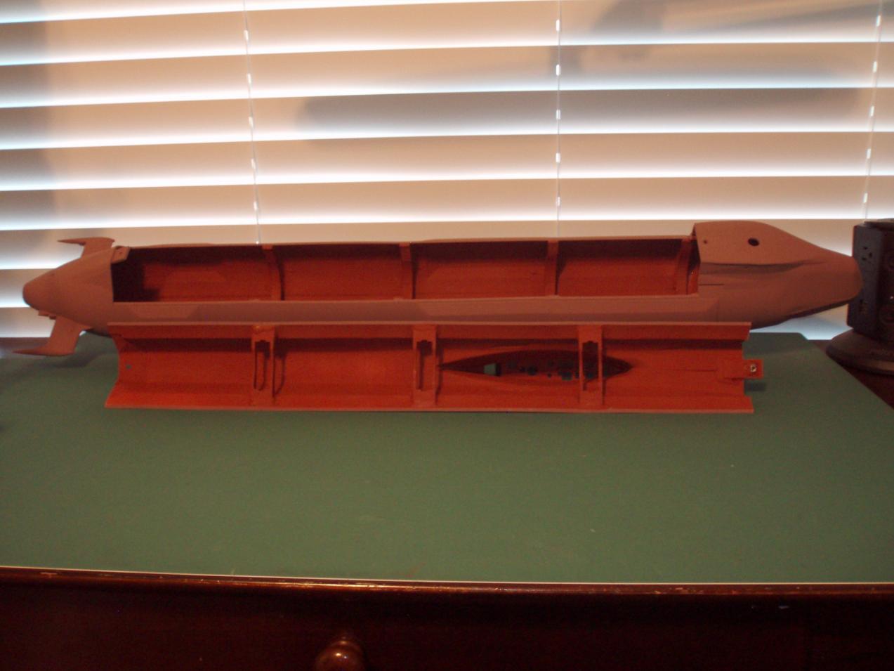

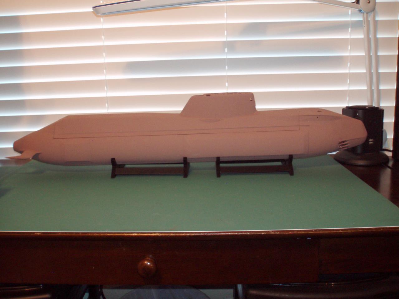

                            Hi eckloss,
                            I have printed the Astute 1:96 scale STL files at 100% infill.
ID:	134028 Click image for larger version
                            I sanded the model with 220 paper, filled the seams with bondo, sanded again inside and out. Used SEM High filler primer on the outside, and Red Oxide primer inside. It sits now waiting for final sanding and finish work.
