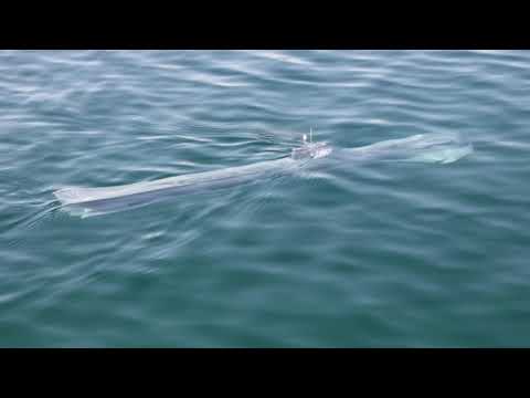

          My mind is changed...... It is getting smoother to run! I am learning how to handle this sub and the wind was not scale hurricane winds.
          I have proof too!
            #50
            I think you've got it, Tom! Admiral Nelson would be proud.

              In the last photo, you might see there is a list to the starboard side. Not sure what is causing that, so will need to investigate. I did add a small amount of foam in the bow, but I think I will add more and trim this sub not level, but try it with a bow up attitude. See what that does. In the video, you can see the leveler is working overtime to keep it sort of level or mostly level if you are a Princess Bride movie fan.
              The Sub-Driver was dry and worked consistently. This was a relaxing run.
