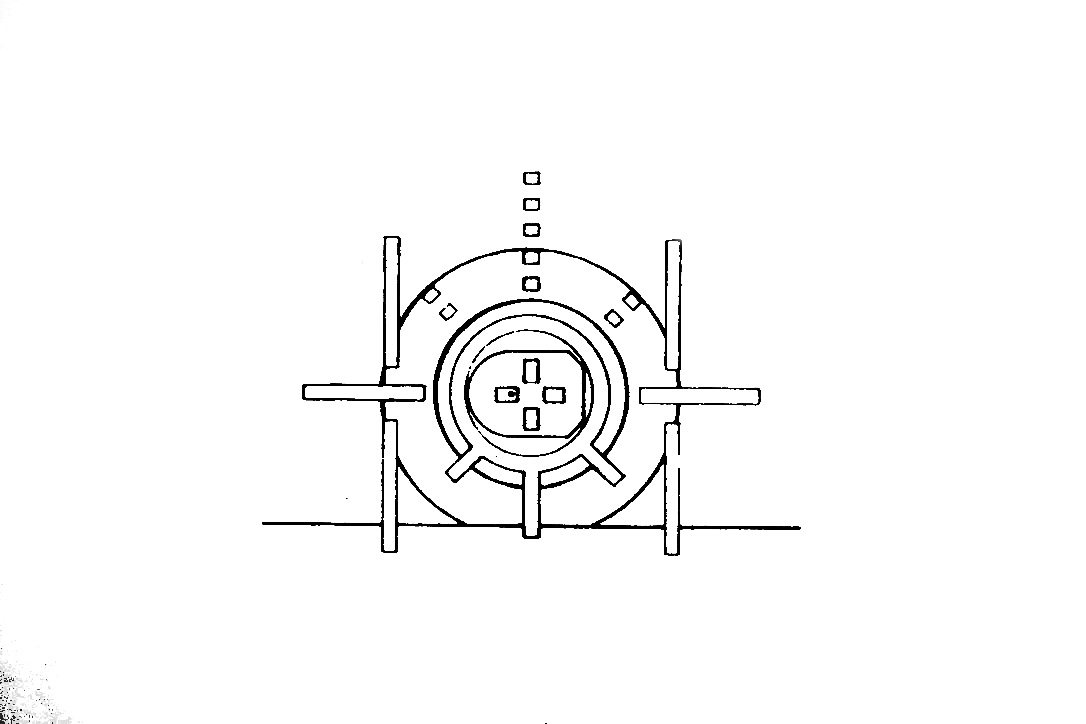

    Are there any sources for 1/72nd scale US nuclear subs markings such as the escape hatches and draft markings?
    Thank you,
    Dave
    • 854
    Dave,
    Unless you're building a model of a ship in its sea trials period, you can ditch the escape hatch markings. The draft marks can be done up from a sheet of Woodland Graphics dry transfers of the correct height. I'm moving and don't remember the correct height for a 6" 1:1 scale numeral. Somebody out there can help!
      Hope this helps.
