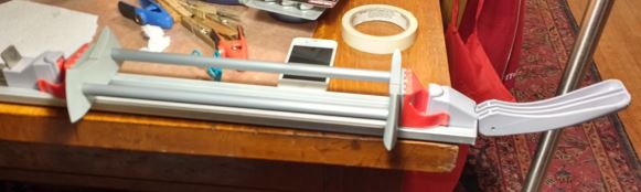

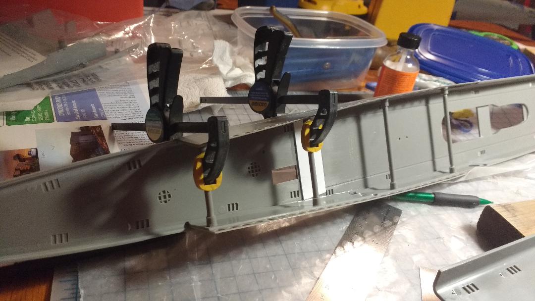

    Glued up the boat stand. Used a clamp from Harbor Freight.

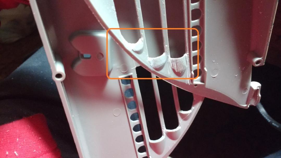

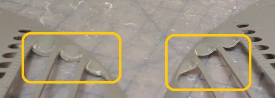

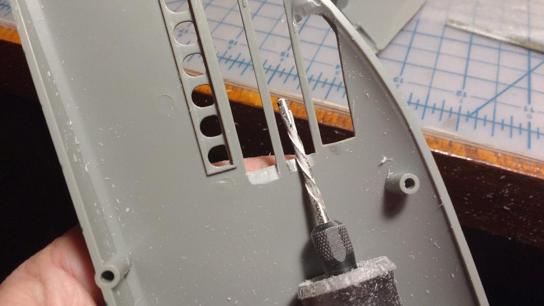

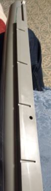

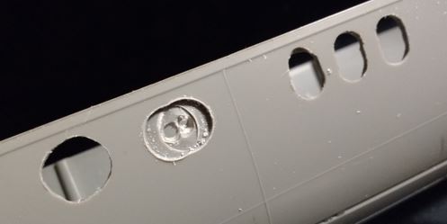

    The flood holes were drilled with a brad point drill bit and hand drill. You can see the outline it leaves.
    You can only drill completely through on one hole. Then clean the other part of the opening with a Dremel (4000) tool with a guide point roto-zip bit.
    Since the hull was not glued together I could shove the bit up from the bottom \ inside hull and be able to see the material I was removing.
    Being able to slow the Dremel tool down in speed made it possible to use this bit.
    Some openings are great and then some are not so great.

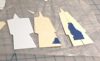

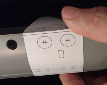

    Cut the template up for the flood holes and folded over the edge. Taped down with scotch tape.
    Numbered the paper and hull with the same number 1 thru 12 I think.
    They fit well between the weld lines on the hull.
    Took a drill bit in a pin vise and drilled holes on the center marks.

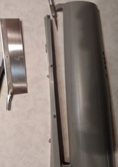

    Cut the ends off with a saw from Hobby Lobby.

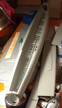

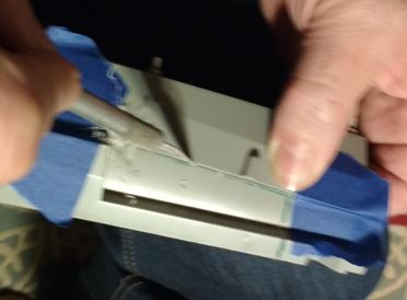

    This is where the drastic surgery on the hull takes place - opening the upper hull.
    Cut the vertical cuts with the saw. Then cut the horizontal cuts with an X-acto knife by dragging the back of the blade.
    It scrapes a curl of plastic with each pull. I tried to count the number of strokes and guess somewhere around sixty plus
    to break through the thick plastic. Not fast but kind of soothing to watch the curls come off.
    For the first (easy) part with the pins I let the knife follow the intersection of the curved and flat surface.
    I should have not cut the cross joint connection pin pocket off. We will see how strong it is after the glue dries.
    I had previously taped the hull and decks together and made a pencil mark that can just be seen in the picture to help
    judge what I wanted to cut out. All these steps can be found in other builders build logs. Nothing new under the Sun.

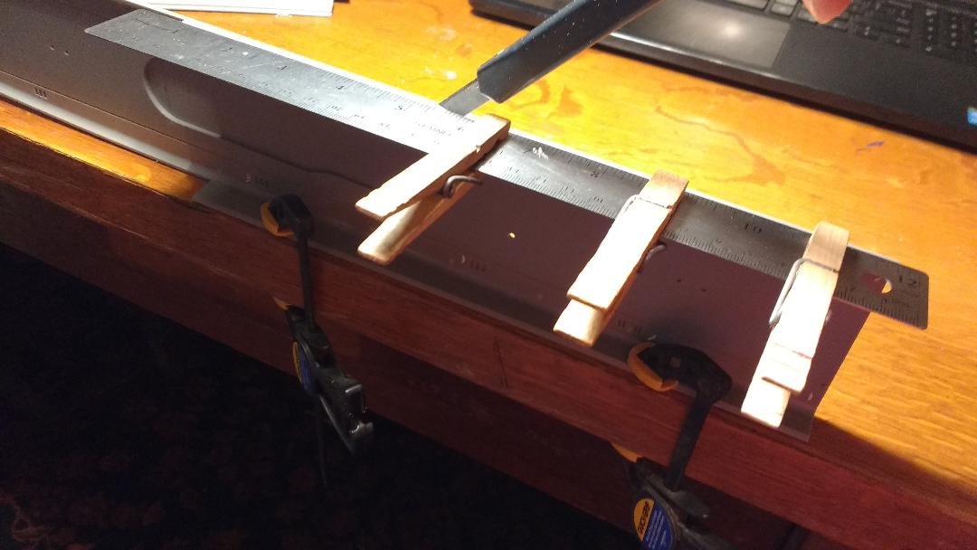

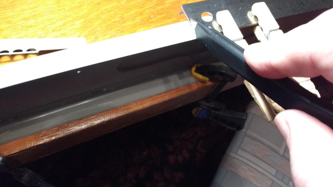

      So I did a little scribing with the back tip of the knife blade. Makes a square slot instead of a v shaped slot.
      Clamped my deck on edge with mini bar clamps.

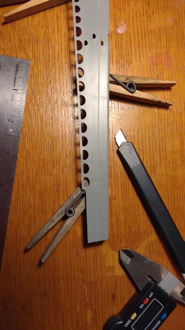

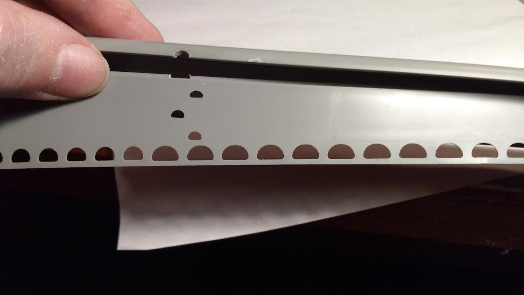

      Scribed lines on the sides with the limber holes. Cut the 4th hand\foot hole before gluing.
      Used the grinder for the top arc and saw and knife for the bottom notch.

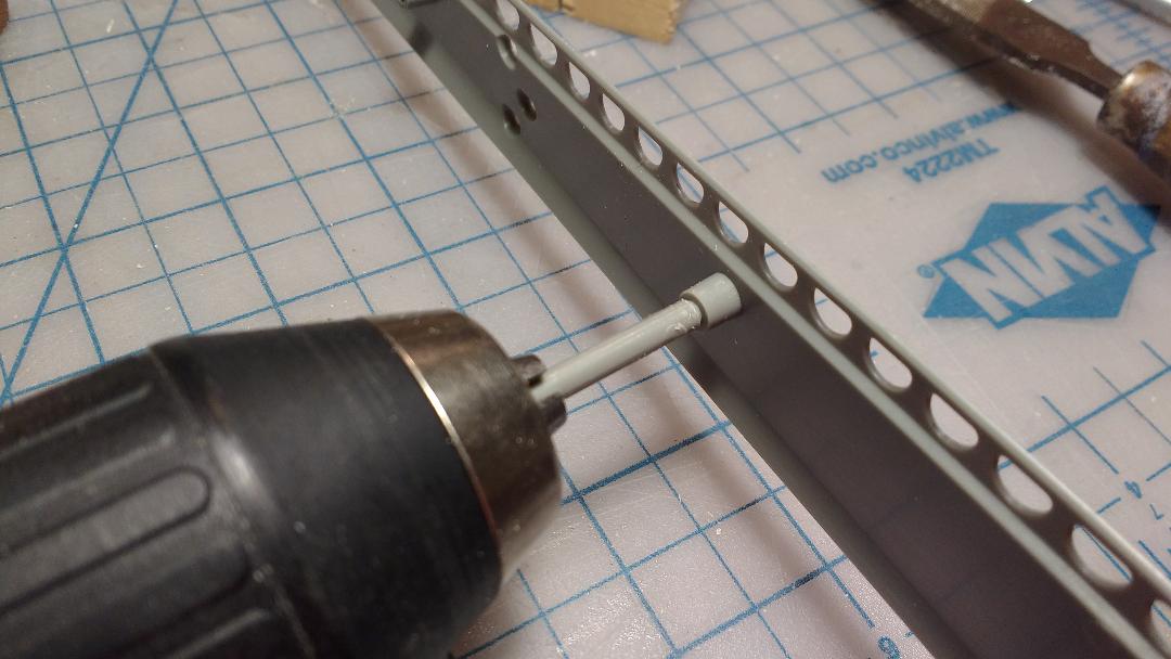

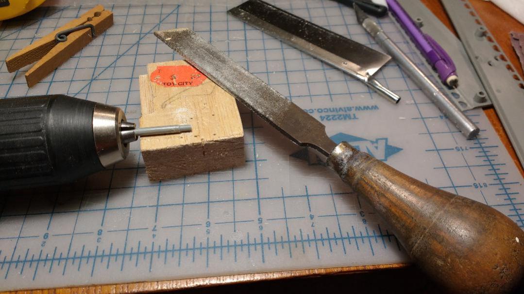

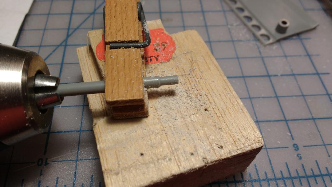

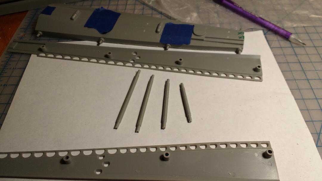

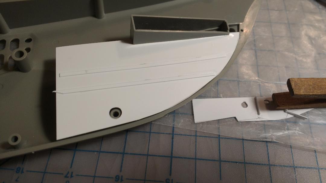

      Made pins to connect side pieces from pieces of sprue. Used a drill and file to fit piece for hole size.
      Found the close pin worked to keep the support block from walking away on me.

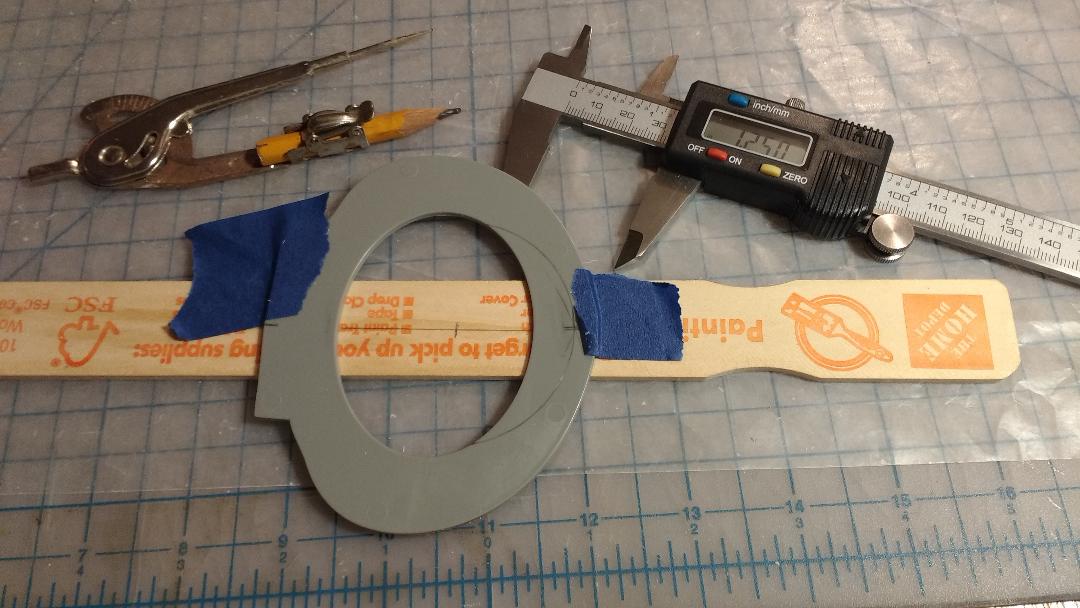

      Used a compass to mark the center line on the bulkhead piece; then again to mark the cut out for the Water Tight Compartment.
      Used the back edge of the blade to scribe and cut through the crescent shape.
      I left a 1/4" for ballast space. Not sure what space other modelers used.

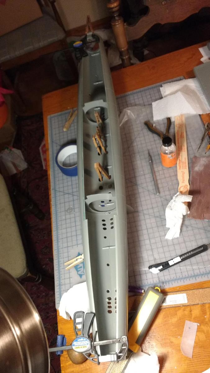

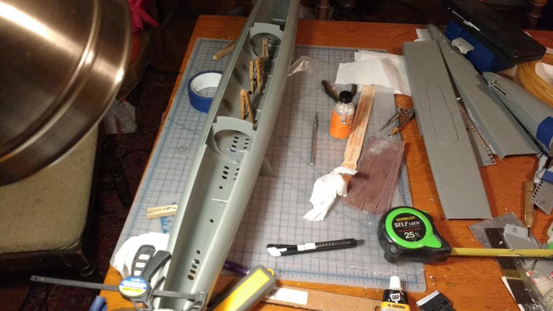

      Glued the hull together. Tape on the outside and mini bar clamp on the deck side. I used clothes pins in the flood holes for clamping.
      With the hull top open it made gluing easier. Did not glue the bulkheads as I want to remove and finish cutting them for the WTC support.

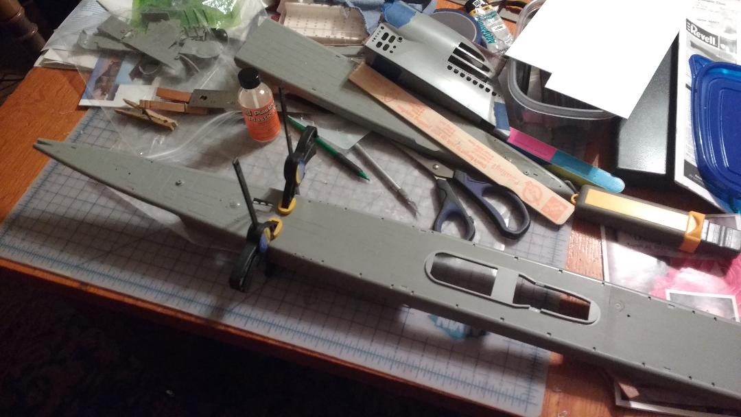

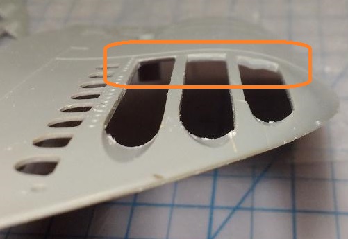

          Previously opened the torpedo doors. Thinning the edges around the openings with a power tool and then the jewelers file.
ID:	132817Click image for larger version
ID:	132818Click image for larger version
ID:	132819Click image for larger version

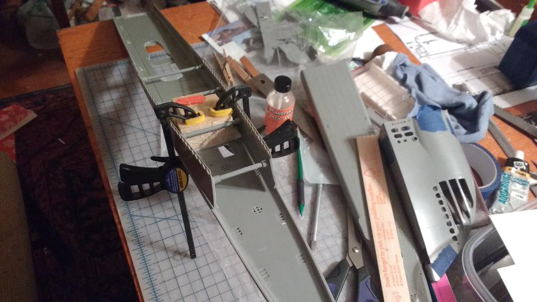

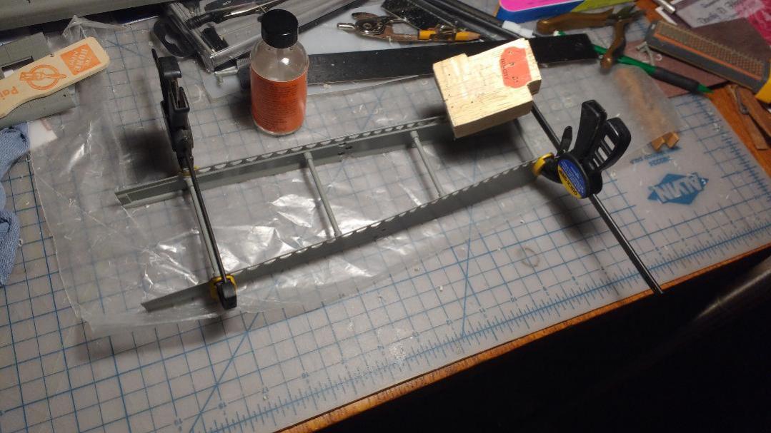

          Glued the limber hole side pieces together\ sides to middle deck piece \ bow to middle deck \ sides to bow.
ID:	132821Click image for larger version
ID:	132822Click image for larger version
ID:	132823Click image for larger version
          It probably would have been easier to glue the bow and middle deck pieces together first and then glue on the side pieces
          followed by the cross bars.

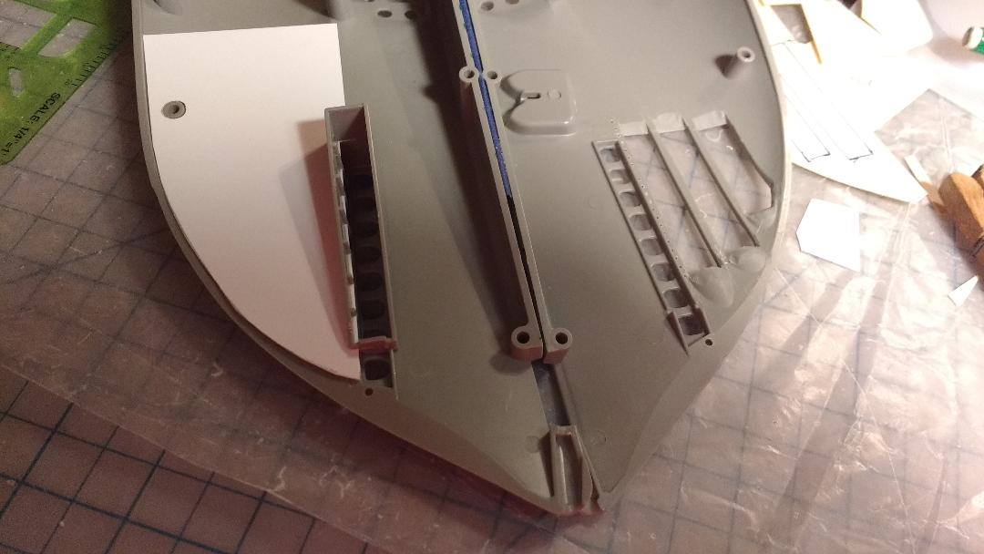

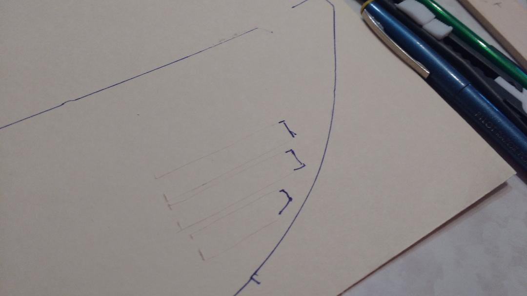

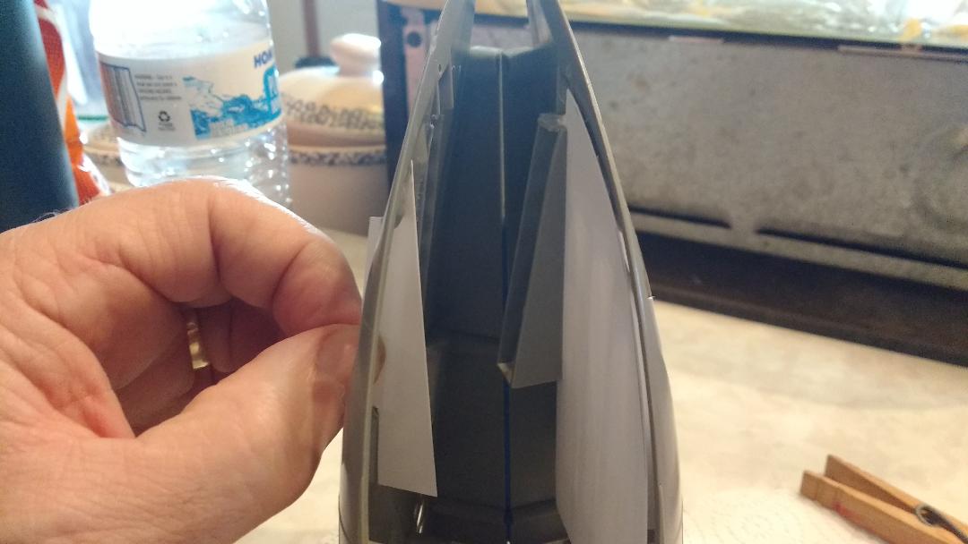

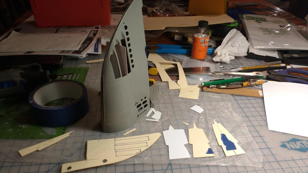

                    Drawing patterns for torpedo door area.
                    Using the retractable knife blade lets you mark close enough lines on the pattern for the door openings.

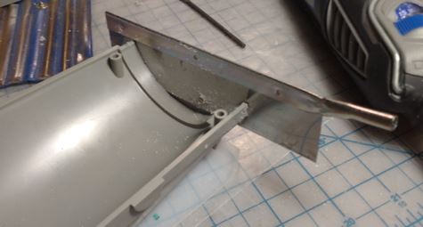

                    Used a saw to make a slot in the limber hole box to hold the back wall of the openings in the center of the hull.
ID:	132890 Click image for larger version
ID:	132891 Click image for larger version
ID:	132892 Click image for larger version
ID:	132893 Click image for larger version

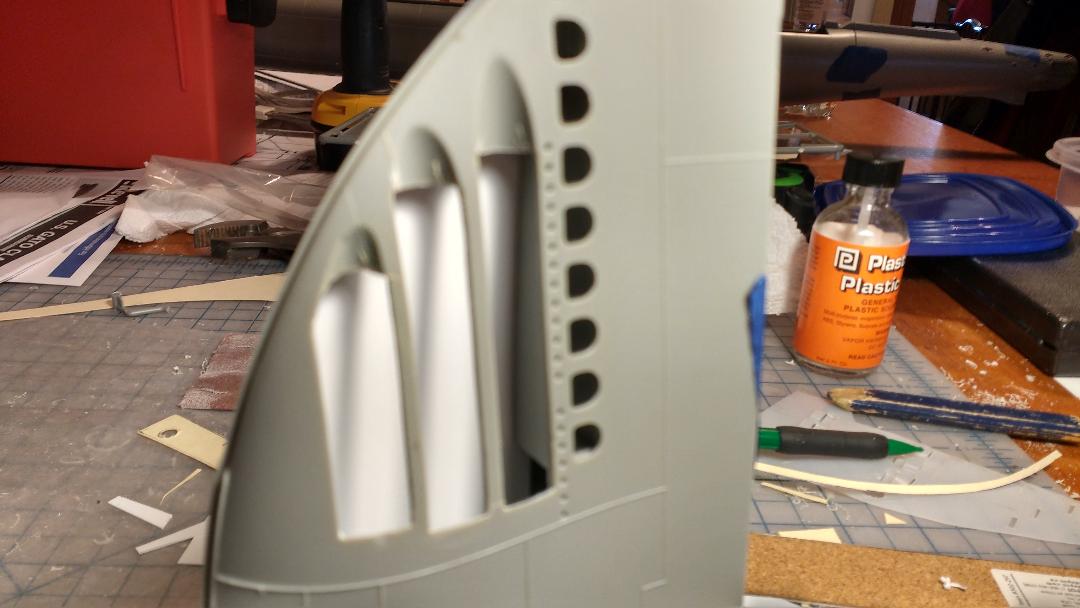

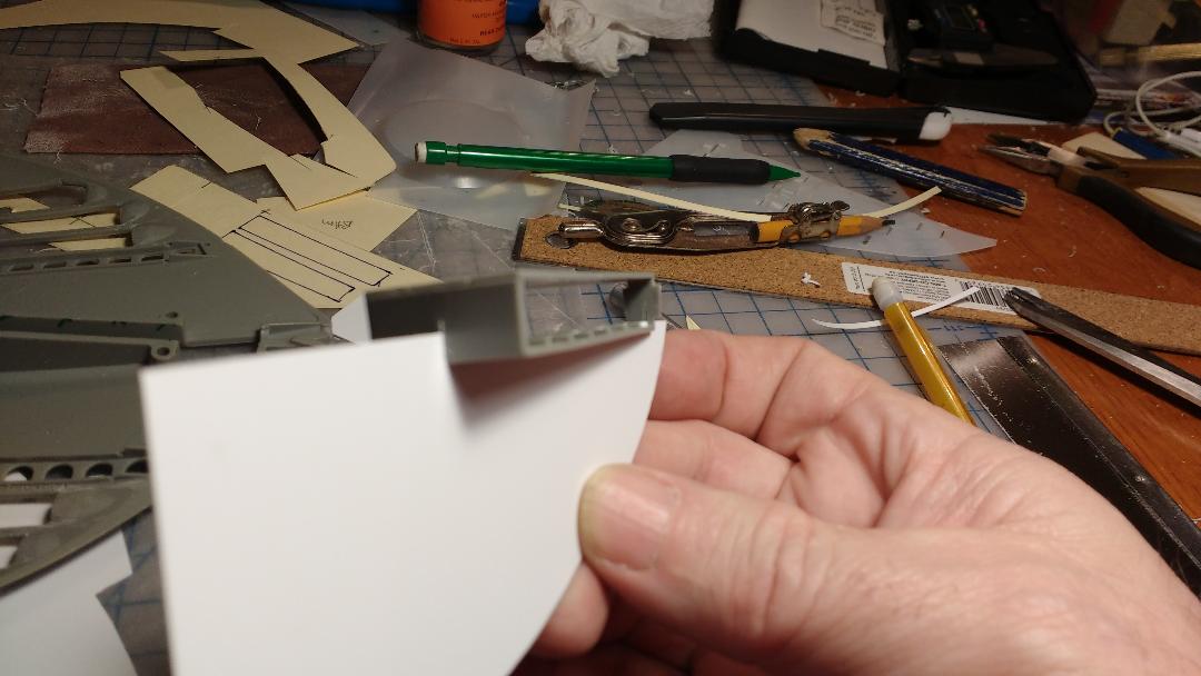

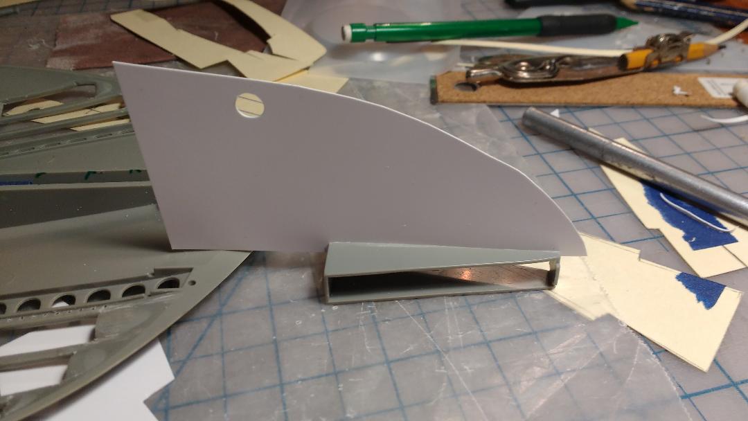

                    Cut paper patterns to make floor surface in the openings. Later cut them in half to glue to back wall.
                    They were left a little long to have something to hold on to as I test fit the floor pieces.
                    I did not take a measured picture of the hull opening. Maybe later.
