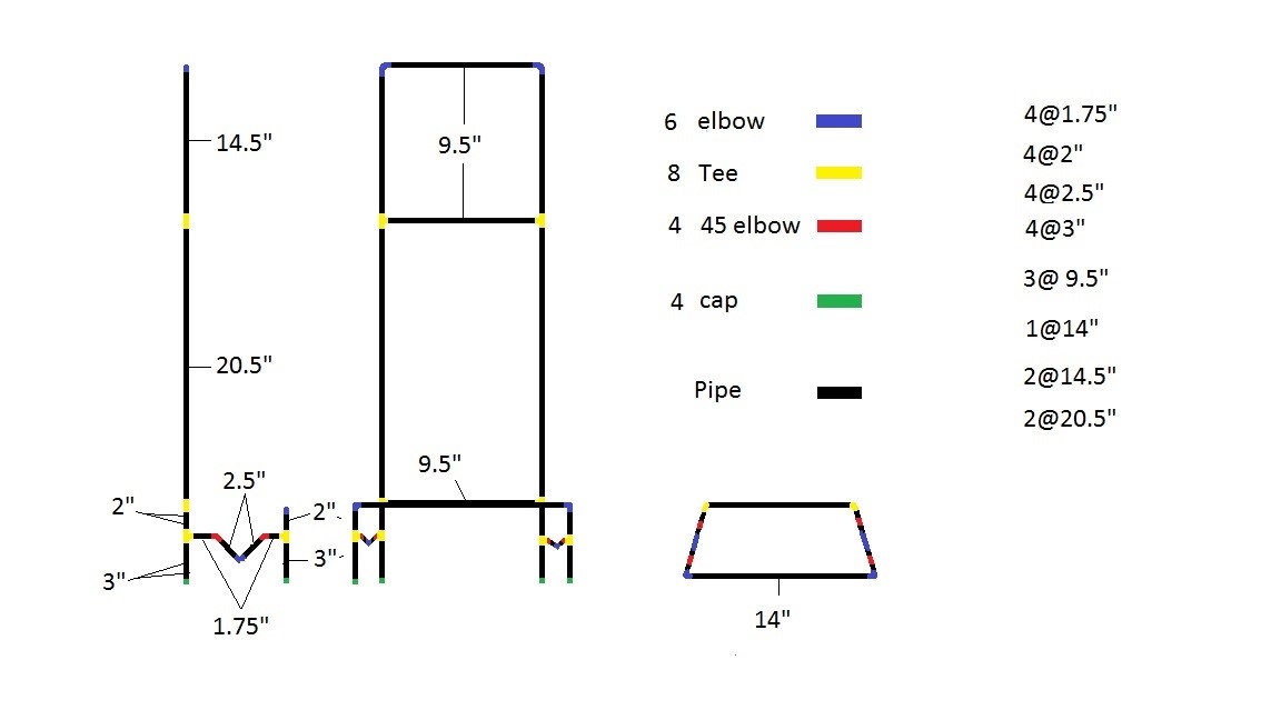

    Several people at Carmel asked me about my launcher frame so I thought I should post it here. I made mine based on one that Rick Teskey has. I'm sure he copied his from someone else. It is made of standard copper water pipe and fittings . I did wrap the areas that would contact a boat with rubber electrical tape to protect the boats.

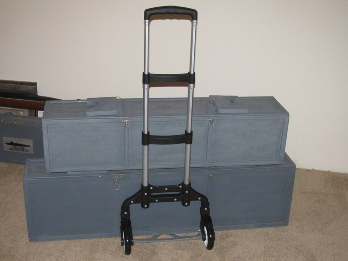

                  Monday 10:30am, I was at the post office and there it was.
                  Currently sitting in living room nest to the two boat boxes.
                  Delivered in 4 days.
                  More photos of boat launcher

                    Thank you for taking the time to draw these up Greg, I am going to build one. It was great meeting you! Randy
                      • 364
                      I drew it up a while ago at Big Daves request.
                      It has gotten a lot of use and has been to Carmel more than me
