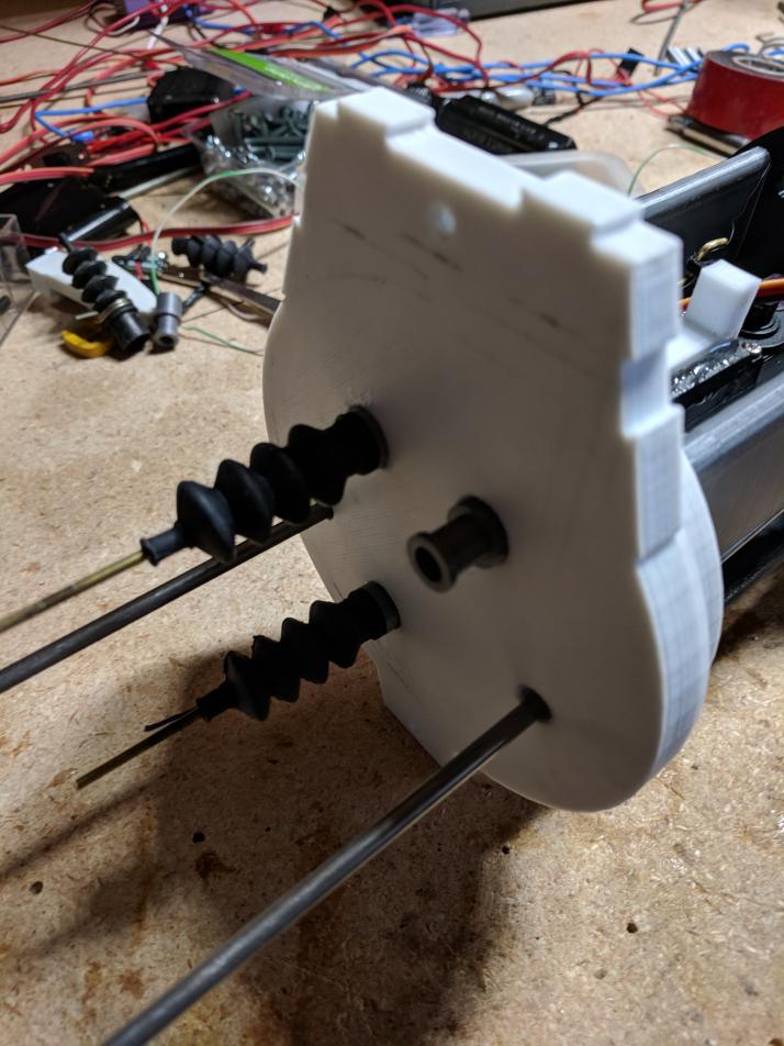

    Just thought I would share my Robbe U47 Tech Rack build. It is still setup as a dynamic diver using all the out of box hardware. Same motors, batteries, etc. Been fun to design and so far waterproof. It is designed to be modular so I hope to turn into a static diver over the winter. Have to get the rest of the sub done first.
    Glad I got back into this hobby. Having fun so far. Hope to see you all in SF.

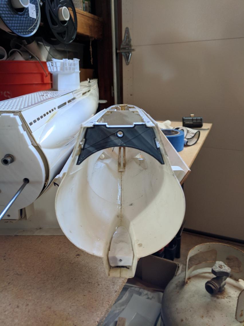

    UPDATE: Fixed lower support size. My Robbe U47 Tech Rack. This is a redesign of the tech rack using all the same hardware as used in the basic dynamic build. I never liked the one you build with the kit. Flimsy, parts breaking, leaks. The new design has been 100% leak proof so far. Most of the electronic shelves can be printed with low infill, but i recommend building the endcaps, servo tray and engine mounts at 85% to make them stronger. Also on the very end cap, I brushed on a thin layer of epoxy to make extra water proof. Also the original plans called out for 2 6V Batteries, so If you are using those, print two of the battery trays.I used 4 pieces of 8-32 threaded rod to put it all together and 4 nuts.I am currently building a couple parts so that the rear of the sub can be unscrewed to do maintenance. Never liked the epoxy and run it til it fails way. Enjoy, I plan to turn my sub into a static diver over the winter after I get all the cosmetics done. ;)UPDATE: Just added optional support brackets to be able to remove rear of sub. Also posted my bellow adapter and magnetic link

      Not yet, wiring today. Posted optional mount attechments for connection stern to rack without gluing in place. Also a quick bellow adapter.
