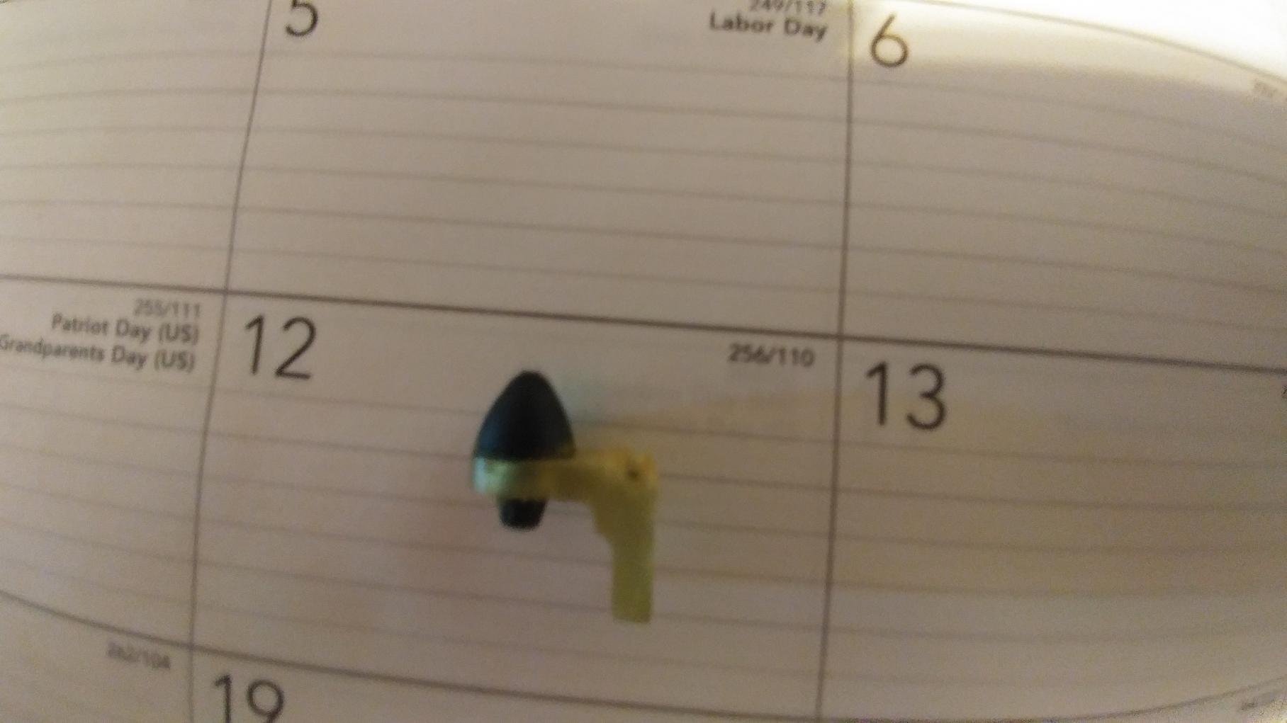

    I am at odds with my SWM Blueback WTC. It has an approx ¼” hole at the top where the water enters the ballast tank. I’ve destroyed the original o-rings so that’s out. I cannot find anything to make this water tight until I open it with the servo. I am thinking of a ¼” conical washer to make the hole smaller, thus helping with the watertight integrity. Is there such an animal as this washer? Or…..does someone have a gently used SWM Blueback WTC that they would be able to part with???? Or just the ballast tank section……..

    Has the top of ballast tank been damaged? If not damaged, the original o-rings can be replaced.
    If you can post a photo or 2 of what you are describing, we can probably help you to get things fixed.

      The first pic is the original configuration.....second is what the internal part looks. The WTC is not damaged.....Click image for larger version

          Perhaps one of these may serve as a replacement:
          The Skinner Company manufactures and sales emergency pipe repair clamps
            You might want to consider making something that uses conventional o-ring seals, which are not bespoke and readily available.
            Have a look at SCR Issue 42, page 28-30 showing Greg Sharpe's design.
            Failing that, if you have a lathe, you could machine a cone type holder( metal plastic etc.) that uses a fat o-ring for the sealing part.
            Another alternative would be get in touch with Tom Chalfant, as I understand he has the tooling for the SWM WTC's, perhaps he might be able to help you out.
              Maybe you could mold yourself one with silicone rubber.

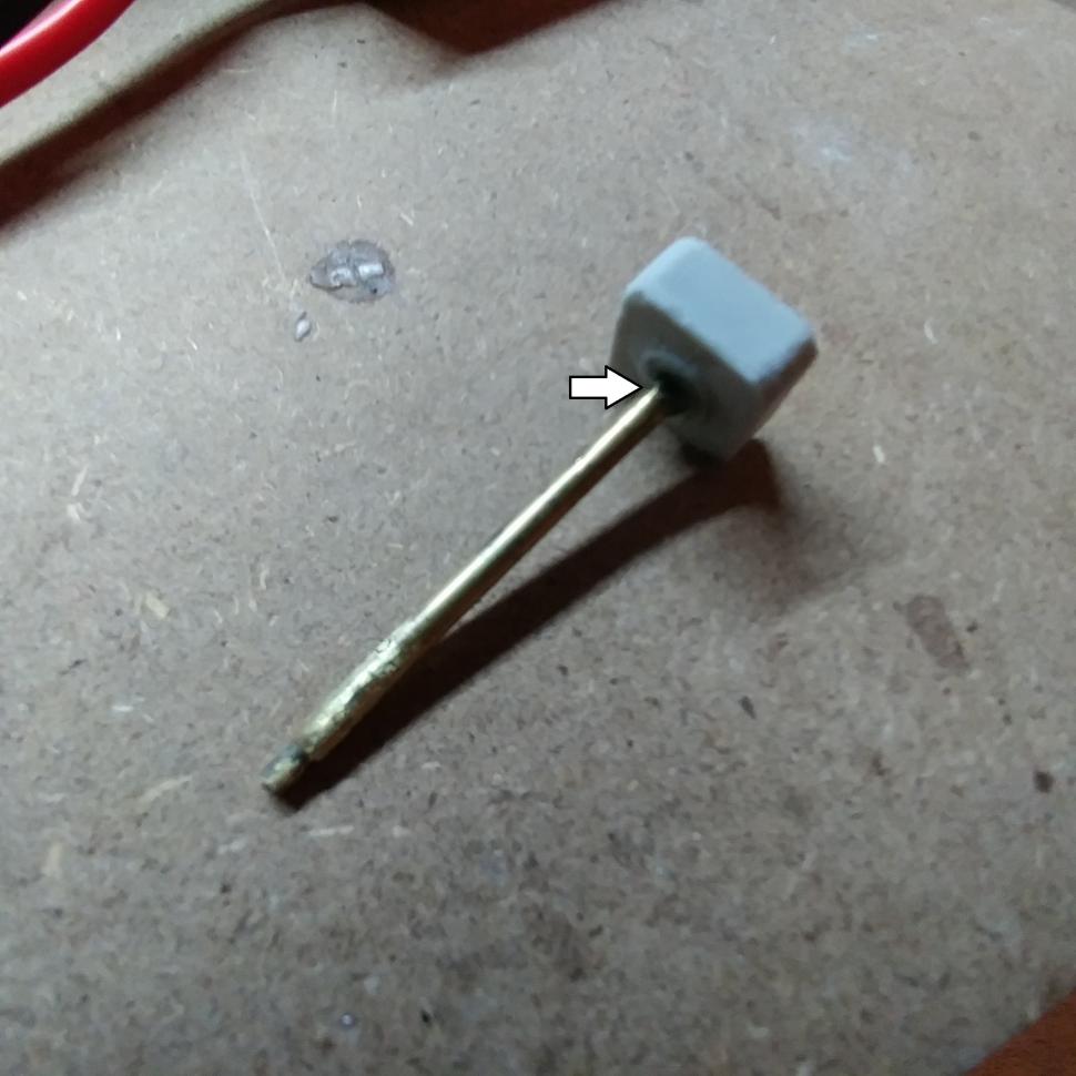

                    It appears the Achilles Heel for my ballast system on this thing is the attached photo. The servo horn some times twists freely and causing the cams not to activate the Propel tank. I've used Gorilla glue and my model super glue to hold it, but after awhile it breaks loose.....The arrow on the photo shows where I need to glue it. Any suggestions? Click image for larger version

                      Does the metal rod go in to the foam block?
                      If so, maybe a groove could be ground in to the rod that would allow glue to get a grip and hold the rod in position and not let it turn.

                          To address your last issue first, I drilled a tiny hole through the side of the resin block and the shaft, then glued a tiny piece of wire through the hole. That prevented the shaft from rotating in the plastic block.
                          As to the rubber plug not fully sealing, before each run I push a bit of silicone grease in the hole on top of the ballast tank to seal the rubber plug. Not the best, or a permanent solution, but it's been working for me for a decade or more.
