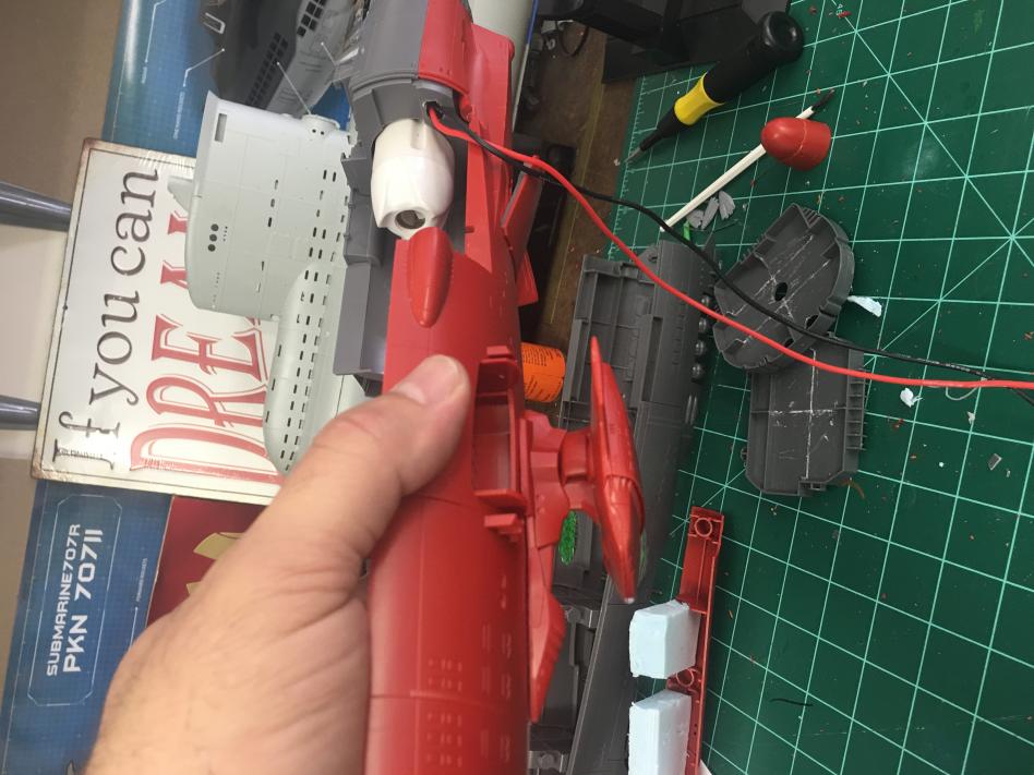

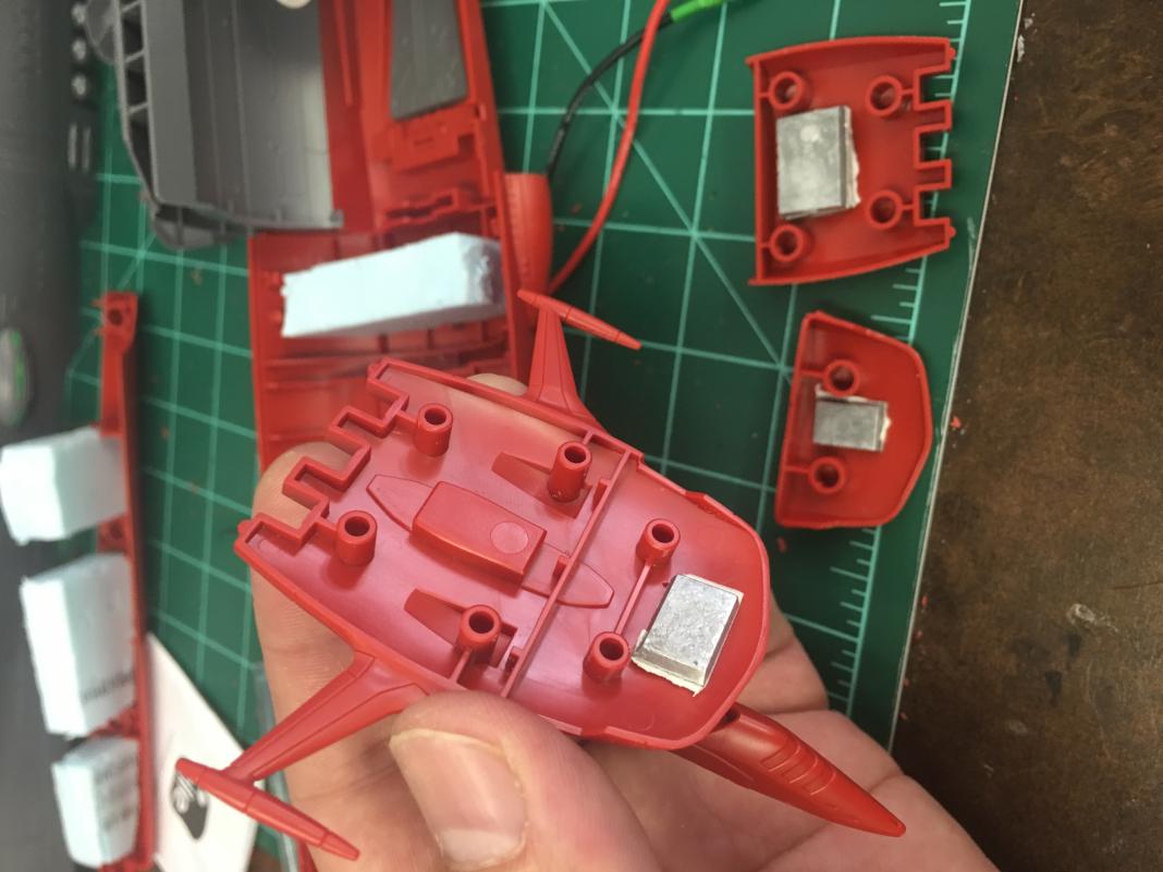

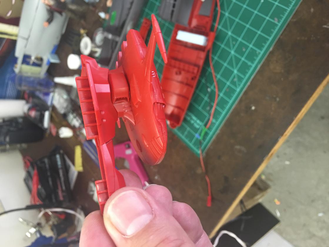

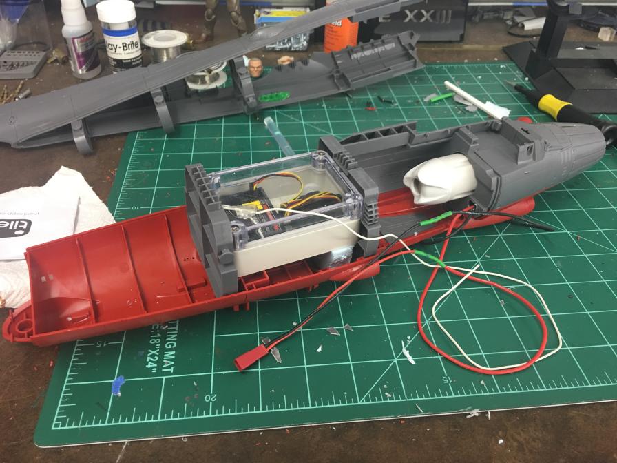

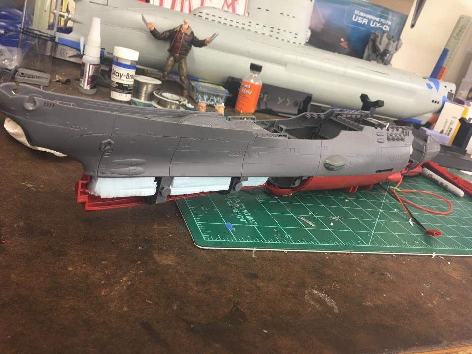

        Here's a brief look at some progress. These show how the ballast will sit as low as possible in the dead center of the ship. However it doesn't mean that I have the bow and the aft done correctly. I'll be tinkering with ballast vs floatation for a while I'm sure but until I have all the required gear in place I can't close it up and test it so I'm doing my best guesses until then. I'm also currently working on setting up the thrust vectoring controls which have been less tricky than I thought. Cross my fingers as I'm not done yet right. PS My apologies for the rotated images. They weren't rotated when I uploaded them.

          Are those foam chunks I see low down in the bow in the first photo you posted? If so, just watch your trim, as foam low is going to create static instability and could make trimming your boat somewhat tricky.
          • cdivine
            • 166
            Thanks Bob. Yours is certainly highly appreciated inout. I love watching those builds you do. I still plan to buy once of those salon kits so keep one on ice for me.
