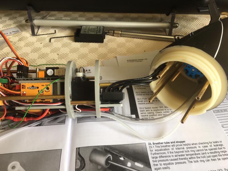

                #37
                Receiver
                It looks like you may have removed the receiver housing...any reason for this?
                • Antoine
                  • 447
                  #38
                  Yup, the Rx I had in stock was a little bit too big. I had to remove the housing to install it inside the sub
                  http://forum-rc-warships.xooit.eu/index.php
                  • Oldus Fartus
                    • Jul 2016
                    • 185

                      #40
                      How did you get the antenna wire thru the long plastic tube?
                        #41
                        For my Engel Type 212 I temporarily glued a thin wire to the end of the antenna. After pushing the wire through the tube I then gently pulled the wire which, in turn, pulled the antenna through the tube.
                          #42
                          This is what I did.
                          I used a length of small piano wire to push through the plastic tube.
                          I glued a piece of strong string to the wire and pulled it through.
                          I then made a few turns and knots on the antenna wire.
                          Using the string I pulled the antenna through.
                          I tried to glue the antenna wire to the piano wire but that failed.
                          The string is just strong thread.
                          • Oldus Fartus
                            • Jul 2016
                            • 185
                            #43
                            This is what I did.
                            Thread worked.
                            Thanks!
                            TechRack complete.
