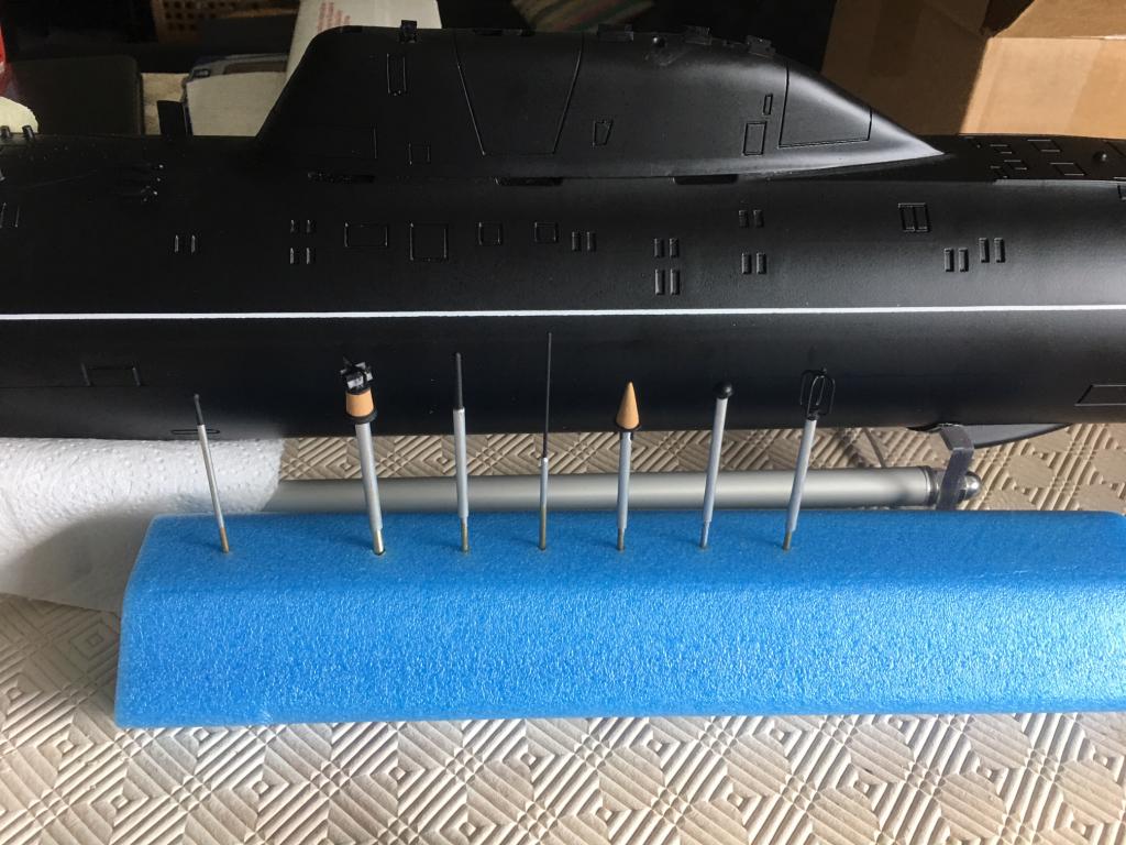

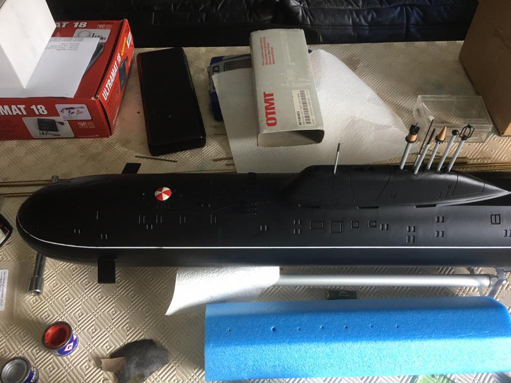

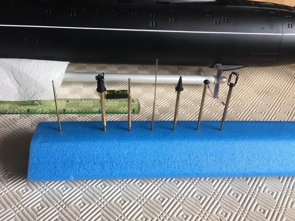

    Day 5.

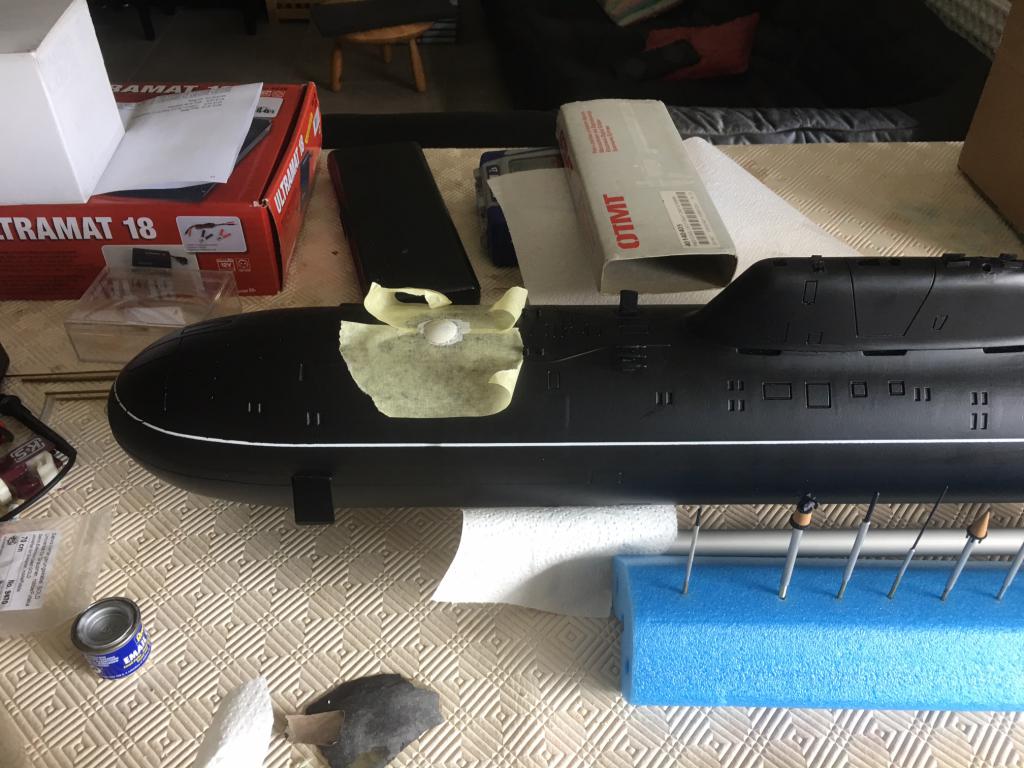

    Beginning of the paint job, the aerials first. I chose enamel paints for this, alu, black and brown.
    Like I wrote previously, I seized the opportunity to turn a periscope. I used my "handmade lathe" for this job, aka my Dremel.
    Painting of the emergency buoy. It is certainly one of my worst paint job but being temporarily disabled, I could not drive to my shop to airbrush it so I used enamel applied with a brush. I could not thin enough the paint otherwise the masking tape would have been ineffective. Anyway, I'll do it again when I fully recover.

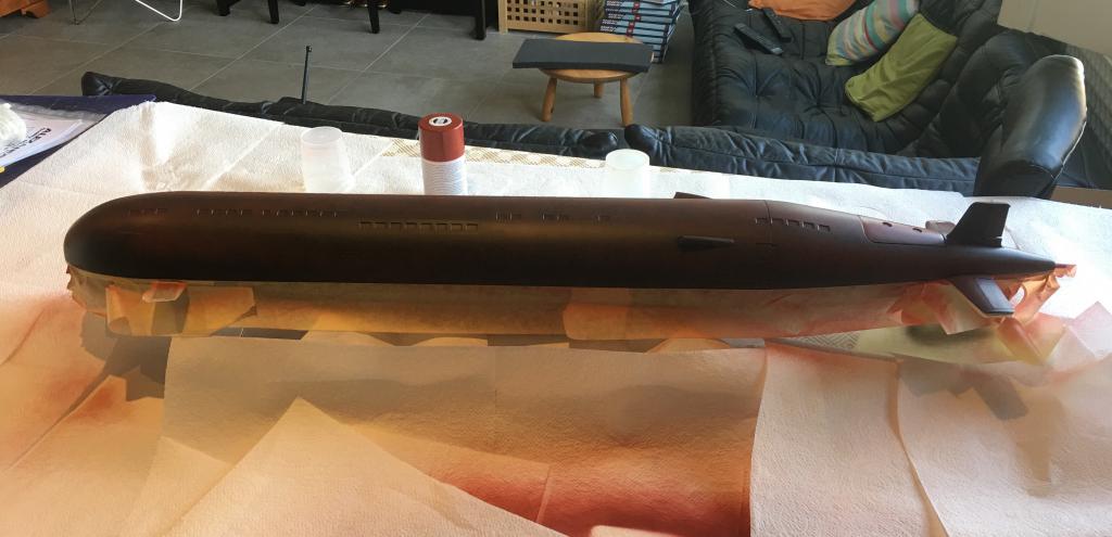

      Day 6.

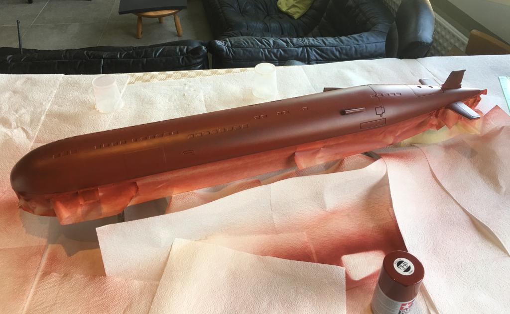

      Hull masking for the red anti-fouling. I've always liked the russian subs with their red paint, it's the reason why I decided to depict the Akula this way.
      I use the TS33 Tamiya spray paint, it is the Dull Red reference. I made a test before applying it all over the hull after having seen what happened on Ralph's model. Thanks (and sorry) Ralph ! ;-)
      I think it begins to look quite good, doesn't it ?

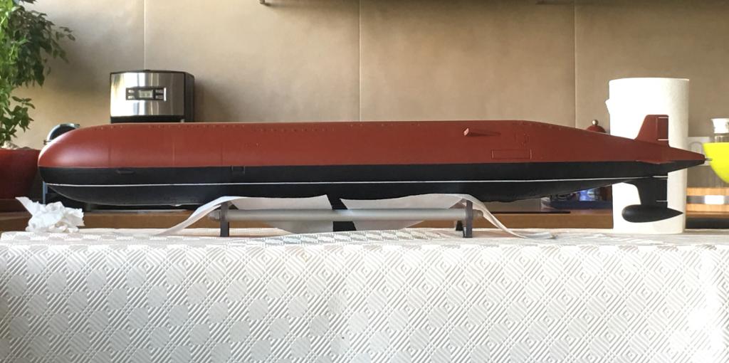

      • Antoine
        • 447

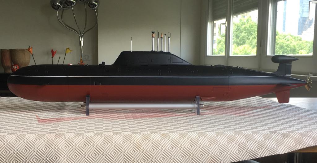

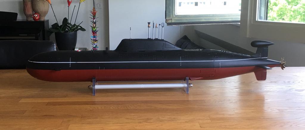

        And here is she with the depth markings. It's almost done, it just needs a clear coat (mat) and trimming in the tub when I can walk again (hopefully in few months).
        To conclude, I must say that this kit was the perfect project for my current condition. I enjoyed building (assembling ?) it with no hassle (thanks again to Ralph without whom I would have had more difficulties to finish the model).
        I can't wait to show it to you in the water but it won't be before august I think.
        I strongly recommend this kit, both to the beginner and the experienced builder. The little mistakes made by Engel (wrong prop, shape not 100% accurate) are quickly forgotten when you see the finished model.
        If it runs as well as the 212 does, I'd give a 4.5 stars (out of 5 ;-)) to this kit. I only anticipate a poor turning radius due to the size of the rudders, the 212A will keep this advantage for sure !
