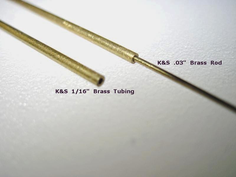

          Another thought would be to use a brass tube that stays in the casting. The brass shaft will
          slide into this tube. Glue the shaft to the tube with silicone and it might be adjustable or removable.

              Ahhh....Tom, what I do for dive plane components where a rotating shaft needs to go through is to cast a brass tube that has an I.D. that is (essentially) the same as the O.D. of the rod in the moveable part. This may be the same idea that Scott suggested.

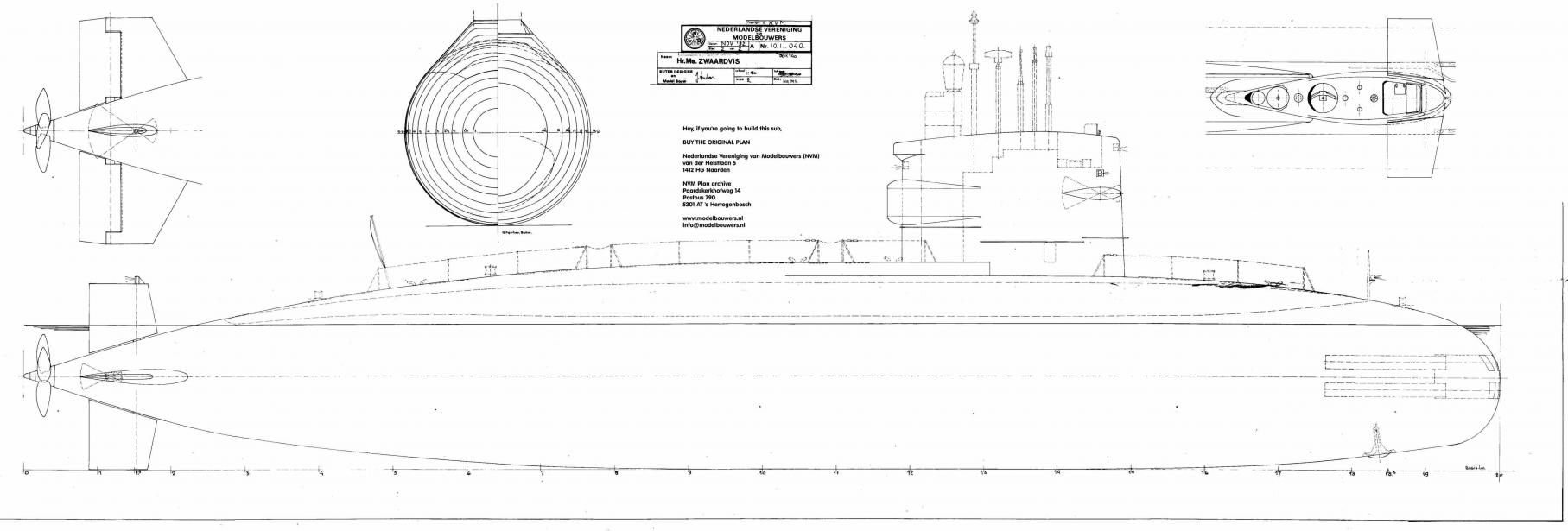

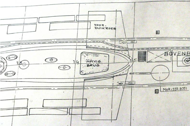

                    I have another issue. The set of planes I got did not have the sail planes. So, I venture into a new world of fabricating them.
                    Although in research, I have two plans:
                    This one shows a more modern sail (with exhaust diffuser)
Name:	Walrus Plans_003.jpg
                    And the ones from the original design:
Name:	Walrus Plans_004.jpg
                    I can find pictures of the original design, but many photos look like the first photo. Can anyone shed some light on this? Was there a change in sail plane design?

                      Looking at your two images, I think the bottom one is closer to the real planes except the front angle may be too much.
                      The front edge does not look to me as if it is straight like the top image but not so angled as the bottom image.
                      Maybe the shadow will help.
                      The rear edge appears to be straight i the photos I have looked at.

                        Thanks Ralph. I agree it is hard to find definitive answer. Your assessment is where I am, is the bottom plans (which are from original plans) too swept back or are the newer sub's planes more like the top image? Or somewhere in between? Or the bottom plans accurate? Or.....well you get the idea.
                          The Walrus class had four boats built.
                          Last one, launched 1994.
                          The replacement for the Walrus is not scheduled until 2025.
                          So, thinking that a "newer sub" might have different sail plane shapes does not look likely.
                          I have found both drawing that you have as a reference.
                          Not sure of the source for the top image, though it comes up at various sites as a building drawing.
                          The bottom image is from a 1/350 scale model plan.
                          No real information to use.

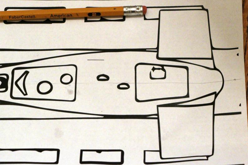

                              Different class of boat, but a lineage to the Walrus which may help.
