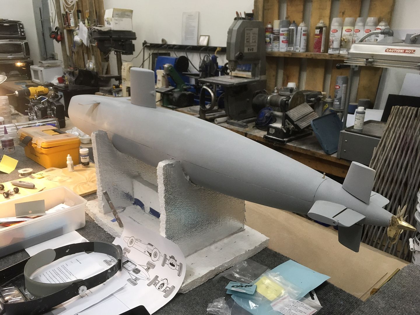

    Work so far. All appendages attached. Prop and shaft installed. Hull cut and fitted with one lock down screw. Sail bolted and can be removed.

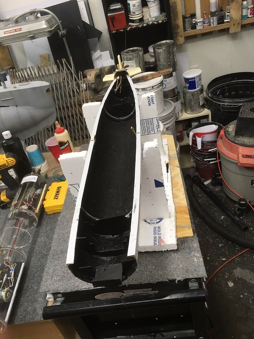

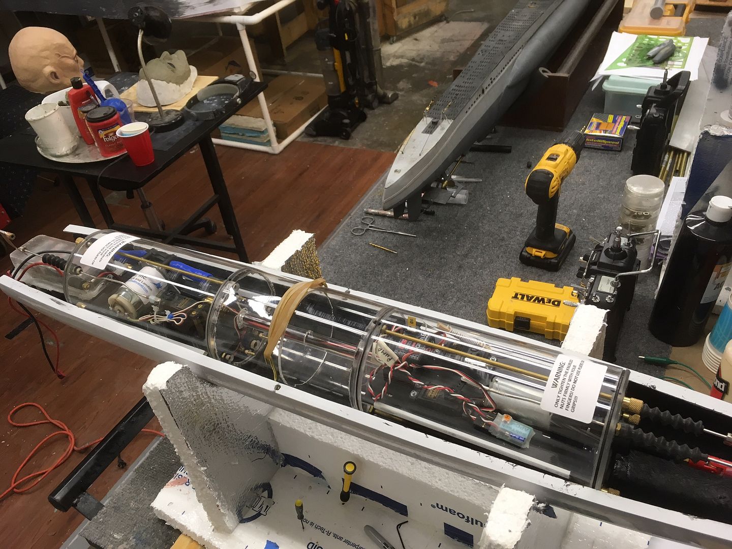

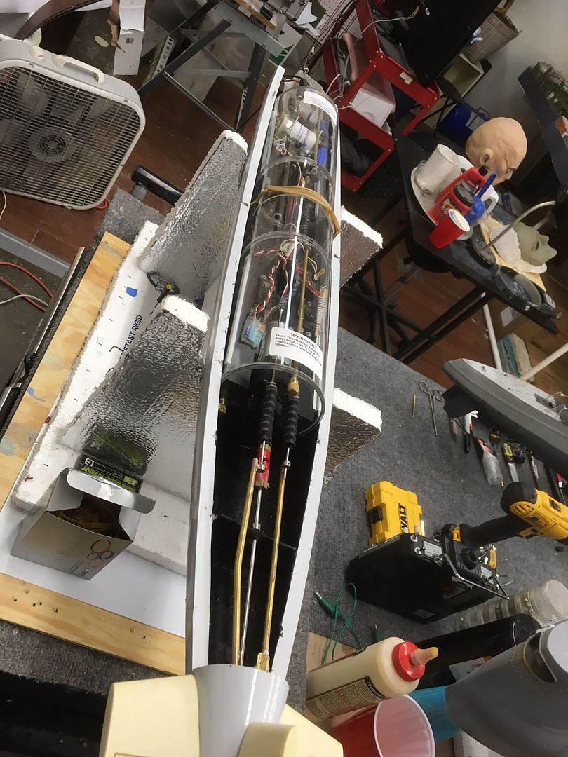

            It's been awhile but I have been working on Steve's boat. Getting all the hardware installed and running first before the fun stuff. Well it's all fun isn't.

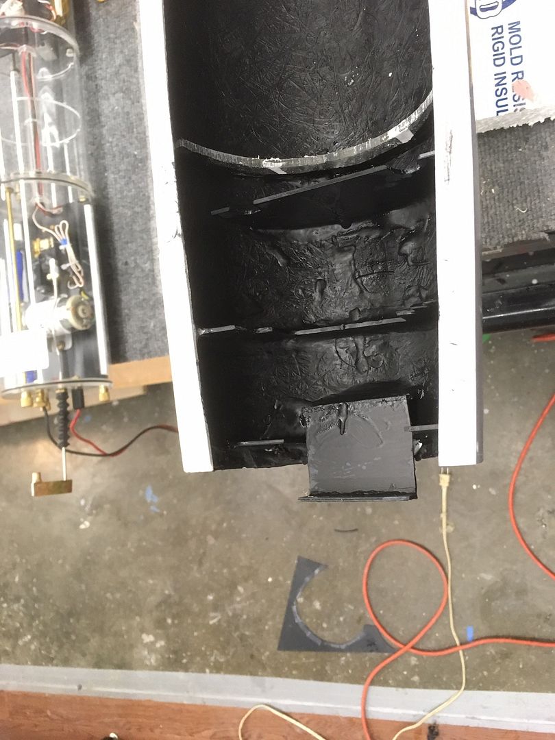

            Many built heads, some to support the cylinder, some to keep it from moving forward and back or rotating. Others to effect a battery tray so it stays put.

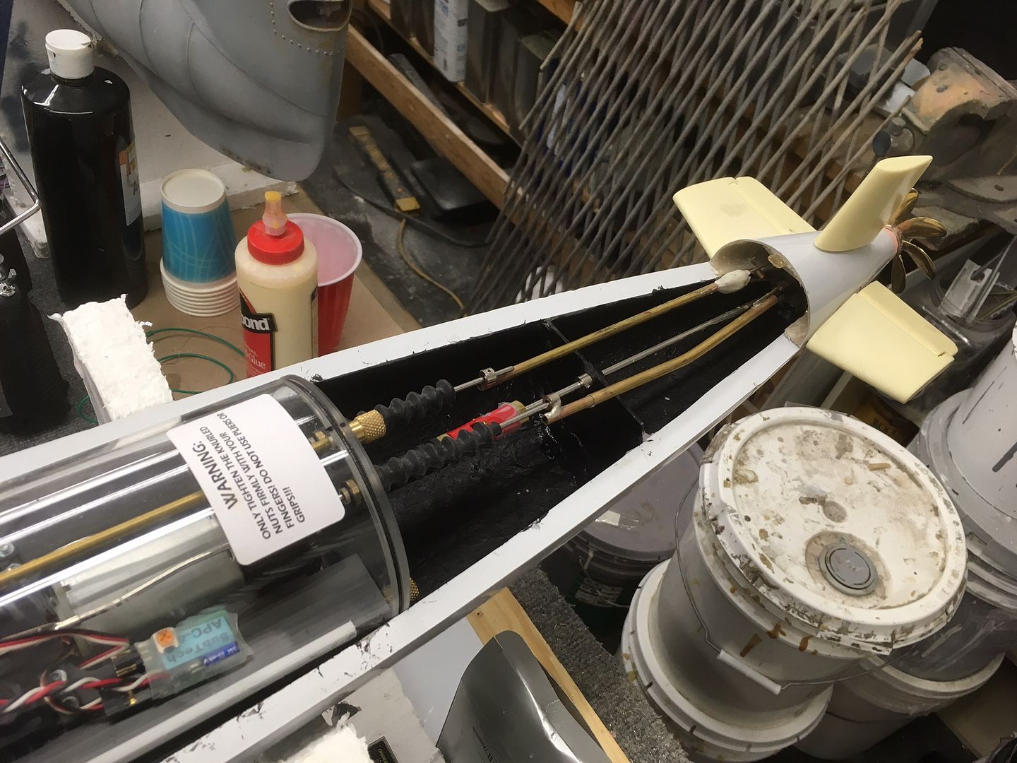

            What isn't shown here is the tricky bow planes hook up which consists of two magnets that when the top is put on magically connect so we have bow planes. Took some head scratching but it works.
            Now to move on to drilling drains, gaping, putty, the sail and masts. Let's make it look like a boat time.
            Oh did I say everything works? Well it does thankfully. Never easy to build an RC sub. Right?

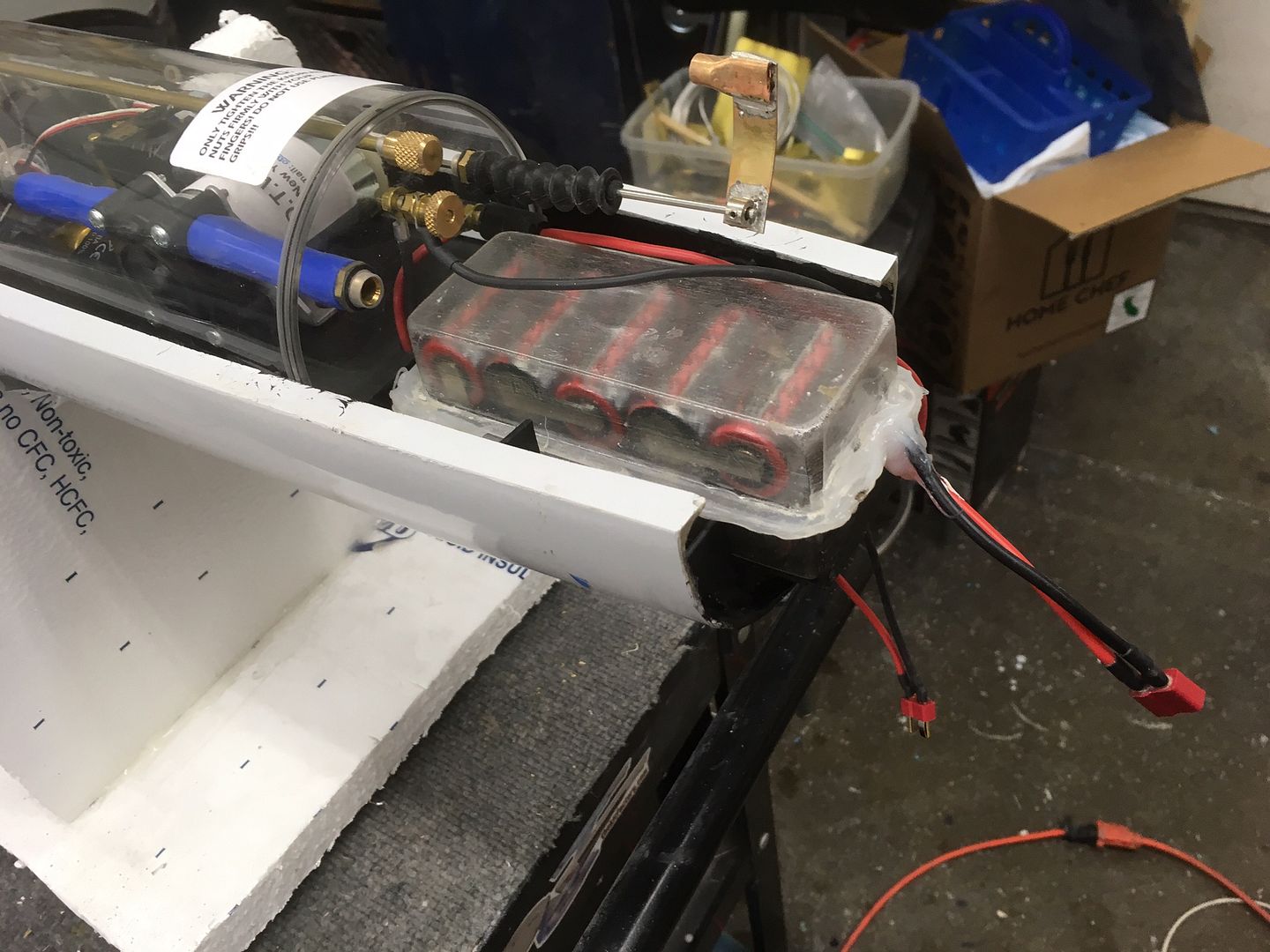

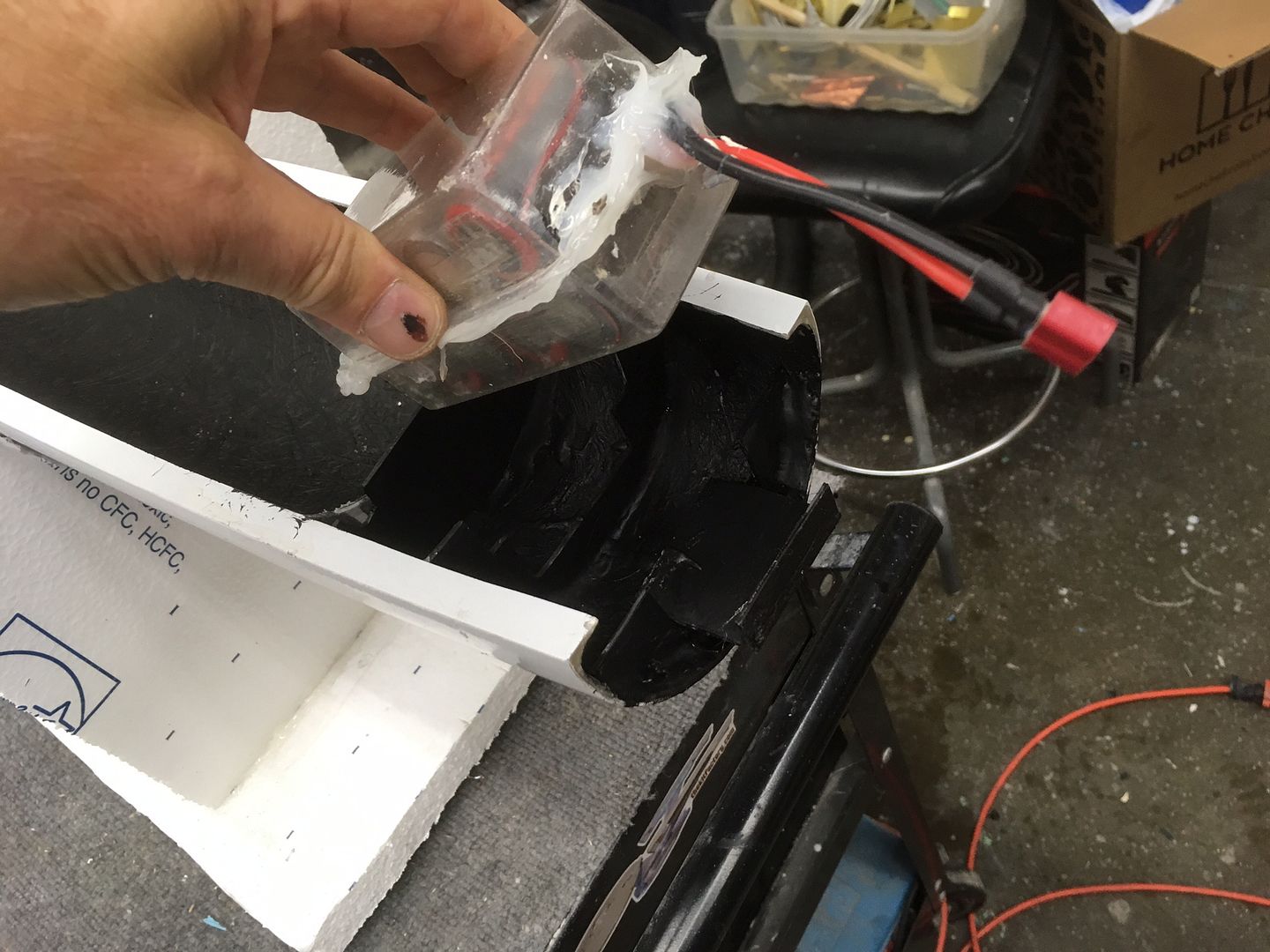

              Steve,
              What have you done there with the battery?

                  Vacuumed formed water tight box Matt!

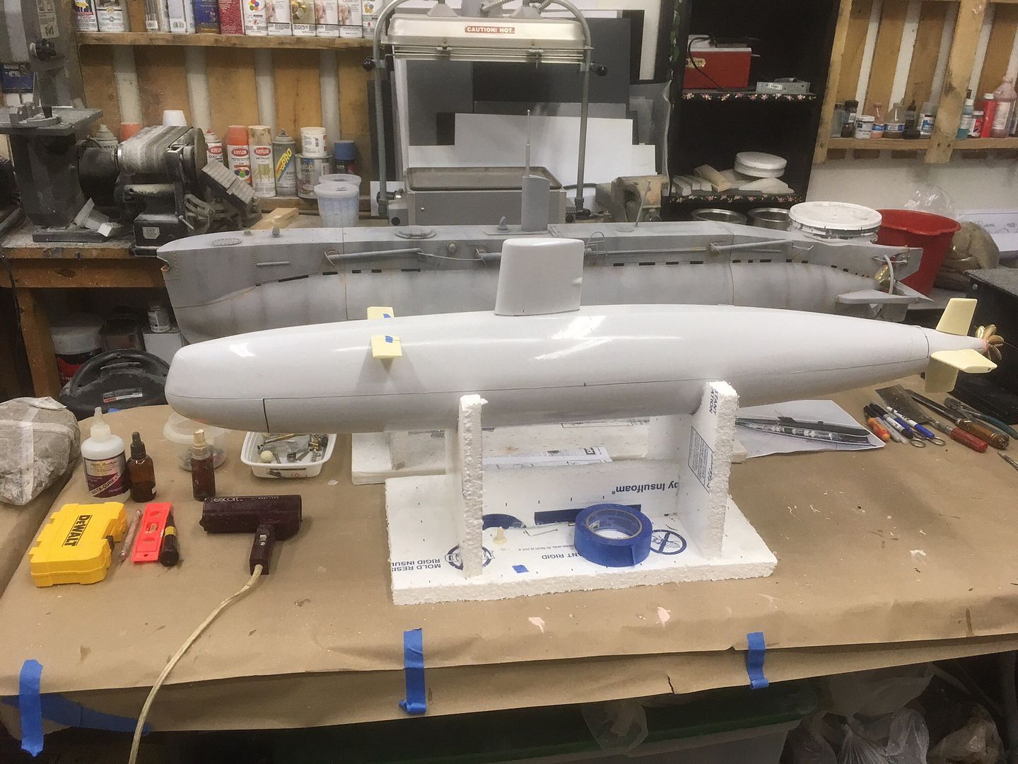

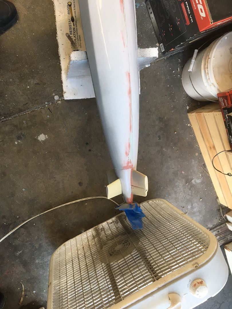

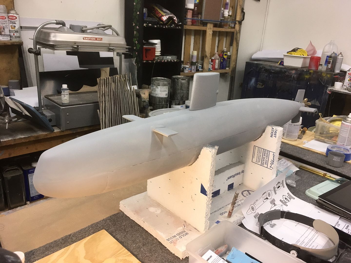

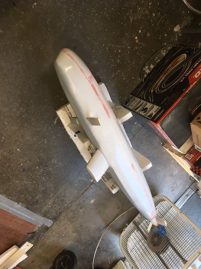

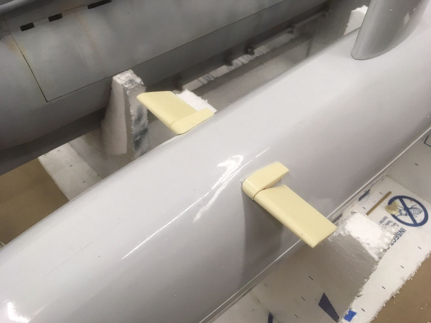

                        Lots more done. I had some issues with the sides of the hull matching up exactly on this casting but nothing I have run into before with any kit. Sometimes I just leave it if it's an old WW2 rust bucket with a heavy weathered pain job. It just doesn't show. But with a new modern sub I blend it with putty. This hull now hits perfectly and true. Put a coat of primer on it and now I can see where all the bad stuff is still to fill. One more pass ought to do it.
                        Next up to drill drains and openings in the sail. This is a really nice build. Love OTW kits as they are robust and well laid up.
