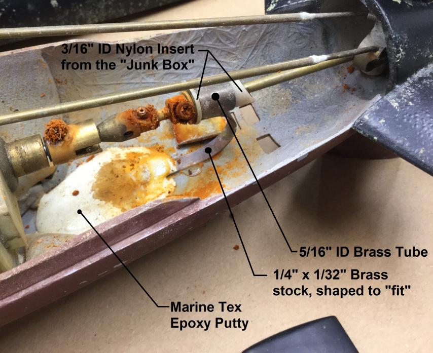

                                Unfortunately, I'm kinda wrapped up on the BLUEBACK (literally) as its boxed and getting ready for transport.
                                BUT, it's simple enough to see from this picture:
Name:	Reverse thrust bearing.jpg
                                Can't help with a source for the Nylon bearing itself, as I pulled it out of a junk box. But a flanged Rulon bearing from McMaster Carr and appropriately sized brass tube would be better anyway.
                                After I silver-soldered the brass tube to the 1/4" strut, Inserted the bearing. I then of course I bent the strut to shape. Assembled EVERYTHING and made the final adjustments.
                                It was only at that point where I was satisfied with the fit and rotation of the shaft did I apply the Marine Tex to permanently mount the strut while everything was assembled. Just remember the LAST step is your mounting compound AFTER assembly!
                                Marine Tex is another great crossover from the Marine Boating Industry that I happened to have lying around. It's a bit pricey and JB Cold Weld would do as well. But I use the "Tex" on larger jobs as it lends itself to those applications.
                                Marine Tex
                                Available at Ace Hardware ($$), WestMarine ($$$) etc.
