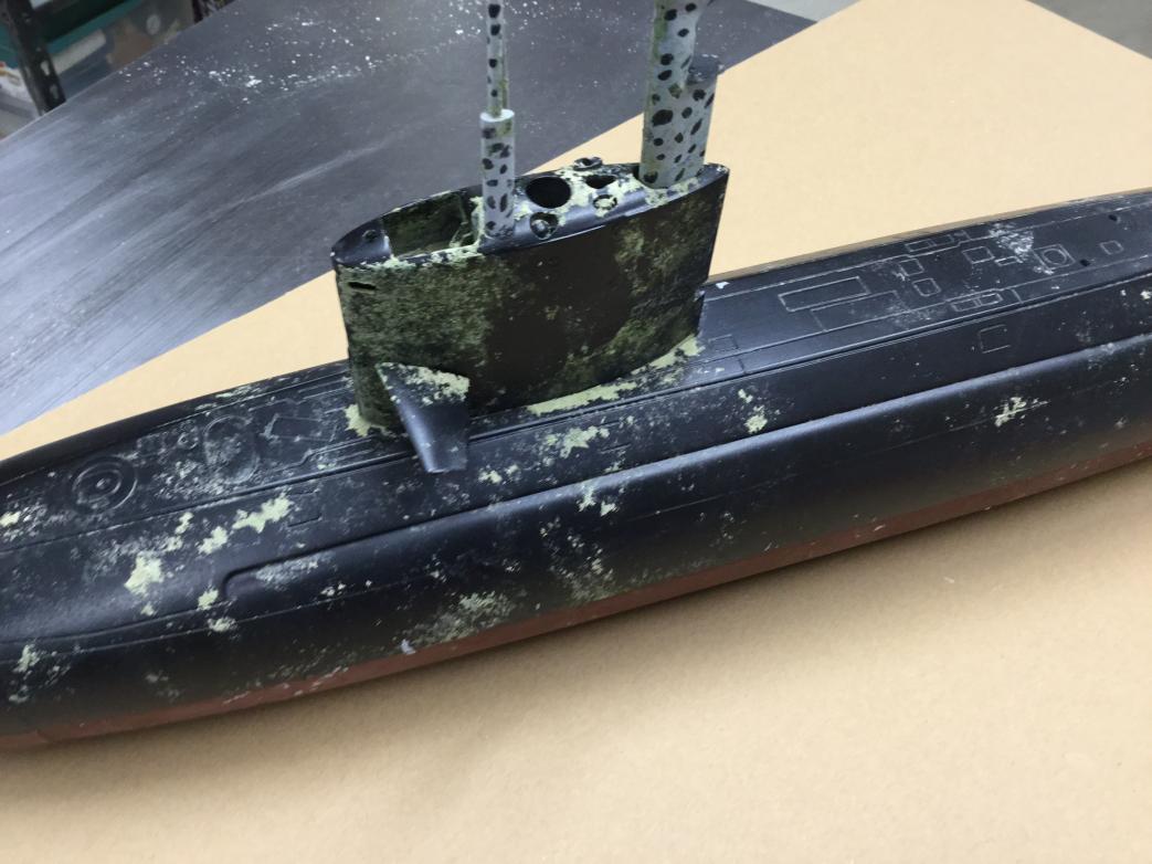

    After sitting submerged in some 8+ feet of water for 59 day's,the USS BLUEBACK has been recovered.
    This 1/96 Scale RC Submarine, manufactured by the now defunct SMALL WORLD MODELS (Dave Manley) was lost on Patrol September 10th 2016 while undergoing refit sea trials.
    This mostly stock model had some major repairs to the WTC including a shaft seal replacement.
    While at first indications to the cause of the loss may have been attributed to the repairs, it is now pointing to human error.
    Ballasted to heavy for an empty propel tank, followed by NOT insuring the tank was full prior to departure.

    The Blueback was officially recovered at 8:10am this morning from the Sub Base.
    She was immediately transported to a secure shipyard for inspection.

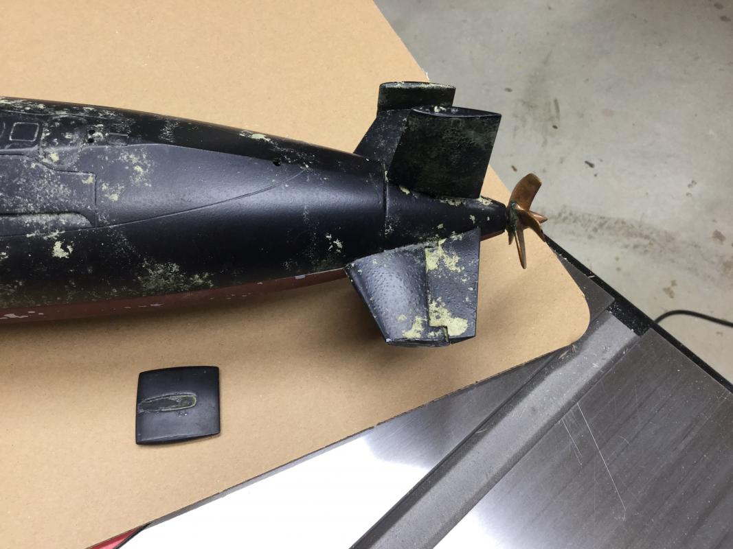

    The square plate on the outer edge of her port rear dive plane was broken off but recovered. (This suggests damage was sustained in the front seat of the base pickup truck.) however, repairs are simple.
    The outer hull had areas of algae growth but was otherwise in good condition. The scopes are fine.

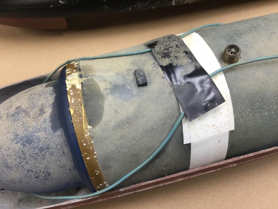

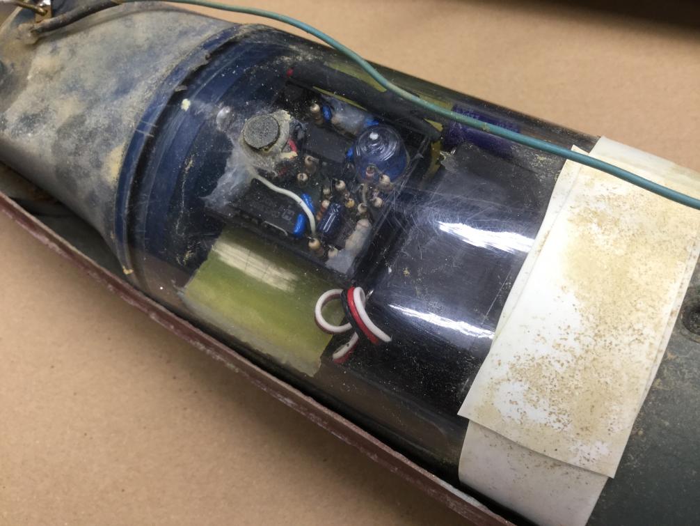

    The WTC was completely obscured by algae. After careful cleaning in one area it was determined that there was NO VISIBLE MOISTURE PRESENT in the WTC. The reactor core was not compromised .
    It should be noted that the high pressure air system (Propel) was completely empty. This discovery will, unfortunately, precipitate a board of inquiry regarding the fitness of the Commanding Officer at the time of the incident. Court Marshall proceedings may soon follow.

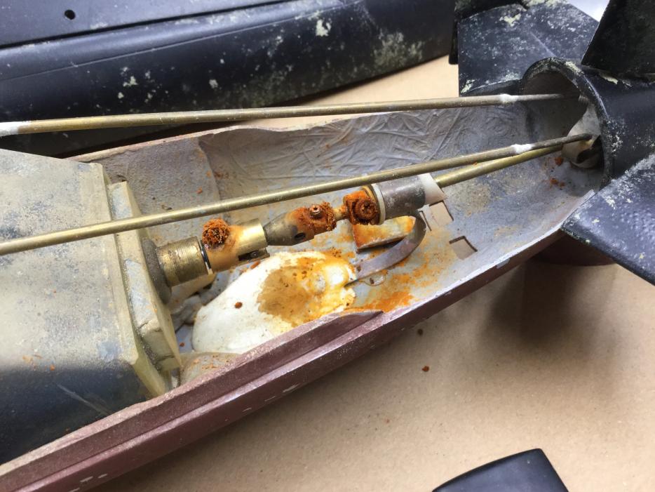

        Stock Dumas type dog bone U joints do not come with stainless set screws.
        I always like to replace them with stainless. Good luck getting it out.
        BTW That is the largest rust outcrop on a set screw I have ever seen.

                    Curious why there's algal growing on the surdace of the WTC when it's inside the hull where the sun doesn't shine...

                      Steel set screws in brass or bronze.
                      Spray with Liquid Wrench twice a day for two to three days.
                      The brass or bronze will let the liquid wrench penetrate and the steel screws will break free.
                      Use steady torque but not enough to crack the set screw.

                          Dave,
                          They ARE stainless, in fact look close at the center one.
                          Now's it's a question of type. I was fairly sure I purchased TYPE 318 SS, which I used exclusively on all my 1:1 scale Sailing vessels.
                          I had in fact noticed some streaking even on them, granted it's a harsher saltwater environment.
                          I do purchase exclusively from McMaster Carr, but you never know what's actually tossed in the bag w/o testing. I see fake components (can you say China?) all the time in the PCB Assembly industry.
                          To be honest, and what I suspect, this man made lake has pumps, which we see by heavy glitching in certain areas.....AND I remember someone once saying it has a minimal chlorine content for harmful bacterial control, but that could be rumor.
                          While I'm sure the electronics are properly insulated to code, as statistically fresh water swimmer electrocution is much more common and deadly than saltwater swimmer electrocution (saltwater disperses the energy while the human body in freshwater becomes the conductor due to the higher resistance of fw) even MINOR electrical currents can create galvanic corrosion. I will NEVER swim off a private freshwater dock that has power REGARDLESS of the owners claim to safety.
                          Again, I could be 100% wrong here, but those ARE stainless, do it on all my boats. I could say low oxygen level affecting the passivation, (we see it on SS shafts in the shaft housing that aren't regularly inspected) but that usually is crevice corrosion and creates pitting, takes longer too.
                          Also, why on the shaft, and NOT back on the rudder stock to the right? Is there some circuit still via the shaft to the internals? Got me.

                              Stainless! Wow!
                              But there is stainless and stainless. As you know.
                              I get mine from McMaster too. I was buying some for a while from them that would strip out easy.
                              The ones I use now do not. Never had them in the water as long as you to see a rusticle like that.
                              I usually add a drop of Stuph or Corrosion X to the outside to protect it too.
