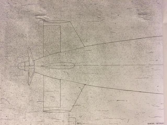

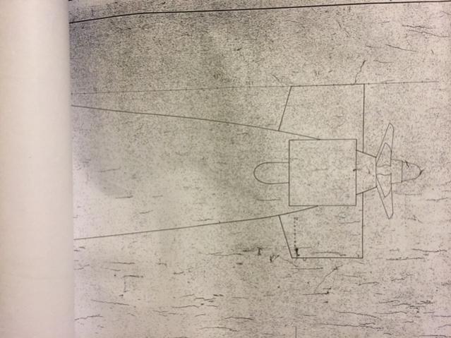

          see if these will help Erich I won't post any dimensions because my plan is in 1/80 scale not 1/96
            Greg, I have looked at your images.
            I can scale some numbers for these drawing with a little information.
            1. Greg boat ..What is the overall length of the hull, bow to Tail Cone? (not including propeller hub)
            2. eckloss .. what is the overall length of your hull, bow to Tail Cone? (not including the propeller hub)
            Max diameter of the hull would also help.
            These numbers will give me enough to figure the scale of the two images and them get the numbers for the correct scale.
