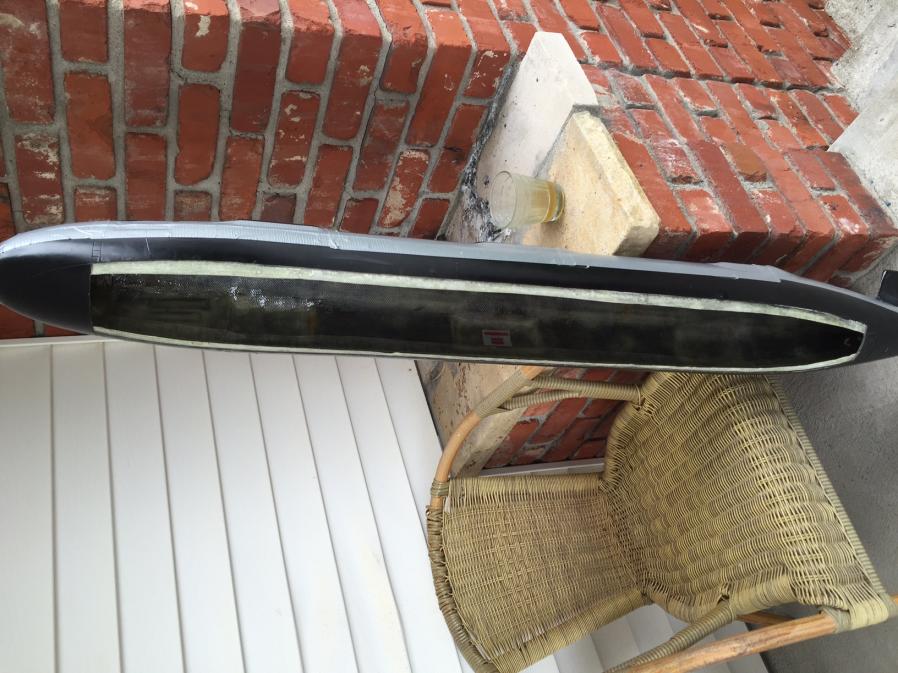

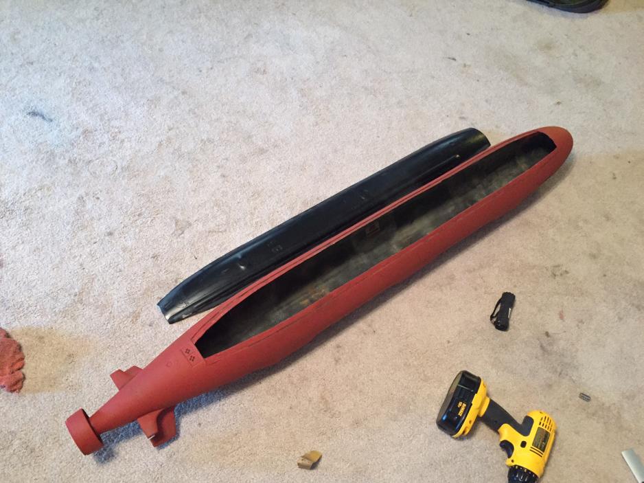

      I've got the two halves joined together. enough for today.
ID:	129405Click image for larger version

        Nice job. Looks like the waterline cutting went well. Sorry for the cross posting Erich.

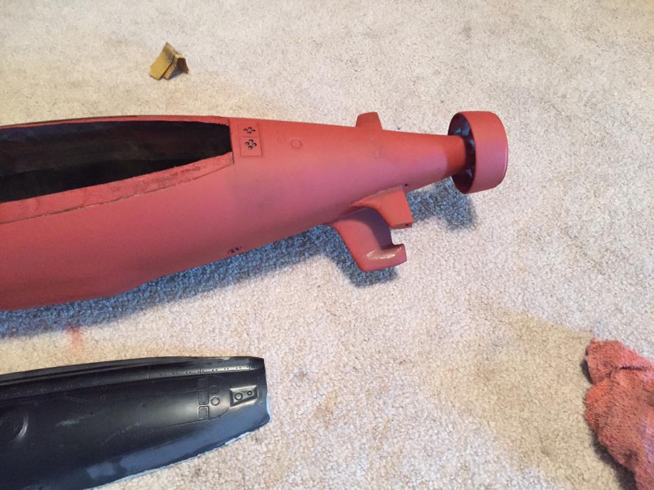

          got the seam smoothed out and ready for first primer

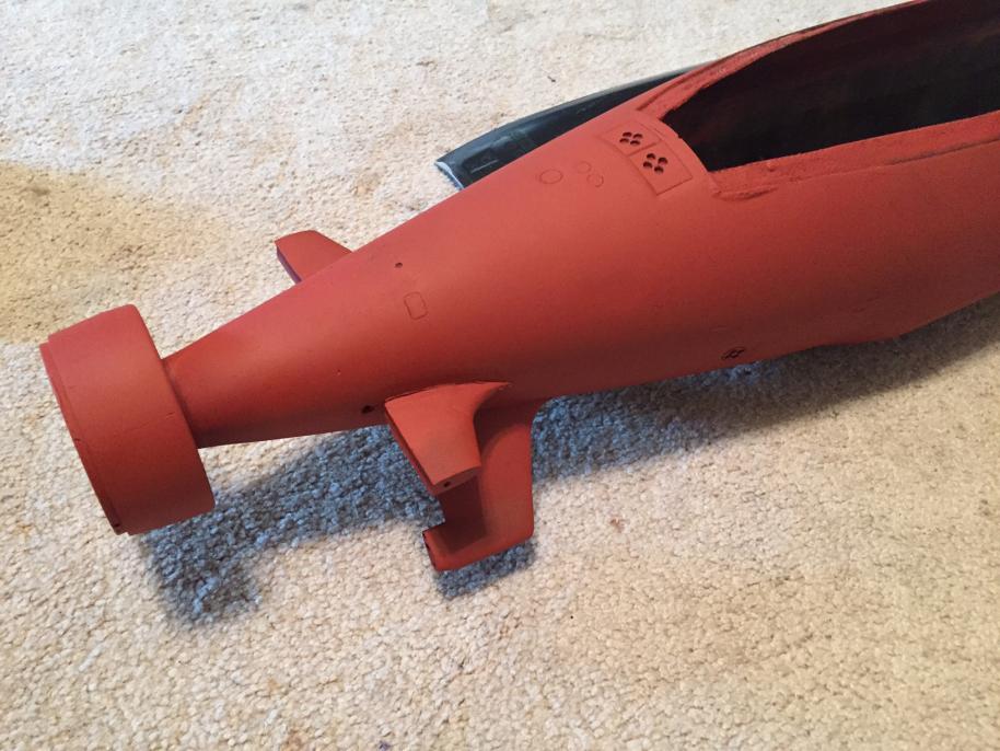

            getting a little more work done
ID:	129439Click image for larger version
ID:	129440Click image for larger version

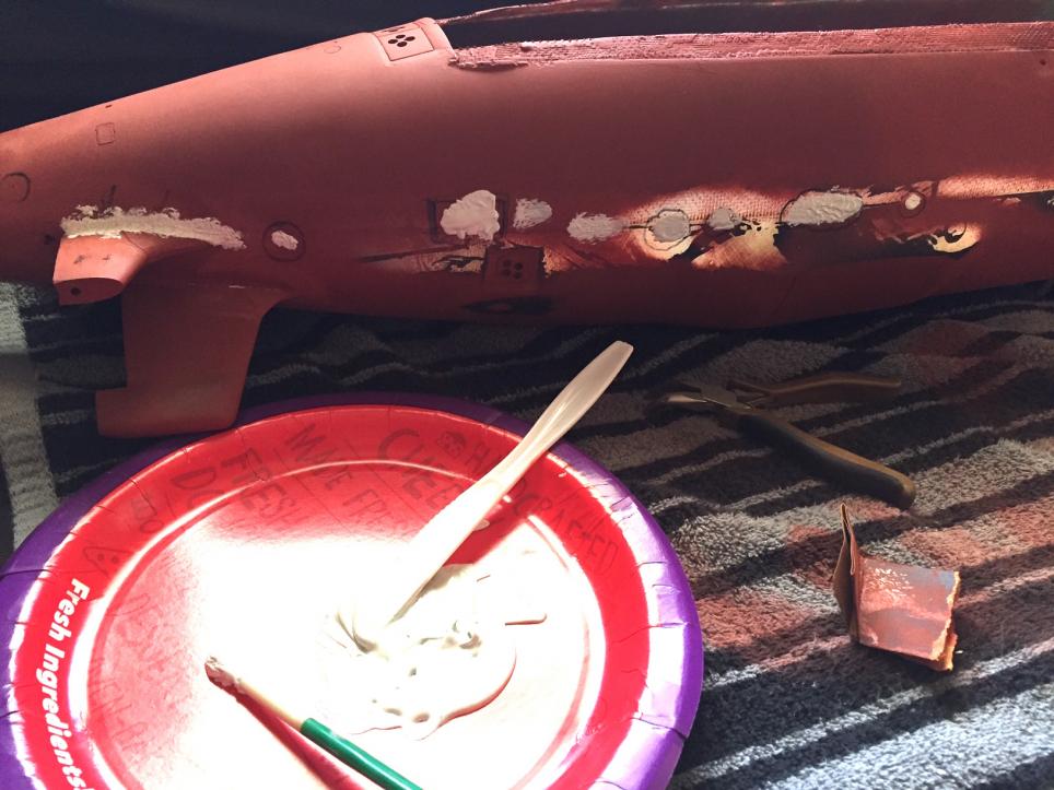

                        Today is just filling in the pinholes and such
                          • 2349
                          What are you using as a filler? Is it just straight Bondo or something else?
                            Bondo for the larger pits, and nitro stan for the small scratches and pinholes
                              #29
                              I'm running into a real problem. Yesterday I used Nitro-Stan to fill the small crevices along the seam. It dried, I sanded, I primed, and all looked good. Today, I've been chasing after some of the larger holes with Bondo. After I've filled and sanded, I throw on some primer. I left the hull in the sun to dry the paint. it's about 90+ degrees today. The heat pushed the Notro-stan from yesterday up through and out of the seam and left raised dashes all over the hull. Now Ive had to re-sand them, dig them out a bit, and refill them with bondo. Frustrating.
                                • 1479
                                #30
                                Erich,
                                Use Nitro-Stan very sparingly and only in paper thin applications for best results. It is not intended to be used to fill anything but the most shallow blemishes. It does expand quite a bit when exposed to heat if it is applied a tad too thick. Most spot putties are that way. Your other of method of using bondo to fill the crevices is the best way to go. You can feel free to fill any of the remaining, extremely thin blemishes with Nitro-Stan.
