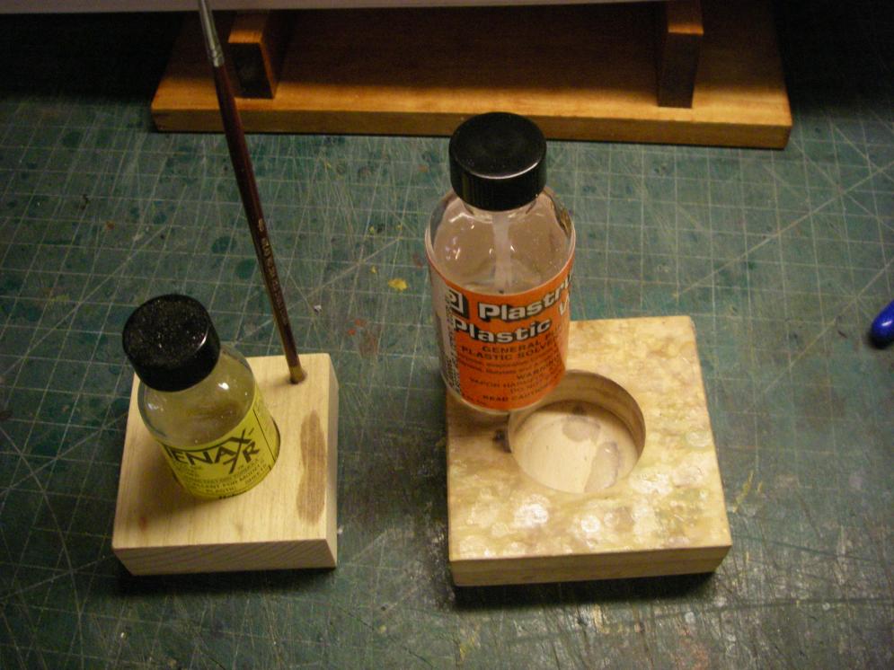

    For assembling styrene hulls, use a liquid styrene cement such as Plastruct Plastic Weld. Apply a thin coat to both pieces, then join the pieces, and apply a second coat over the seam. Think of the first coat as preheating steel before welding; the coat applied to the seam does the welding. If you're using a tall round bottle of liquid cement, I recommend drilling a hole in a piece of scrap wood just a little larger than the glue bottle. Glue a 1/16" or 1/8" thick piece of wood on the bottom. Keep the bottle in the block of wood, and you're less likely to knock over the bottle - second picture.

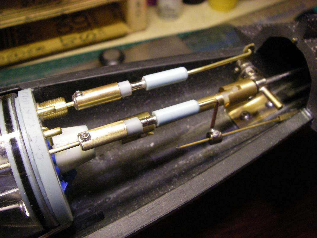

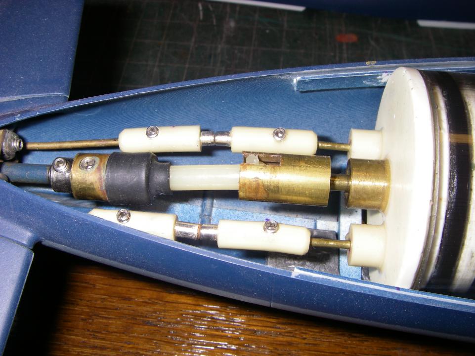

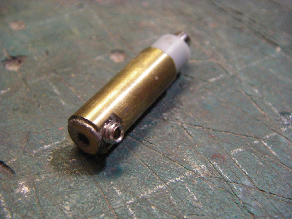

    The magnets are CA'd into resin moldings, not fuel tubing. Most of the Lkil-Ons have a1/16" hole in one end, which can be threaded with a 2-56 tap; You can solder threaded connectors onto the pushrod ends, then thread the magnet on. I have soldered some 1/4" brass tube onto 1/16" wheel collars, then epoxied the magnets resin body into the brass tube - see the first picture. The third picture shows my Trumpeter 1:144th scale KILO, where I drilled and taped the resin body for a small set screw; to secure it on the pushrod shaft. The last two pictures show the magnetic connectors in my 31" Disney NAUTILUS model. The right hand (forward) connector has the brass tube soldered to a wheel collar. The left hand (aft) connector is epoxied to the brass shaft.

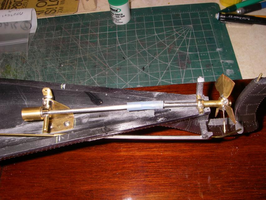

      Chip, I like your shrink tubing over one end of the dog bone. (photo #3)
      I may have to appropriate that for myself.

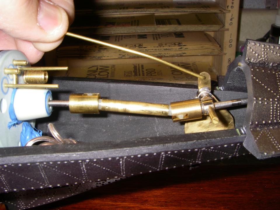

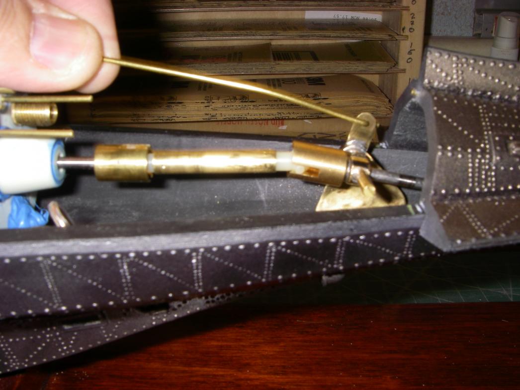

      I am not a fan for the extended dog bone using pins. (photo #5)
      This past weekend at an event, a boat went through the bottom weeds again and broke the pinned connection for the second time.
      I do wonder if the tubing has anything to do with the issue.
      The tubing on this particular boat is aluminum and I do not think it can take the torque the motor run in this boat puts out.
      I would use brass and I would most likely grind small flats on both sides of the dog bone plastic and drill a hole through it as well as the pin.
      Then I would use something like Gorilla Glue on the dog bone as I put them in the tubing and pinned.

        Ralph,

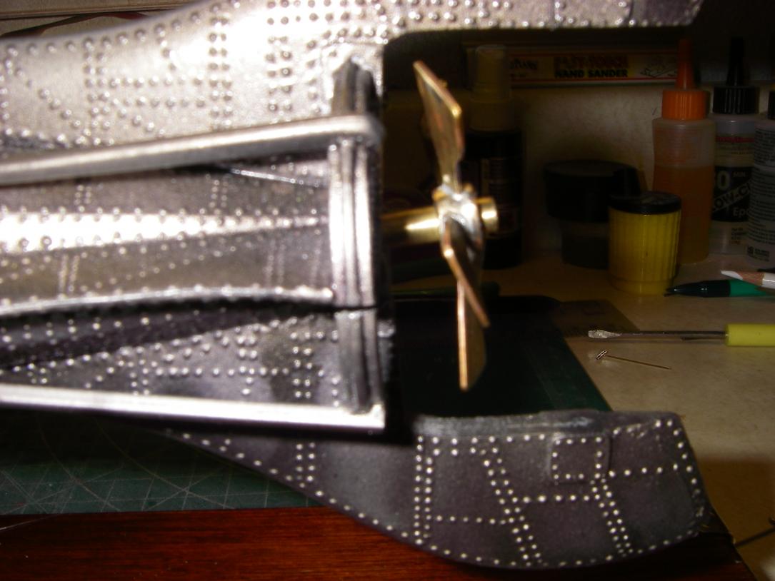

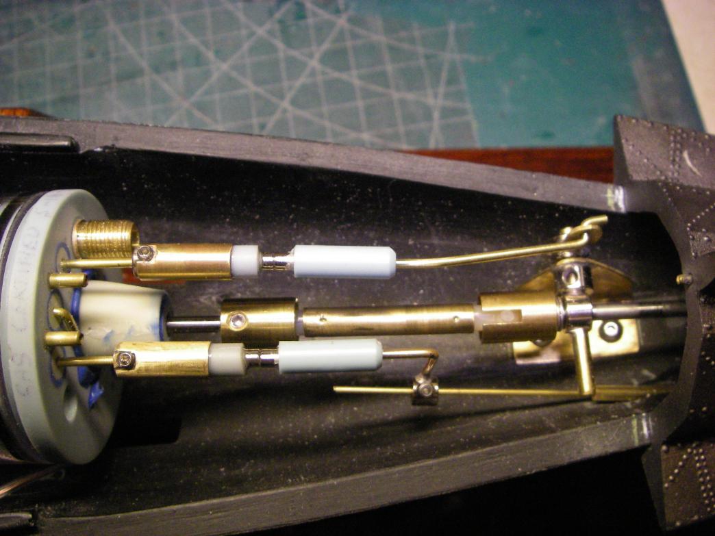

        I've used the heat shrink over the dogbone on a couple of boats. It does make it a little easier lining up the u-joint on the WTC. The dogbone extension in photos 4 & 5 is actually CA'd in place, and then dimpled with a center punch - no through pins. The last two pictures posted above are of my 31" NAUTILUS, where pitch control is done with the prop shaft. On the NAUTILUS, the shaft is two short pieces connected by a length of fuel tube. As the servo moves for or aft, the prop pitches up or down. It worked well on the one run I've had. The 5 photos below are of the NAUTILUS.
