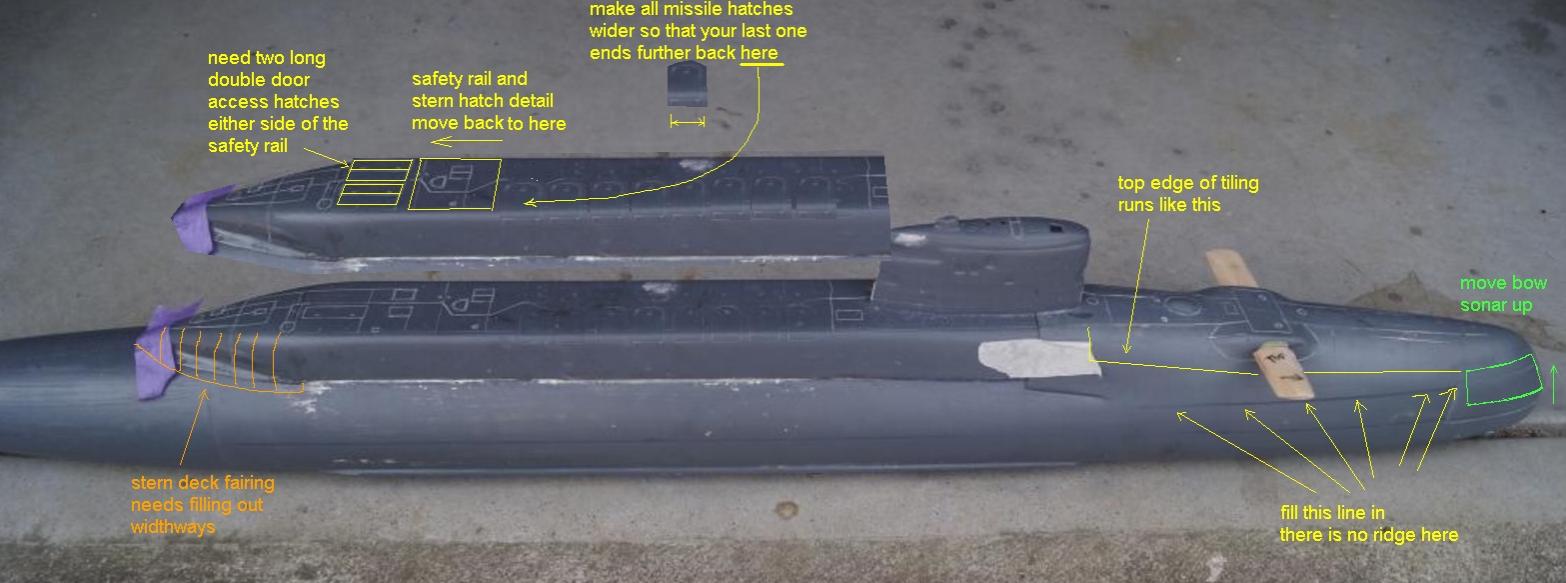

    Hi Dave, I spent some time looking over your hull. As I mentioned before you are very close with your detail. The main issue as far as I can make out is that your missile hatches end too soon, they need to end further back. In order for this to happen you will need to widen your missile hatches so that they take up more deck. Problem is you also need to try to maintain the missile hatch length to width ratio. Which leads me to suspect that your missile deck maybe is narrow. Jecobin plans also suffer from missile deck being too narrow. Still, you might get away with it by widening your hatches. Try drawing it out roughly on your deck. I have also taken the time to outline other areas of adjustment which would make your model more accurate. These are only my opinions though. Having no plans and just going by photos is always going to be subjective.
    Differences between the four sister ships definitely. Res gets just her tower tiled no tiling on her hull. Revenge appears to have just been painted with rubberized paint. Repulse and Renown get the whole treatment tiled tower and hull, although there are slight differences in the tiling patterns and also bow sonar covers differ slightly.
    Anyway, see what you make of my edit of your model hull photos below.

      Steve,
      I have been away for a couple of days on a school camp. I was thinking in the quiet times , about the back end of Resolution And realised that the transition of the missile deck is out.
      Thank you for you annotated pic of my work. This critique is excellent and frustrating as it shows how much I got wrong. The upper bow section from the bow back to the sail was the single hardest section for me to get right. I spent easily a month or two trying to get it right, still haven't achieved that. I was just going to re-tool the missile deck but I can see that the whole upper hull will need to be re-tooled, it will bug me till I do. I will widen the missile deck. So your scribbling over my pics is much appreciated, scribble away! I am getting a collection of photo's together that I think you may not have and will hopefully answer some questions for you. I'm still finishing off tooling for the project 685 mike so another project on the boil.

        Hi Dave,
        your missile deck transition isn't far out. Retain that V shape you already have - that is correct and should be there. It represents the corner where horizontal plane turns over and then down to meet the main hull casing. Depending on lighting you will see this V shape appear on photos of the real thing. Your model just needs the sidewalls building out from the V. My rough outline sketch is attempting to show this. Adding onto your existing shape should be an easy fix. What I am saying is - don't trash it and start over again! Build on what you already have.

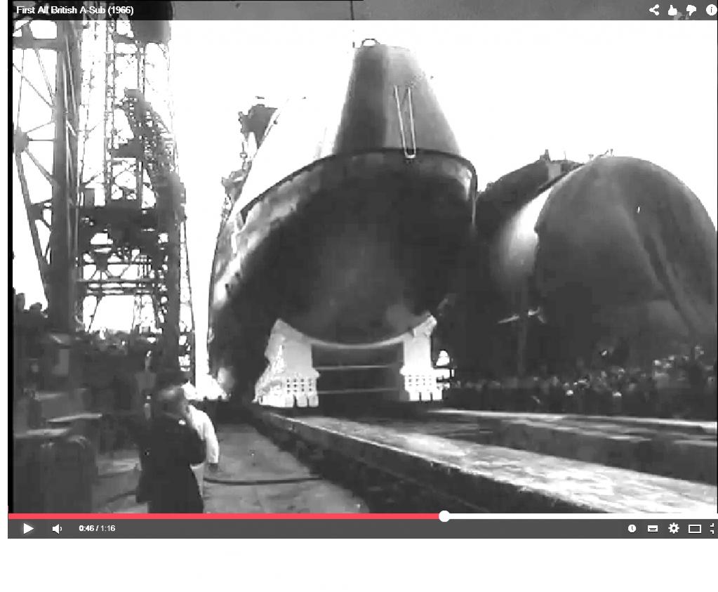

        Re the bow - I agree this is the most difficult part. For mine I got the whole bow profile in as a datum line from a good side on launch photo, and then I built out one half just by eyeballing and shaping with filler whilst comparing with various photos of launches and drydock. Then I made profile gauges to repeat that shape on the other side. No line drawings or sections. Just best attempt at sculpting from photos really. Some may say I have got the bow wrong also. My intention when the model is complete is to primer coat and then stick thin masking tape stripes down the hull the same as in the drydock photos, then photograph my model from the same angle of view, then resize and copy/paste the two pics together for a direct comparison between the two. Hopefully they will look the same!

              fwiw I think your bow needs to be widened across the beam. Jecobin plans show a very narrow 'snout'. But looking at drydock and launch pics I dont see a narrow 'snout'. I see a lot more rounded form. That's why I made mind wide across the beam. Have a look at these pics attached. Blue pic in particular pay attention to the concentric lines running around the hull - these show how the hull form transitions from the rounded bow to the flat uprights of the missile casing. The launch pics show the bow from a low angle and show the bow is really quite wide up to the center line and then narrows on the upper half toward the deck. One final pic stern view shows slope of missile casing sidewall.

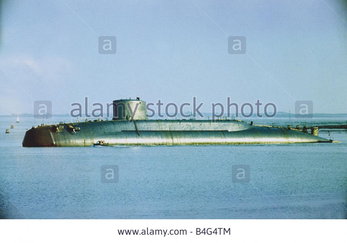

                • 467
                Hi Ralph,
                Welcome to the discussion. Great pic you found there. That is indeed Repulse, soon after she had been launched in fact. The launch was held up (waiting for the wife of one of the dignitaries to arrive), and because Repulse missed her tidal window she ended stuck on the bottom. They tried using tugs to drag into deeper water but she wouldn't move, so there she sat on the mud until the next high tide. The embarrassing situation was the first time in the Barrow shipbuilding yards history that a vessel failed to launch successfully. The story made the national news papers. The pic is very interesting because it confirms that these submarines were launched without rudders and without prop fitted. This pic demonstrates exactly why. I have been to see the old slipways - which still exist, but are no longer used because they now roll out new subs on rails and they are gently lowered down into the water using a specially built lift (elevator). But yeah the old slipway delivered the launched vessel at an angle into narrow channel - which was also tidal! Also the pic shows very nicely the profile of the stern part of the hull. It's very curvy and bullet shaped. Thanks for posting your pic find.

                  Hi Ralph,

                    Ralph,
                    Awesome pic, any more!
                    David h
                      That was just a 5 minute google search and the pick of the best profile i saw.
                      Took me a minute to realize the boat was stranded on a sand bar.
                      With the water at mid hull is nice doe detail below waterline.

                          Ralph, Yeah sure is a nice picture. One of a very few which actually give a clear view of stern profile all the way down to the tail end. This actual picture wasn't on the net when I did my searches. Goes to show the net is constantly getting new stuff uploaded. - I learned something there. Did another search and got some more pics I hadn't come across before.
