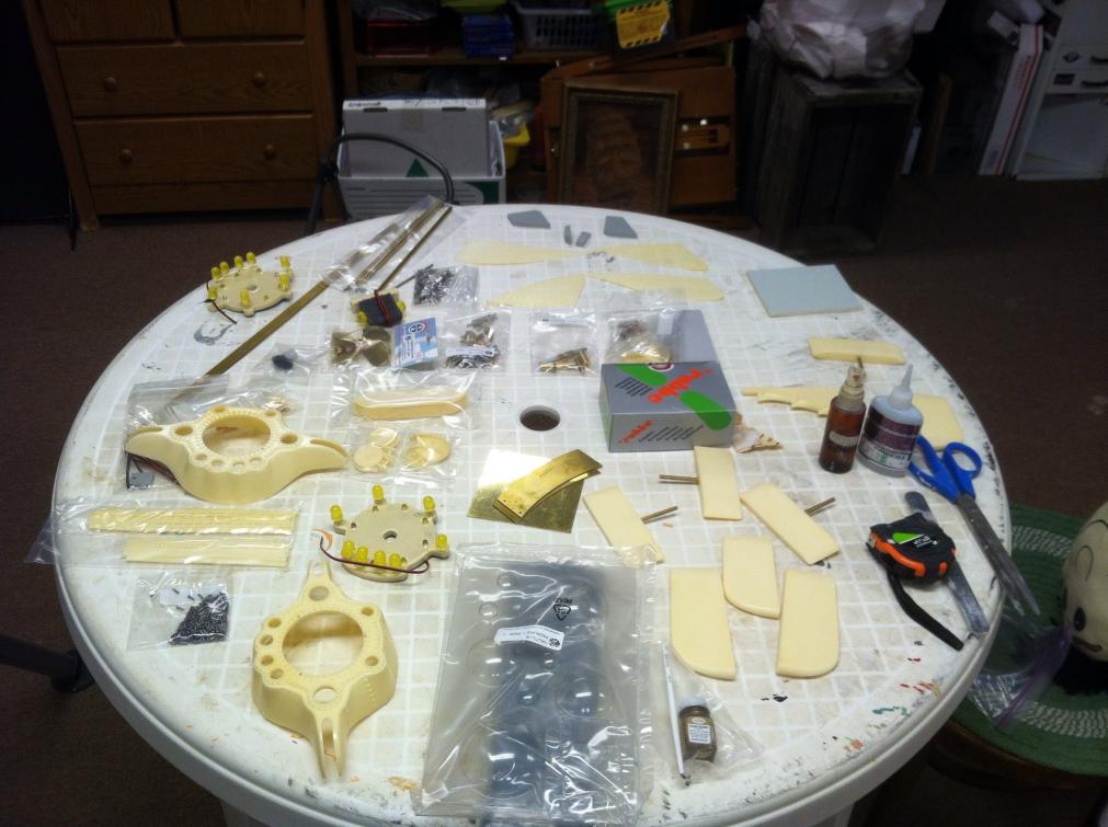

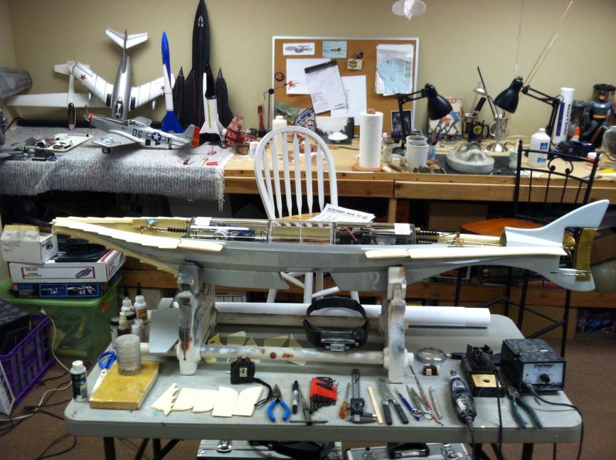

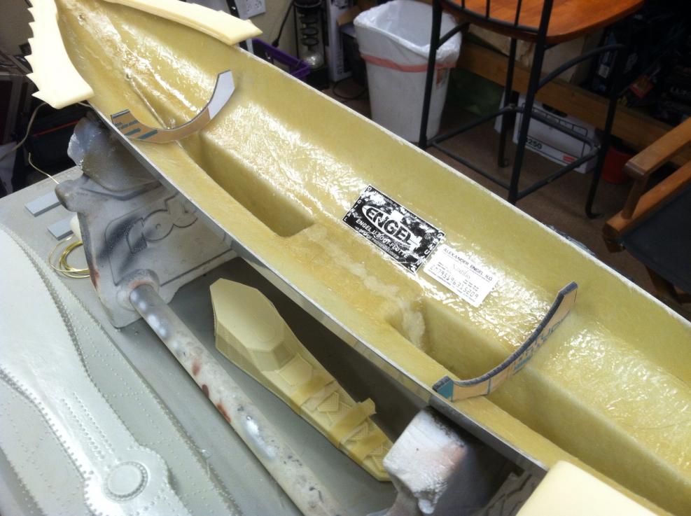

    It's been awhile since you have seen me here building a Sub but when Steve Fisher asked me to build his boat for him I thought it might be good to build a boat again. And using one of Bob's cylinders made it even more attractive. I have used them many times in y own boats and love them.
    This kit is really different from my own Custom Replicas Nautilus. The lack of rivets on the lower hull is a bit perplexing to say the least. And there are many parts left off this kit I'll have to scratch. Not to mention all the rivets I'll have to add.
    But the kit is really cleanly made. Engels usual class act.

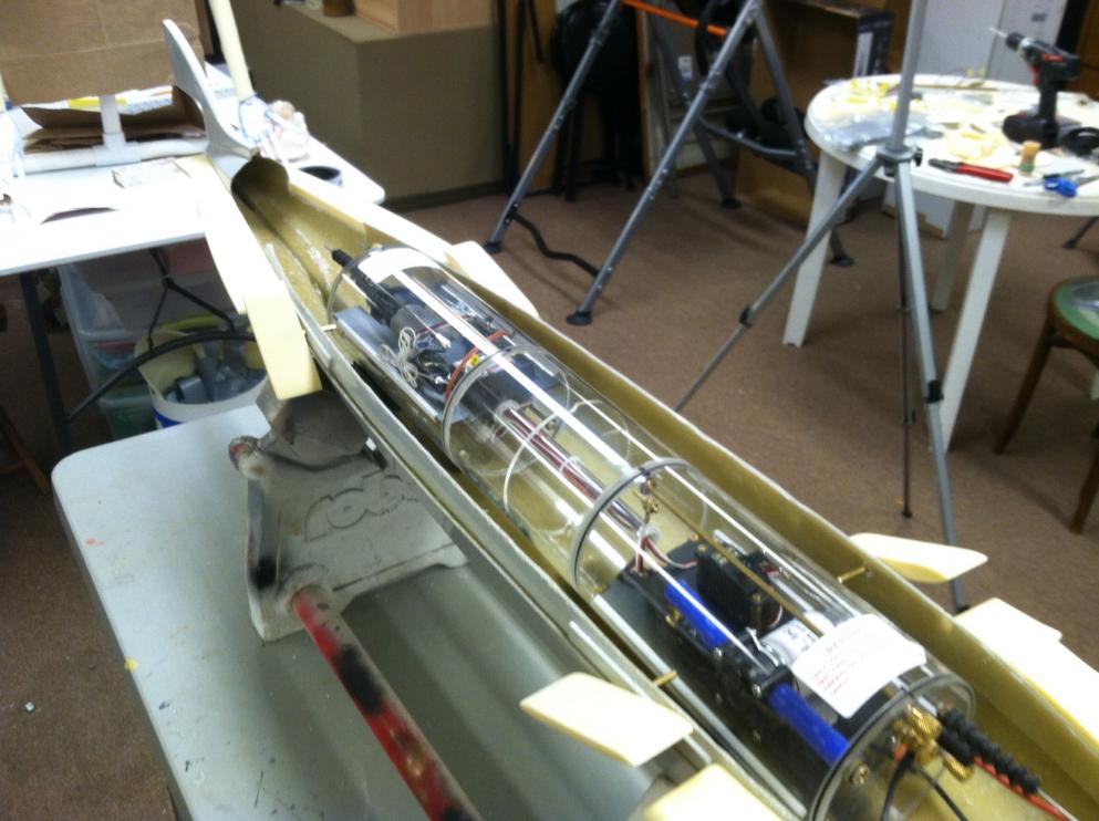

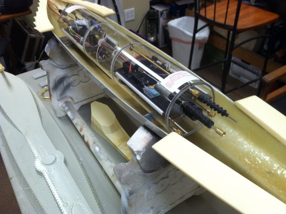

    So far I'm working on getting the hull together, adding all the parts and getting the lay of the land as they would say. Made some simple plex bulkheads to mount the WTC. This cylinder fits like a glove and leaves me plenty of room. It's nice I can get the Ballast tank directly over the CG.
    More to come.
    Steve

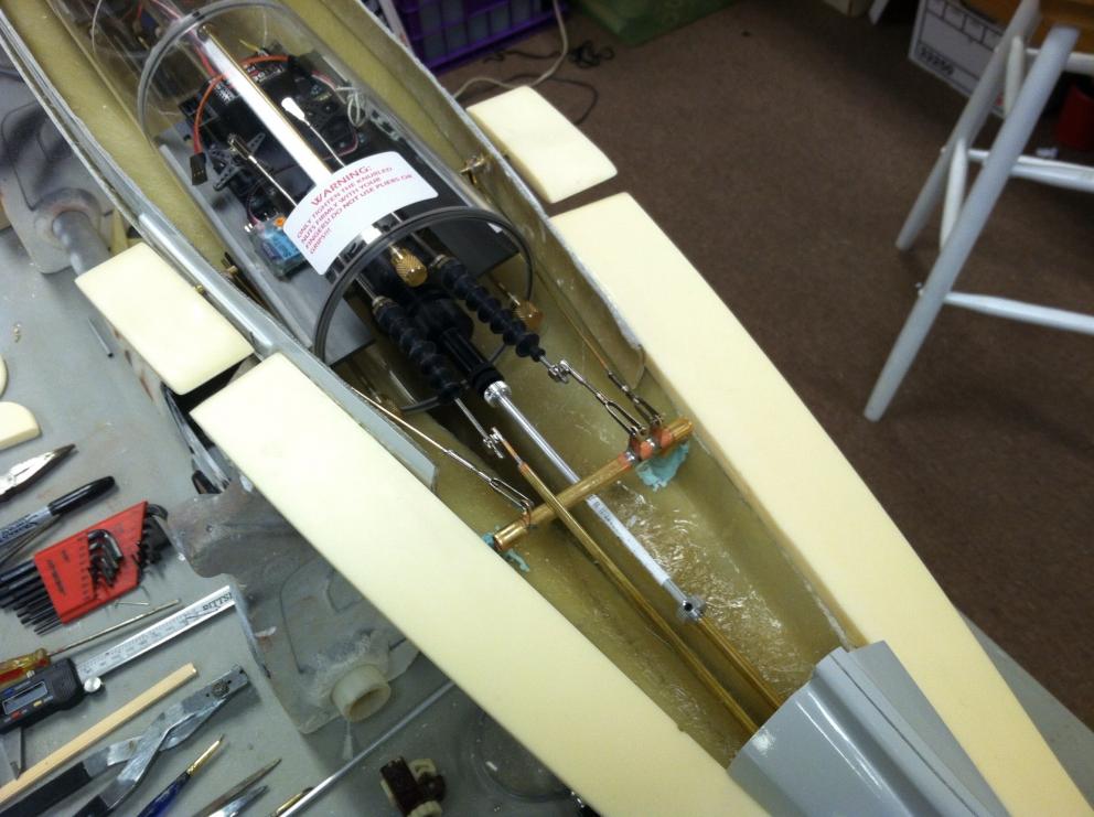

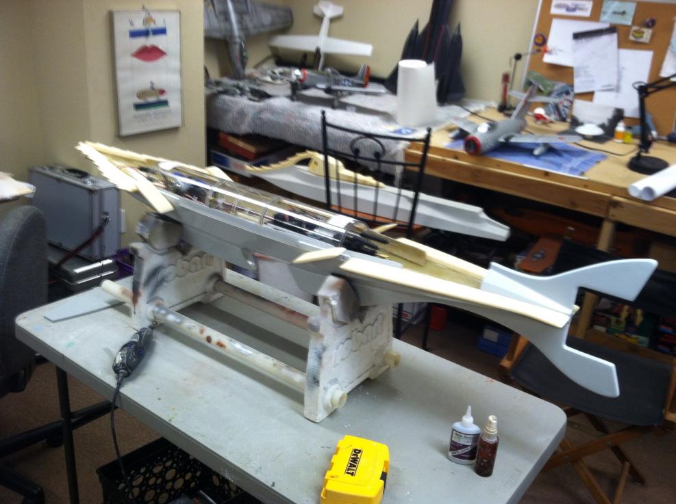

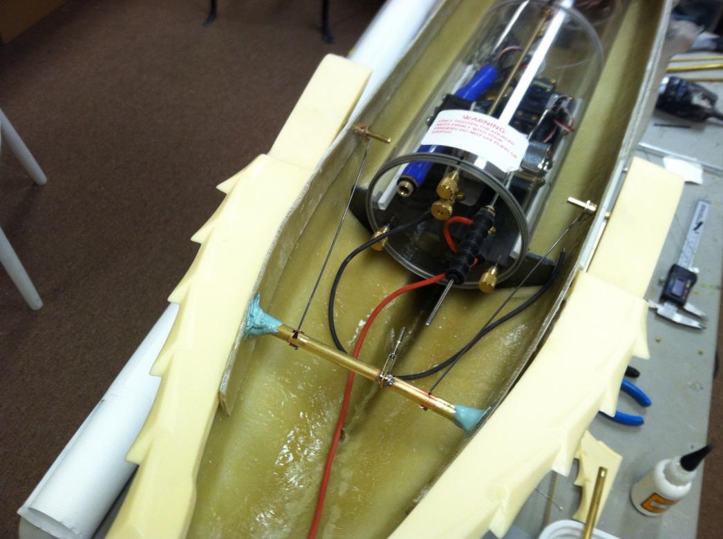

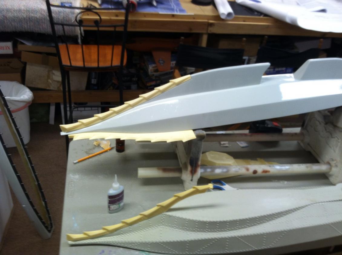

                    It's not all Enterprise but Nautilus too. Here's a couple of pics for BDs coffee. Dive planes are in I got the rudder built too but not installed yet. Also the WTC bulkheads are installed and padded so they don't scratch Bob's beautiful WTC.

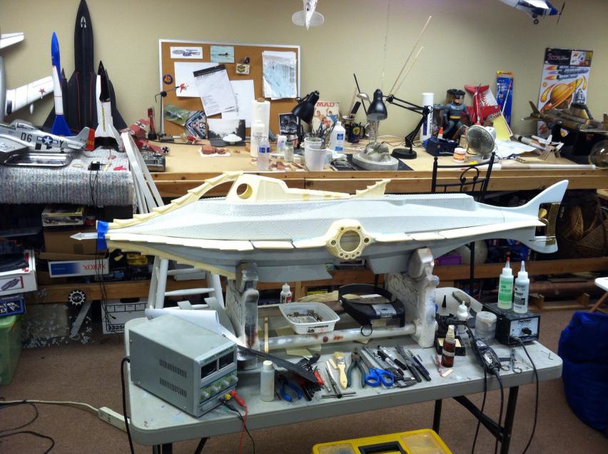

                        I see I never did re post the last show but now that the 66 inch Enterprise is done for the Musuem of Science Fiction I am back to the Nautilus. There's a little bit about it at the end of this show but lots more this week.

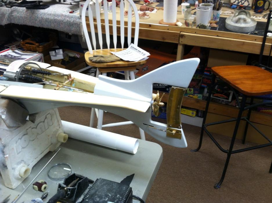

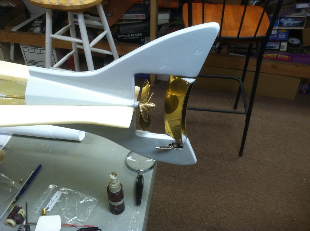

                        Rudder mechanics installed the ugly hole gets covered up by a brass plate. In had clearance problems with the even wall thickness of the layup in the tail it took a lot of grinding to get the control arm to move smoothly.

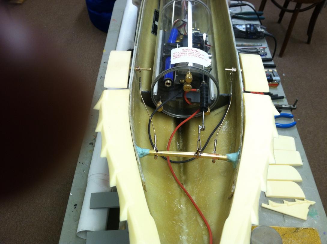

                            Got everything connected today. Rudder, dive planes, propulsion. Next up to hook up the radio and check that all systems are working properly. Add the prop guard and get on with the modeling part of it. More tomorrow.

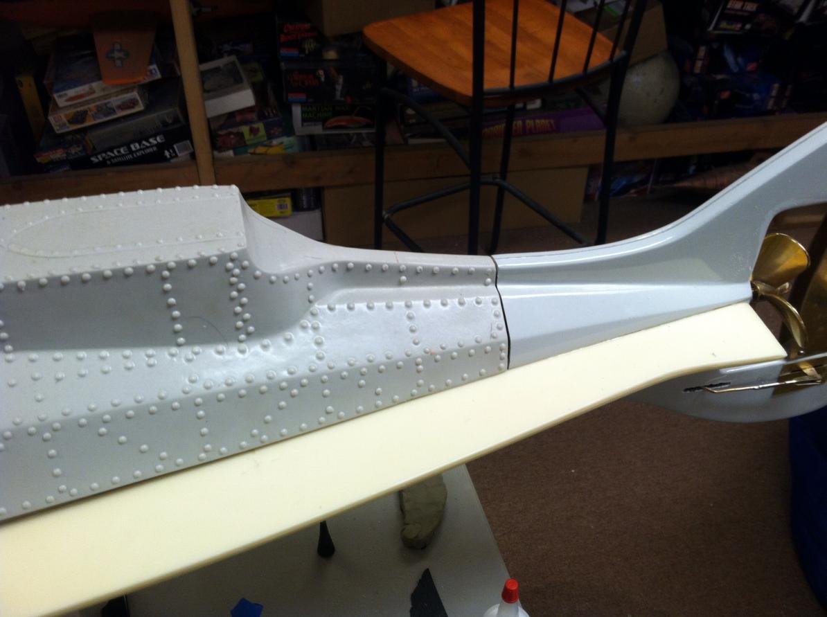

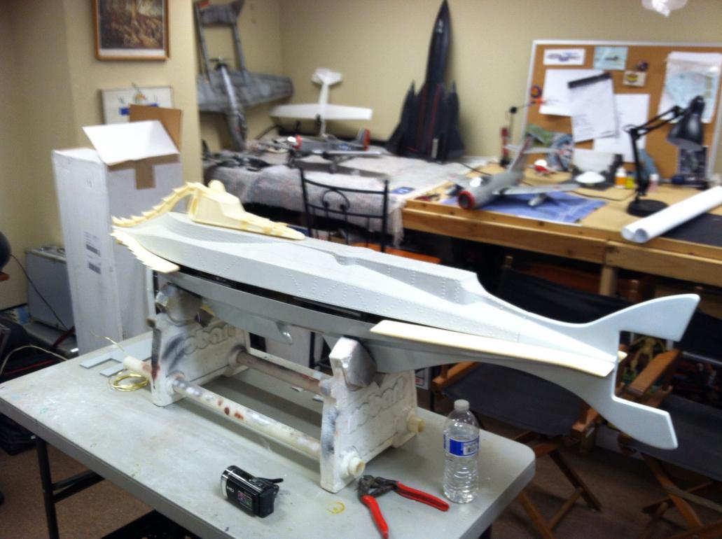

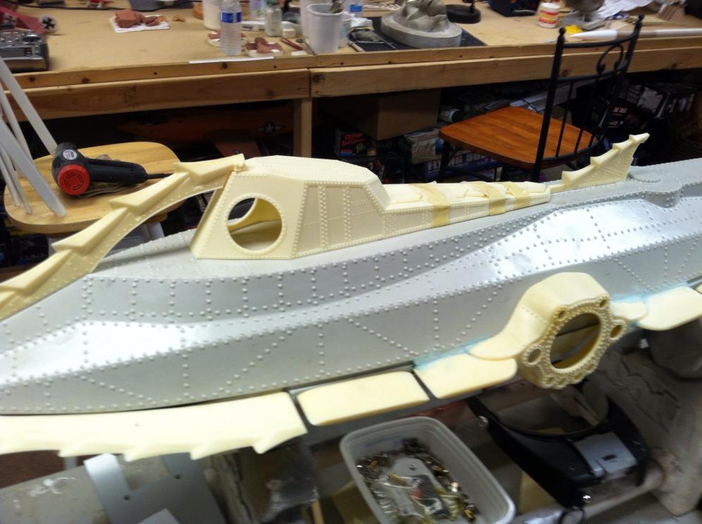

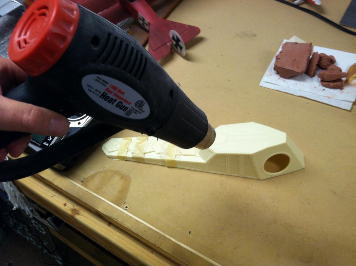

                              This ship is warped and doesn't even have nacelles. The hull has sat for a long time in the box and I have not been able to level this polyester hull no matter what I do. I could have flat sanded it but that would have cut into the rivets. So good ole Evercoat putty to the rescue and no one will be the wiser. I didn't like their method for closing the hull so I'm sing my own that was most successful on my 66 inch Custom Replica Nautlius. Tung in the back and the ram in the front locks it down. This makes it simple and fast to get under the hood. The salon window blisters are attached to the upper hull. The wheel house was really warped. So bad it wouldn't sit flat, not even remotely. But that was cast in urethane resin so it retained its memory and returned to its original shape with a heat gun. More tomorrow.
