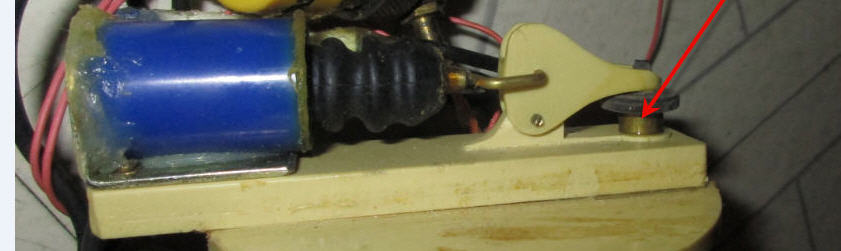

    As I'm planning on retrofitting my Sub Drivber after the meltdown, I'm pondering the possibility of replacing the incorporated vent valve that came with the
    WTC with the one in the picture attached. Excuse my ignorance on electronic circuits but, how would you set up this vent valve electrically so it can get activated via
    radio signal. It's got two wires at the end of it. Thanks. Click image for larger version

    You will want an electronics module that allows you to use a radio channel as an on/off switch. Something like the SubTech SES unit. I'd have to check to see what is currently available since SubTech is temporarily not available.
    Alternatively, you could use a servo with an arm that can depress a micro switch to energize the solenoid in that kind of valve.
      • 342
      Subdriver has a es2 switch to do that. Their large pump and controller lets you do it too. I use the setup in a rcabs George Washington sub. Mikessubworks also makes and sells one. I have found smaller vent solenoids on amazon and eBay.

        This valve (I think it's Skip's, got it back in the 90's!) already has an incorporated solenoid valve (the little blue barrel, see pic, at the other end of the openening), when you connect the two wires to the battery it gets activated on and off. I think only a sort of switch is needed like Jeff said.

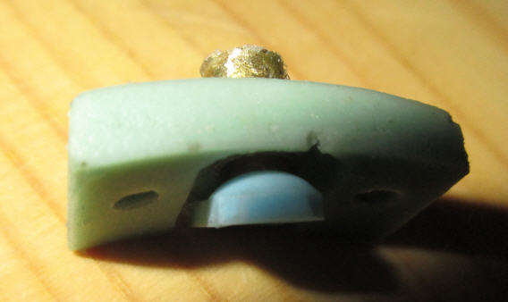

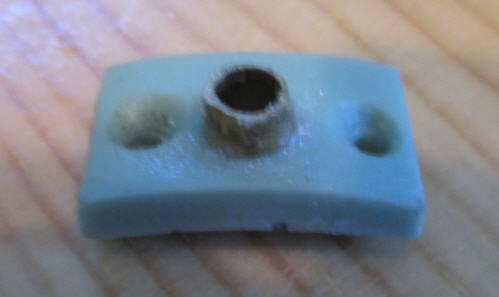

                    Over the weekend I was able to work in the vent valve adaptation of a bigger orifice, for this purpose I replaced the 1/8" brass tubing with a 3/16" dia and it turned out like in the pic, the rubber piece covers the 3/16" opening nicely. Of course I won't be able to test it until all the electronics are retrofitted and installled first, however I don't foresee any problems with this. Thank you guys. Click image for larger version
