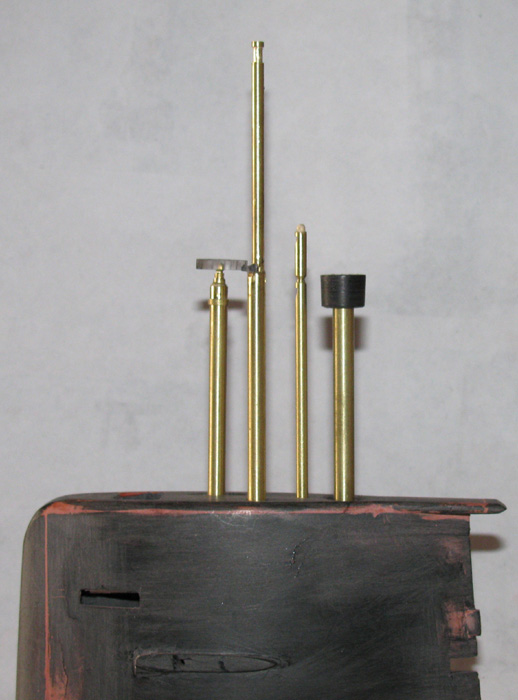

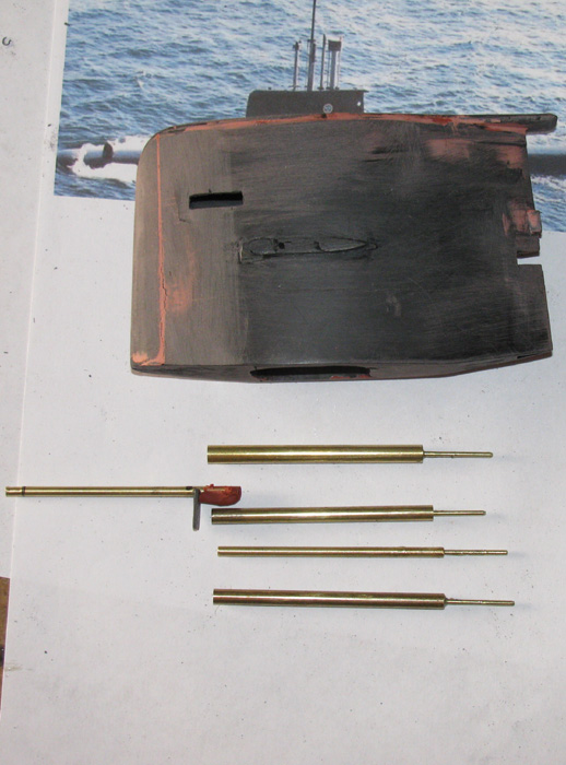

                  You might consider making your masts out of brass tubing.
                  Here are three photos of my Gotland masts, built from scratch.
                  Assembling pieces.
                  Finished masts.
                  The mast are removable.
                  They push in to holes in plastic horizontal frame pieces put in after the sail was built.
                  • southern or
                    • May 2014
                    • 484
                    Thanks Ralph. I could do (most) of that with the rods pieces I'll have left over from the Oscar.
                      I did not find it hard at all.
                      The radar top is a piece of clear plastic I shaped with sand paper block with larger brass tubing ring for the head mount.
                      The tall mast has a piece of solid brass rod for the top section and the groove was made with a file while spinning in a drill press.
                      The top section to lower section offset was made with a blob of car body glazing putty, sanded to shape.
                      The periscope was notched for the viewing lens with a small file and the top rounded piece is made from a wooden match stick and spun in drill press.
                      The snorkel head is layers of 1/16" sheet plastic bonded together and then spun in the drill press and shaped with a sanding block and file.
                      The piece on top of the snorkel head representing a light is a piece of 1/16" brass rod spun in the drill press and shaped with a small file.
                      The three small shafts running up the sides of the Snorkel and em mast are 1/32" piano wire.
                      I think they all took me about 40 minutes to make the parts from the photo.
                      All the parts are glued together with water proof glue.
                      No soldier was used.
