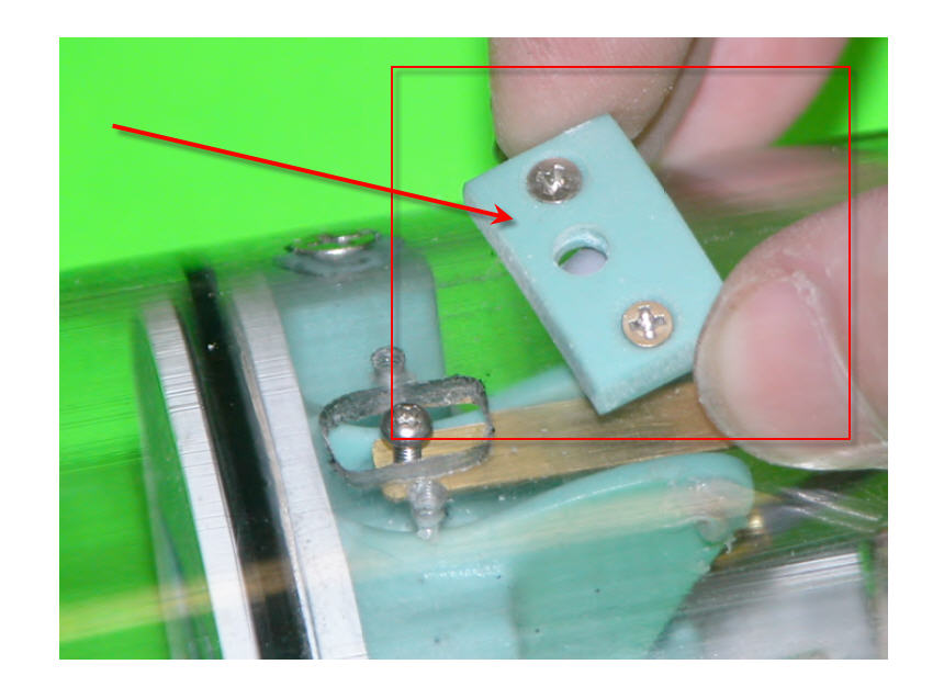

    Can somebody please advise if anybody else can outsource this part other than Dave Meriman ? See pic.
    I tried to get it from him (long story), he promised to ship it two weeks ago under warranty, and still haven’t got it. I tried to email him, call him, no response, nothing. I even kindly sent him an email offering to pay for it and shipping as well (Priority Mail or next day), no response at all whatsoever. Sorry to say but his customer service really sucks.

    The part can't be repaired? We're not talking microelectronics here. A bit of rubber and you should be good to go... no?
      Can you clean up the set on the plastic and then a bit of silicone grease on the bolt or seat.
      You can try using paint rubbing compound on the bolt and twist it back and forth with your fingers .
      Is there enough tension when closed to keep the seal tight?

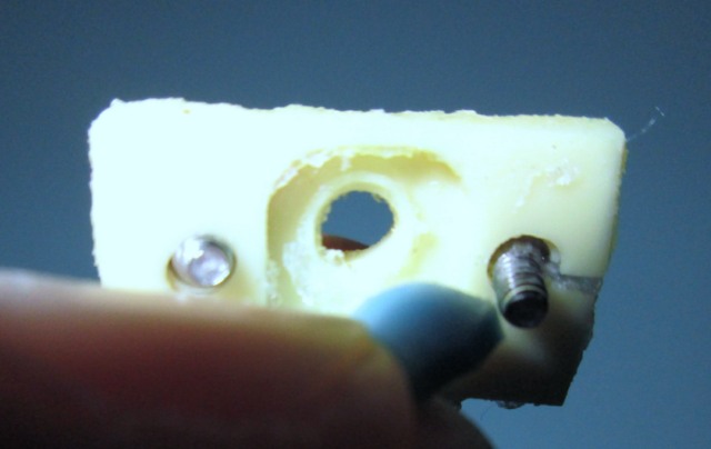

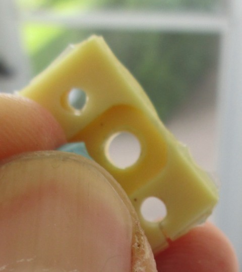

          The rubber is still in place, sealing with RTV around the piece perimeter is no problem either. The polyurethane material chipped off a tiny piece off in the under side of the orifice where the rubber piece plugs the hole, I tried to silicone it but with no success so far.
            What is underneath that rubber part?
            Does the screw head seal up against the underside of the rubber, or is there something attached to the bottom of the rubber that seals? Do you have a photo of the underside? BD

                I've been trying the big part of the afternoon to fix this to no avail. so maybe I could make the boating reunion tomorrow at the pond nearby sponsored by a local club but.... In the pic, you'll see the underside of the part previously posted, the orifice (vent hole) is chipped off in one side, the rough texture you see in the pic is silicone.

                      So you need to fill the chip and have a smooth surface to seal against? How about filling with bonds or auto body filler and sanding and polishing after? I think jb weld will work there too.
                        I like Ralph's idea but as you don't have the time I would try this.
                        Take some paste wax and put a few good coats on the screw head.
                        Then take silicone RTV and add a thin bead around the underside of the hole in the rubber part.
                        Then take the part and carefully mount it on the cylinder tube.
                        Let the RTV set up and the carefully remove the rubber. It should come off easily with the wax on the screw head.
                        Leaving a perfect mate for the screw to seal against. BD
