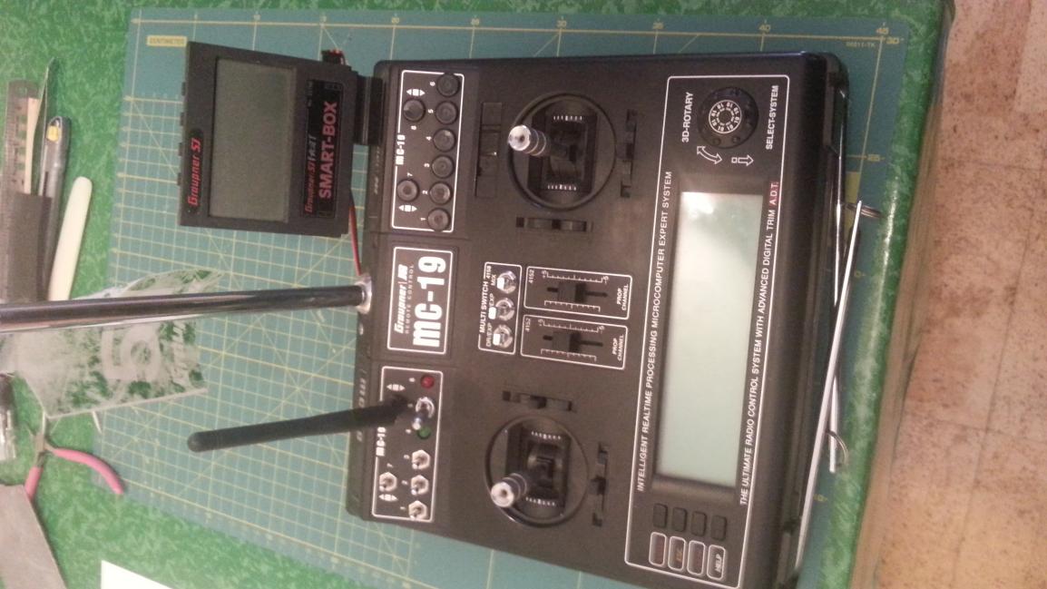

    Hi,
    I use my quite old? (10 years) Graupner MC-19 40 MHz (The first non synthesised) which I have upgraded with a switchable 2.4 GHz module for surface use.
    And I will try that 433 MHz LRS stuff in the next time.
    Marco
