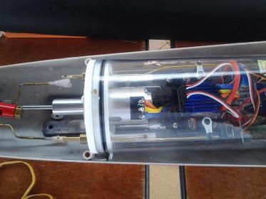

    The current set-up on my Akula is via magnets, however in my own personal experience I've found it to be unreliable, not "rock solid" functioning - in two ocassions I've been lucky I had the boat on the surface and close to "shore" to be able to rescue it, only to discover upon inspection the magnets were disconnected from one another, not a good thing. A big risk to my investment. So, I've decided to go a different route, perhaps not as quick-release as the magnets but definitely will be much
    more safe and secure. I know some of you swear by the magnets but unfortunately this hasn't been my experience.
    Can you advise which would be a better set-up, either via clevices or ball-links? and if so, how would you set it up, I'm just looking for ideas as I don't intend to reinvent the wheel.

    The boats I have built, the rudder and rear planes stay in the lower hull half along with the cylinder.
    So, I use clevises.
    Only because I have lots of them.
    They don't need to be disconnected in the field.
    I think ball-links are tighter connections with less play in them.
    I have started using magnets on controls that stay in the upper half but I make one side rigid and hinge the other side so they align when they snap together.
    I use two magnets on each side, for a total of four per control rod.
    I thought I had a photo. Didn't find one.
    Need to do that for my last build log.

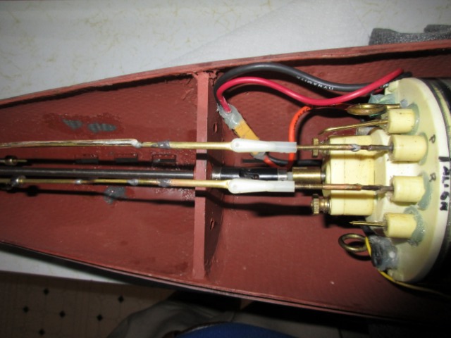

    • tsenecal
      plastic clevises
      almost as easy to attach/detach as the magnets, none of the cons.
      i do use magnets and pins to align and connect the hull halves.
        I'm with Tim and Ralph on the use of plastic clevises. For all practical purposes they are foolproof, make it dead simple to make any in-field, last minute changes to the length of the linkages, and won't corrode and break.
          I also use wheel collars with control rod soldiered to the collar.
          They provide positive connection and adjustment.
          The end at the rudder and planes is just a Z bend which take up very little space.
          I put the rod on the control horn before putting the horn on the rudder/planes pivot shaft in the tail cone.
          The control rod coming out of the cylinder is long.
          It does not bend due to sitting in a notch at the propeller shaft bearing frame.

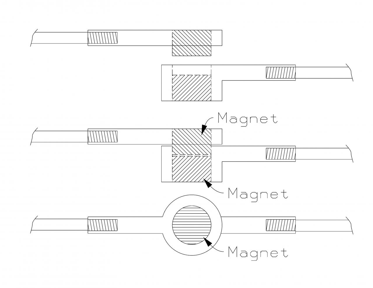

            How about a magnet that uses a mechanical pin type connection?
Name:	magnet coupler mechanical hold.jpg
              That's a very interesting idea, Scott! Salmon has a similar approach where the pin inserts along the horizontal axis of the linkage.
              I've used Tim Smalley's old method for years. A ball link on one end attached to a brass tube mated to the WTC control link. A brass rod from the control hor runs back into the tube. The set screw in a wheel collar on the end of the tube clamps it all tight during operation. Loosening the set screw allows you to adjust the linkage. Tim had a drawing online somewhere to illustrate for those confused by my description. Maybe he will join in here.

                  I finally did it this last weekend. I did away with the magnets and installed plastic clevises, stayed away from the metal ones just in case to prevent motor interference. I haven't put it in water yet, but tested it in dry-dock and everything seems to be working just fine. Now I shall have more peace of mind definitely. :-) Thank you all for all the good feedback. The idea of the pin magnets is really ingenious, much better and more secure than the conventional magnet power reliability.
