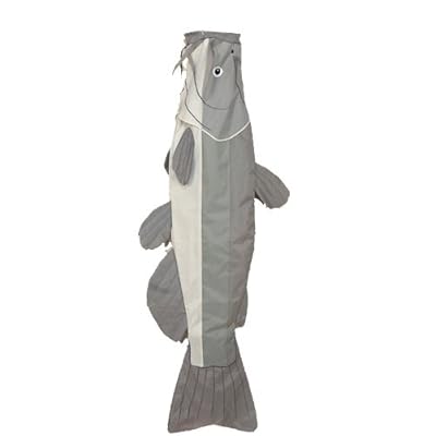

              Re: Hi guys
              Some ideas for propulsion might be a bilge pump shooting water out right and left tubes to get the eel motion.
              Some tapered articulated sections could be added for a tale sort of like those souviner snakes.
              Cover is with clothe material and paint it. Like this catfish wind sock.
              If you leave it in the water to long it would look like a slime covered log.
              Just find you a secret launch point and launch it on the unsupecting folks.
