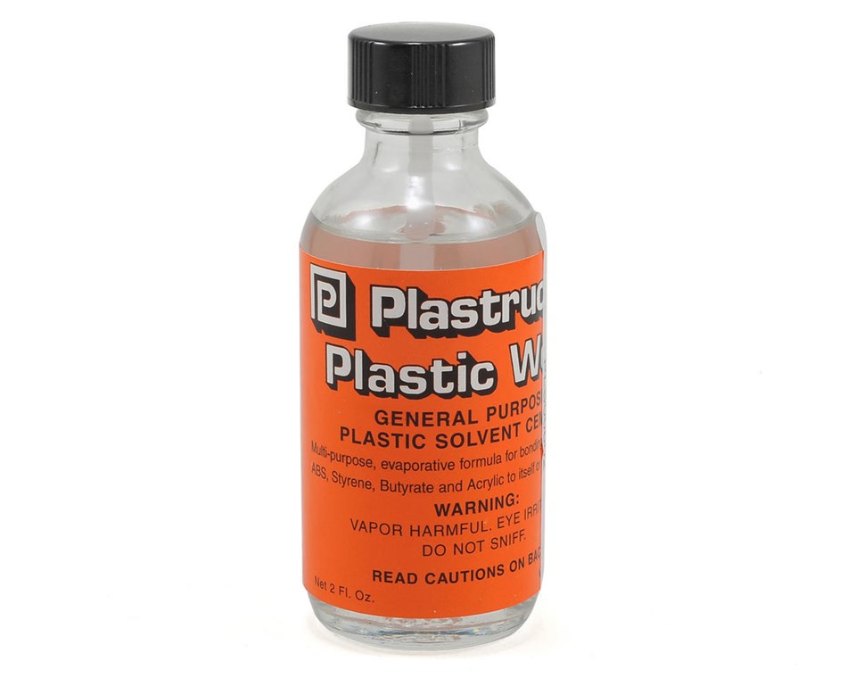

    Best can be subjective, but I usually use a cohesive glue like Plastruct. It melts the halves or pieces together essentially making it welded as one.
    Epoxy can work well, the commonly shared advice is not to use short cure epoxy like 5 minute or 15 minute, but go for longer cure times 8 hour or 24 hour cure rates. CA can be used, I normally do not but some do, it works for them.
