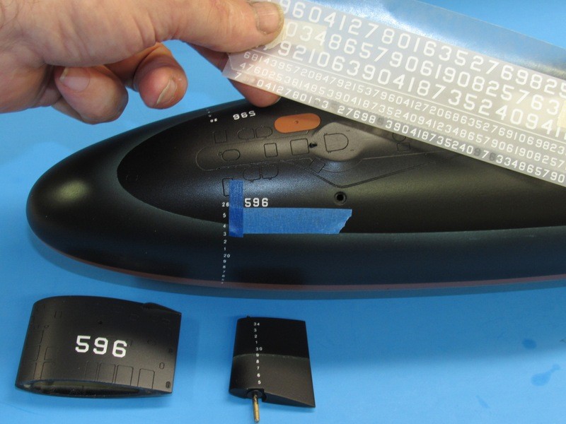

      I use Woodland Scenics dry transfer sets for numbers and letters. They have a 45 degree Gothic sets that work well for U.S. boats. I seal over the dry transfer with a clear coat. MG747 is the 45 degree Numbers set; MG740 is the letter set.

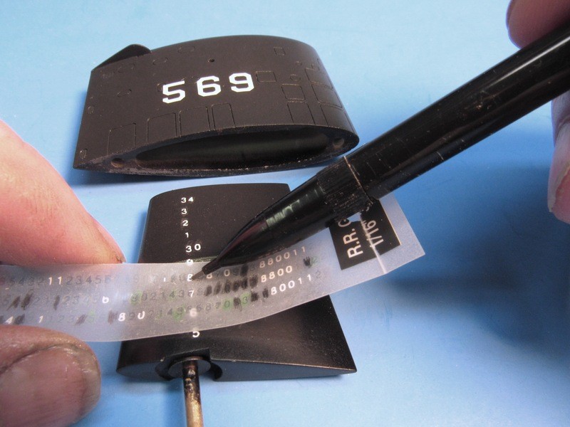

          David Merriman used these for several of his subs:

          David also uses an inkwell pen type device to make white dashes, I cannot for the life of me find that photo.

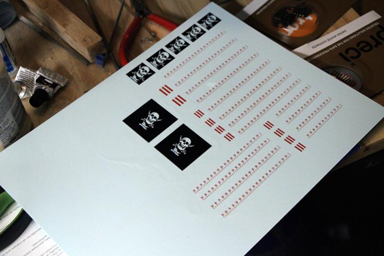

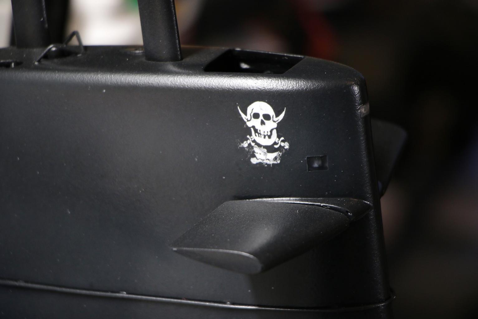

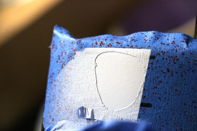

          You can also try to make your own decals, but white are a bit tricky.
          I used the clear decal and made the base color (black) surround my emblem (https://www.bare-metal.com/experts-c...ecal-film.html). The same for your numbers and paint white underneath. The issue would be matching your base color.
