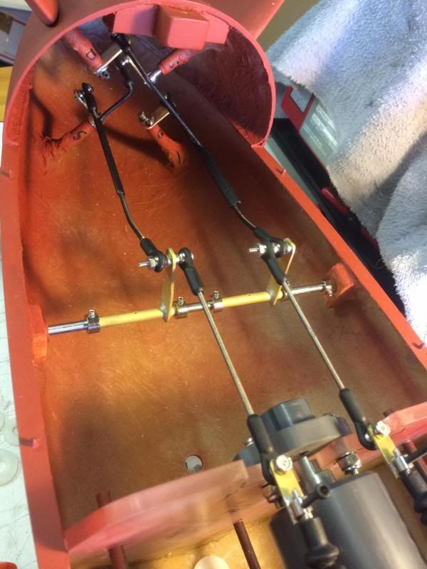

    In addition to the cutting I mentioned above, what do you guys use to cut out little small metal parts? Like the small brass (looks like brass) pieces that you solder to dive plane and rudder shafts, like Darrin did below:
    Darrin's work is always awesome!
