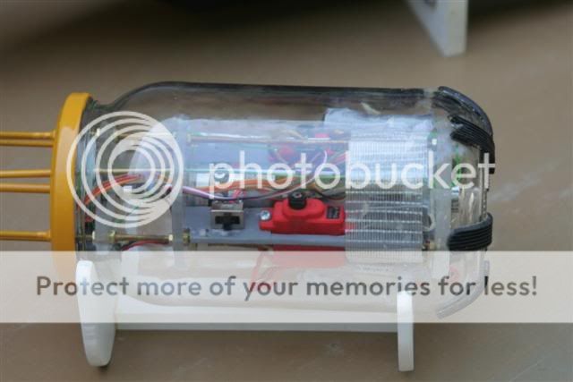

                        Re: Help on school science expo
                        Hi guys
                        I just checked and all the photos that were on my build are gone?
                        I will try to find some. BD.
                          • 880
                          Pictures from thread listed above.
