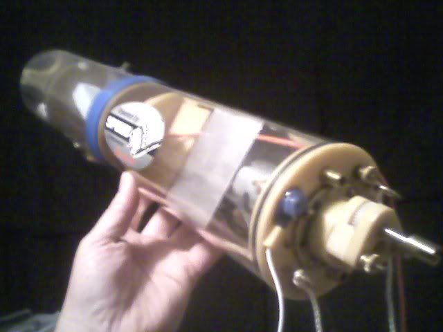

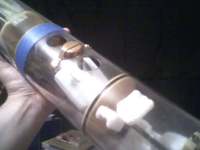

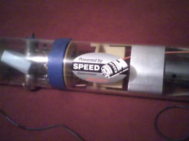

                  Can you post some pictures
                  Can you post some pictures of the set-up?
                  • modelnut
                    • May 2003
                    • 432
                    Label
                    Business end
                    Problem area
                    3.5 inch diameter.
                    Label
                    Business end
                    Problem area
                    3.5 inch diameter. Any ideas?

                        Well. Here is the problem.
                        I am basing my sub on a PVC pipe like Steve Neill did his NAUTILUS. But I suspect his PVC pipe had thinner walls than mine.
                        My PVC is .25 inches thick. It's sturdy but probably too heavy.
                        BTW Steve used a 3 inch WTC in his boat. Mine is 3.5.
                        Thought about grinding out the interior but can you image the dust?
                        I could build another cylinder by hand. But there is no guarantee that it will be true (read "straight".)
                        Or I could buy a 3 inch WTC package.
                        If anyone would check out my pictures and identify whose WTC this is that would be helpful. I bought it from an SC member many years ago and it came without instructions or any info about its maker.
                        -Leelan
                          • 852
                          Leelan,
                          Based on your pics,
                          Leelan,
                          Based on your pics, that's a D & E 3.5" cylinder. There's a really huge difference between the hulls that cylinder will fit and hulls that will take the 3.0" tube!
                          From the top picture, the intereference items on the WTC are the gas reservoir (bottle) fill valve and bottom end cap. Even with thinner (1/8") wall PVC, you'll have a heck of a time getting a good fit. Your choices are pretty simple here, either a 3.0" WTC, or a larger diameter (thus larger scale boat) length of PVC.
                          Take care,
                          Bill
                            Maybe you could bump up
                            Maybe you could bump up the size of the hull pipe to a 4 Inch.
                            And use the thinner schedule pipe.
                            The WTC looks to be of a Meriman mfg.
                            -Scott

                              That's what I thought.
                              I have been all over town and found no PVC pipe of the same width that is thinner, which might have done it. But i have done too much work to give up now.
                              Guess I will have to save up for a 3 inch WTC. But $500 is a bit hard to put together at the moment. Knew this would be a years-long project.
                              Heck, it's been that already.
                              Did some looking around on the Web. From what i can tell I have a Merriman 3.5 inch WTC on my hands.
                              How heavy is too heavy for an RC sub? Mine is ~38 inches at the moment. The PVC pipe is .25 inch thick. It's almost four pounds by the bathroom scale. Foam would support some of this. But should it be this heavy?
                              If so, then this will be one big static model. I will have to try to make a foam version to form a fiberglass hull over. Kinda messy for my little apartment.
                              -Leelan
