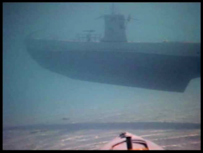

    I tested that out in
    I tested that out in my sink Thursday before I went to the SR6 fun run last weekend. I found that with a 1"x1"x1/4" chunk of flotation foam rubber banded to the top the camera was "perfectly" neutral.
    Here is a shorter (but higher rez than what I posted in the SR6 forum) video clip of last Saturday's festivites.
    CLICK IMAGE TO PLAY -
    • Larry Kuntz
      • 536
      And yet another great video
      And yet another great video Tim. With the mikes turned on it definitely shows how non-stealthy our subs are, but the audio makes it.
      • pirate
        • 849
        Fantastic video Tim. I love
        Fantastic video Tim. I love how you got the tip of your sub in there. It gives a great perspective and frame of reference, and probably kept me from getting sick. Very nice. Great job!
        And great job at the helm. It looks like you're manuevering a little research submersible the way you positioned it there behind Jeff Jones' Type VII.
        And the Type VII really looks good Jeff. Particularly hovering perfectly still and trim off the bottom there. But I've always thought all your boats look terrific.
        Wish I could have been there. Missed seeing you guys. Next time.
        Pete
        • tsenecal
          Pirate,
          I don't want to start
          Pirate,
          I don't want to start anything here, but I am pretty sure it is a type II, and it is sitting on the bottom...
          What impresses me the most of course is the fact that this still taken from the video is high enough quality to even make that judgement.
          Tim
          • tmsmalley
            • 2376
            Jeff Jones' subs really run
            Jeff Jones' subs really run well. Even though he typically uses the "old fashioned" bulkhead system instead of watertight cylinders, they always are in perfect trim on the surface and underwater even when he is just hovering. I am totally jealous...

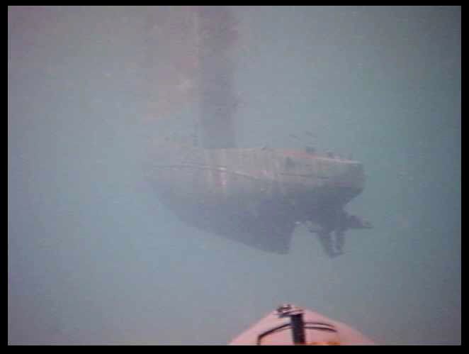

                    I'll tell ya...........I really love
                    I'll tell ya...........I really love this camera!!!!
                    Today, our Hubertus MBC lake was quite a bit clearer and I had a bit of fun with some of the other boats sailing around. One however (as you'll see shortly) got a bit too close.
                    Dave
                    • bcliffe
                      • 337
                      Dave,
                      I think there may be
                      Dave,
                      I think there may be 2 blades on that screw. Can't be quite sure though.
                      Awsome deck placement of the camera ... it gives you a really good look and feel of your boat. Well done.
